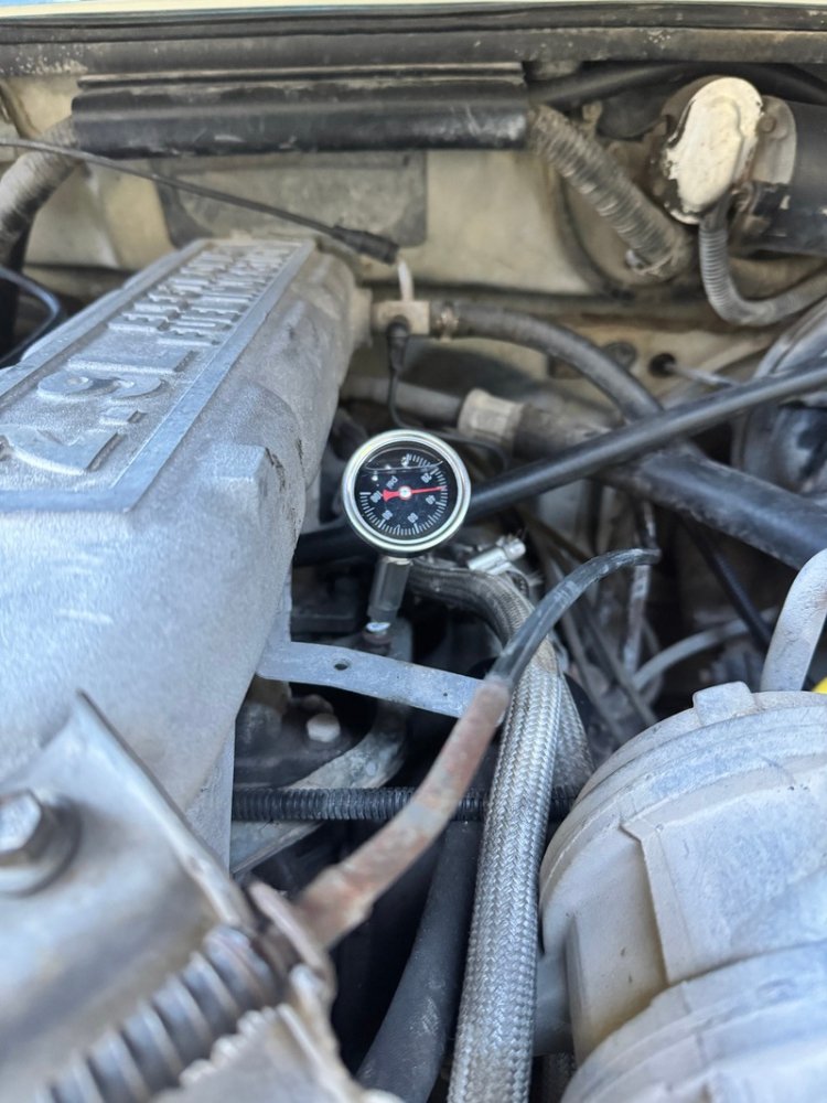

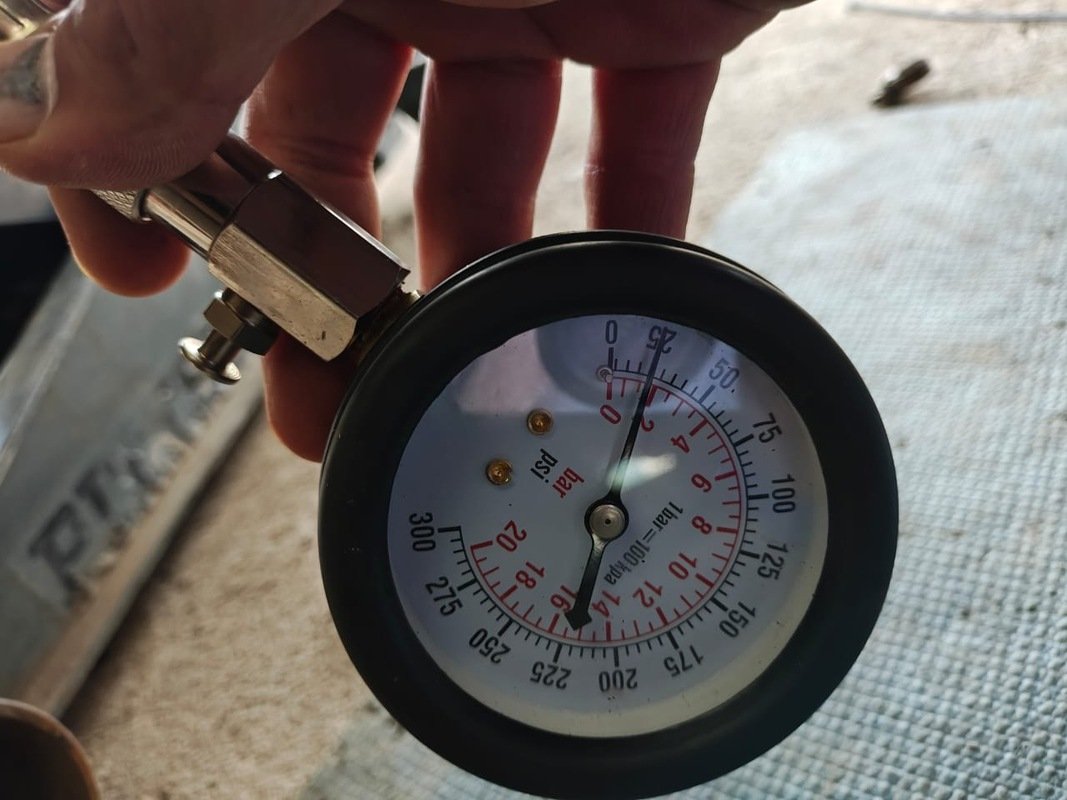

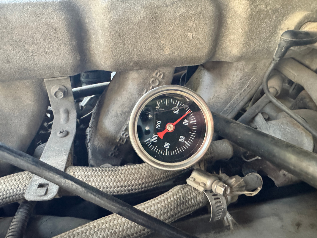

Tested the fuel pressure today.
Steady at 30lbs, increasing to 40lbs when I rev up the motor.

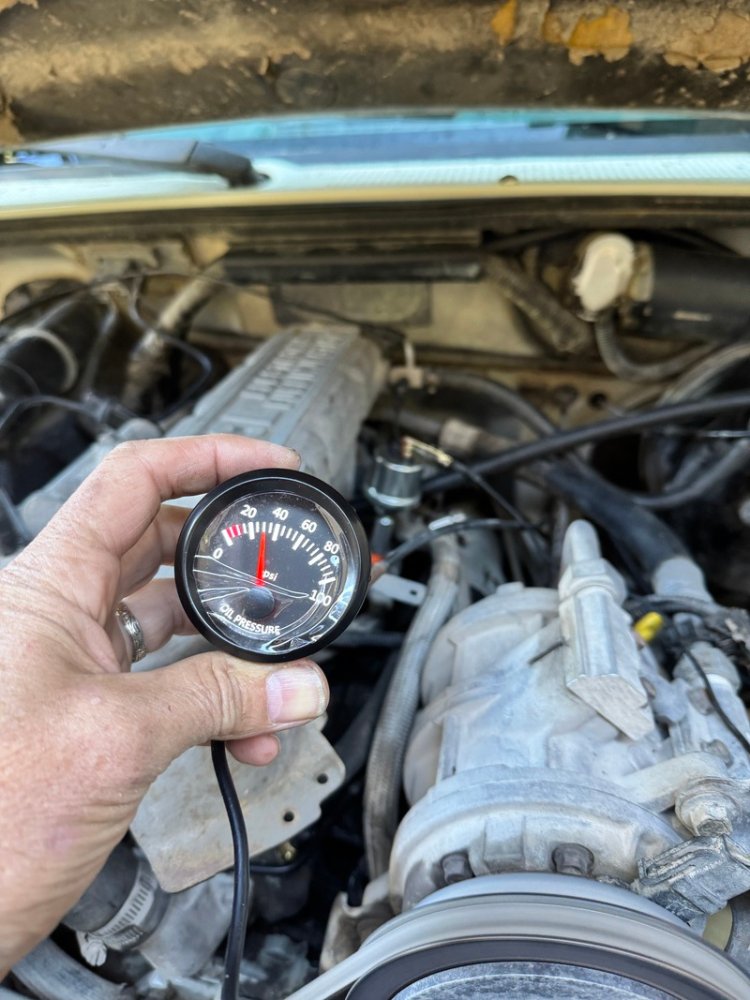

Also tested an oil-pressure gauge, as a fuel gauge...it works :)
After shutting off the engine, fuel pressure drops to ZERO after a few hours.
Oil sending unit started to leak.
Guess it isn't rated for fuel, or because it's from china.
Back to the analog it is :cool:

Pressure at tank was 60lbs, 35lbs at the fuel rail.
Lazy starts have been addressed.
