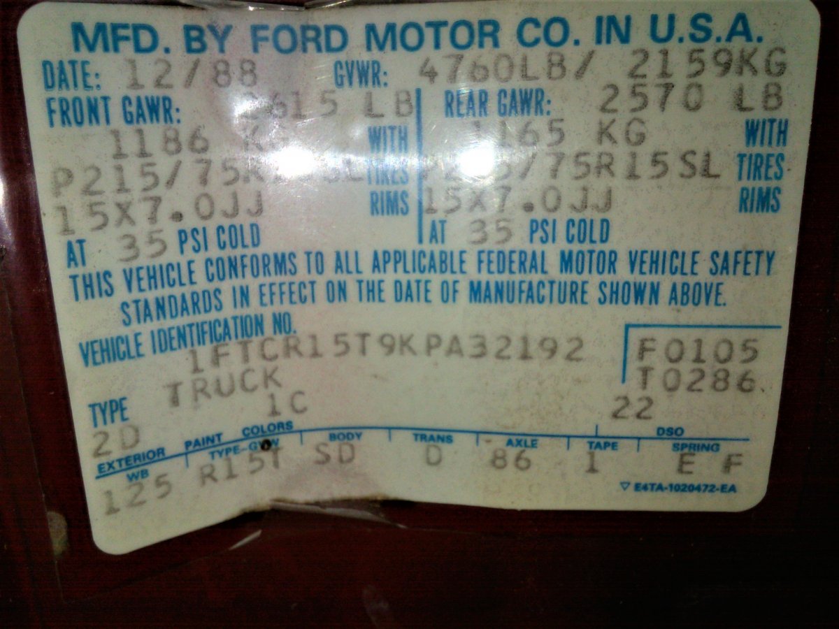

AXLE CODE 86 from Door Sticker - SPRING CODE E F - 15 inch wheels - I'm sure there's a Code breakdown somewhere here on this GREAT Board - 2.9 Cologne V6 - 5 Speed - I'm a LONGtime Ford & Lincoln guy, have 5 on the road & a couple "projects" - Body was straight & a relatively rust free NC Truck, recent Clutch & full Brake system - 95K miles but surely rolled over - Price was right & it looked so sad I just could'nt just leave it sitting there...

Welcome to TRS :)
Good page to Bookmark here: https://www.therangerstation.com/tech_library/index.shtml
In axle section are the codes, seen here: https://www.therangerstation.com/tech_library/axle_codes.shtml
86 is a 7.5" OPEN, with 3.73 ratio
You have to match ratio to front axle, on 4x4s
7.5" and 8.8" Ranger axles are interchangeable so you can use either, same drive shaft flange
Also the frames and mounting are the same from 1983 to 2011, but...........
In 1993 and up Rangers were 2" wider, so axles were 2" wider, same frame and mounts just wider body
So on your 1989, a 1993 and up rear axle would have the rear tires 1" farther out on each side
A limited slip(L/S) rear axle would a nice upgrade, 3.73 ratio of course, and it was the most common ratio on Rangers
7.5" or 8.8" doesn't matter
