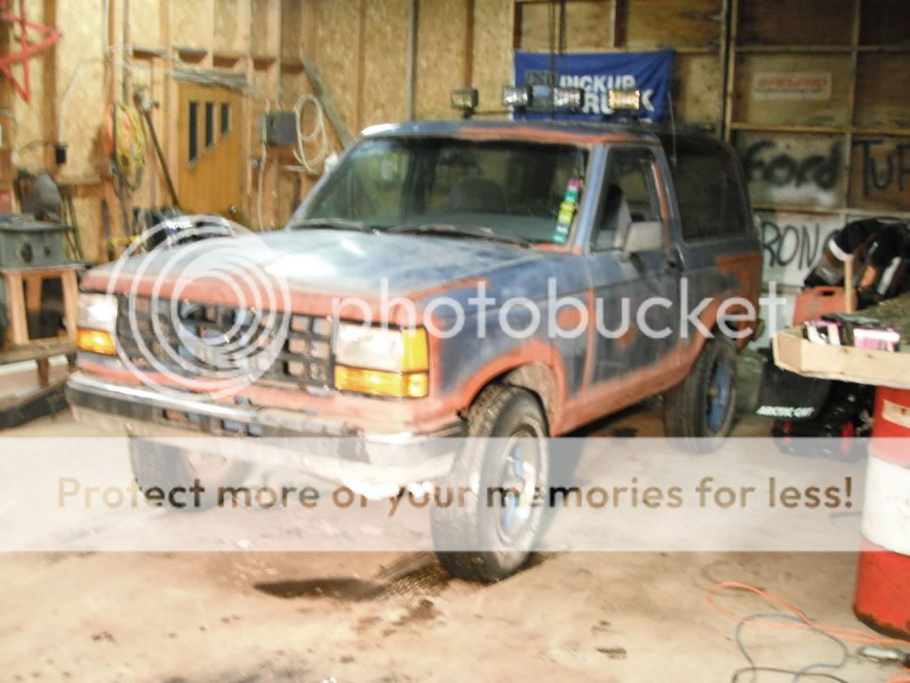

1989 FX4 BII, resto-mod project
put on the light bar that was on my 79 and on my old b2, and took off the grill cover, will prob leave it off.

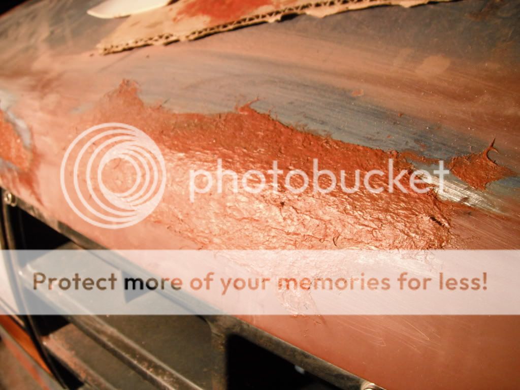

today i noticed there was a rough spot on the edge of the hood that i only noticed because the trouble light was lodged down right next to it. so i figured it might be more visible when its painted so i whipped out some bondo that i bought for the 79.

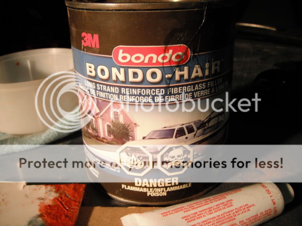

its basicly just fiberglass. its kind of a bitch to work with too.
its green in the can, when you mix it with the cream hardener it turns red and looks like this after you **** around trying to get it all applied properly.

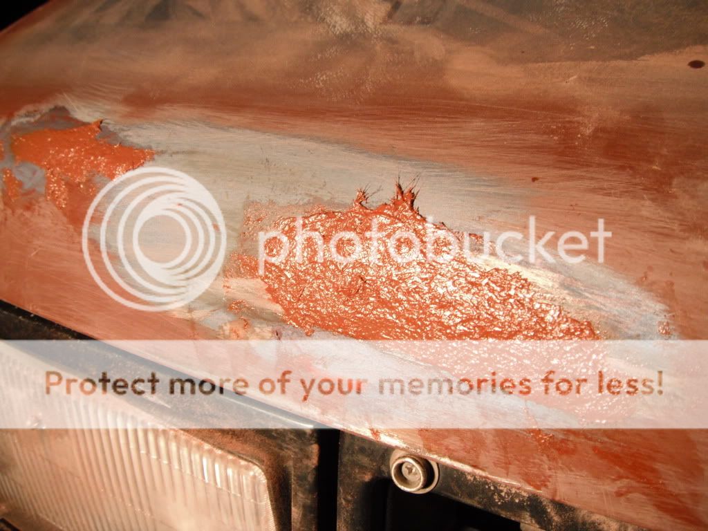

then after it drys it looks more like this
i never got around to sanding it yet

just be patient on the body work and take your time (something i hate doing). flat board it out till it is perfect or it will show. if necissary reapply and resand.use a flat board and long sand paper to help keep everything at the same level
Looks good, Jeff! Just a little FYI... find some polyester filler and some finishing glaze. That short strand, while awesome to fill relatively deep imperfections, will leave pin holes and it is a real pain to sand, especially if left untouched for a few hours. For minor imperfections like what you had there, regular polyester filler is perfect, then go over with finishing glaze, just a skim coat to fill any little pinholes or relatively un-noticeable scratches, but that stuff will show up in paint. Trust me!
*edit* Just saw it's long strand. Wowee! Get some regular polyester filler, you'll be much more satisfied with the results. :icon_thumby:
well this is the only stuff i had at the time. as soon as it started to try i knew i would be taking it off again. like you said its a bit too industrial, just a bid of bondo filler would of been good. there wasnt any holes just a couple rough spots that were barely noticeable. oh well ill just sand it off and get the good stuff soon!
