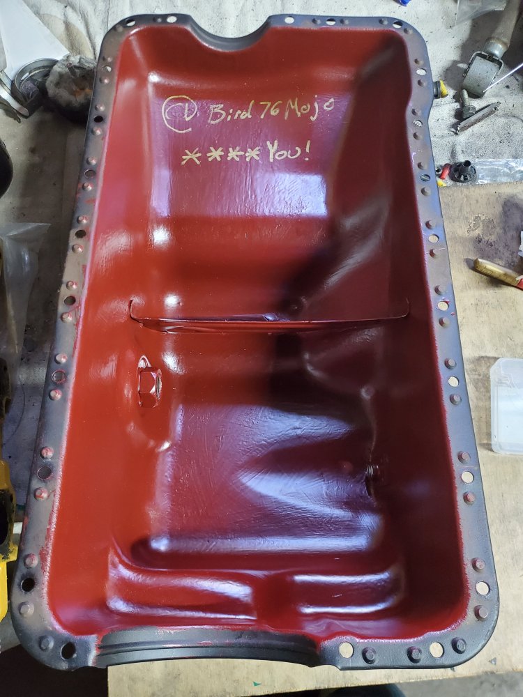

If I was less practical and had a couple more loose bolts in my cranium I'd follow in your footsteps... This thread is a gold mine and you sir are the miner. Have the top end of my 2.9 pulled off because I blew the head gaskets and I'm waiting for the heads to get done at the machine shop... My upper intake manifold keeps whispering in my ear about how it wishes it and the lower manifold could flow better :shok:
Definitely added 30 horsetorques with that mod... Don't wanna high-jack your thread, but do you or anyone else have experience with Promaxx Performance heads? Have to buy two new 2.9 heads and I'm torn between them and King. Both companies have new heads with an "improved design." The Promaxx's are cheaper but I can't find much info online about them. Under the "about us" section on their site it says they started up in 2012. I know World Products used to be a common upgrade but they don't make 2.9 heads anymore. From what I've read King has a good reputation. I'm buying assembled heads, so I'm not just worried about the casting quality, but the quality of the moving stuff too. Thanks in advance y'all.
