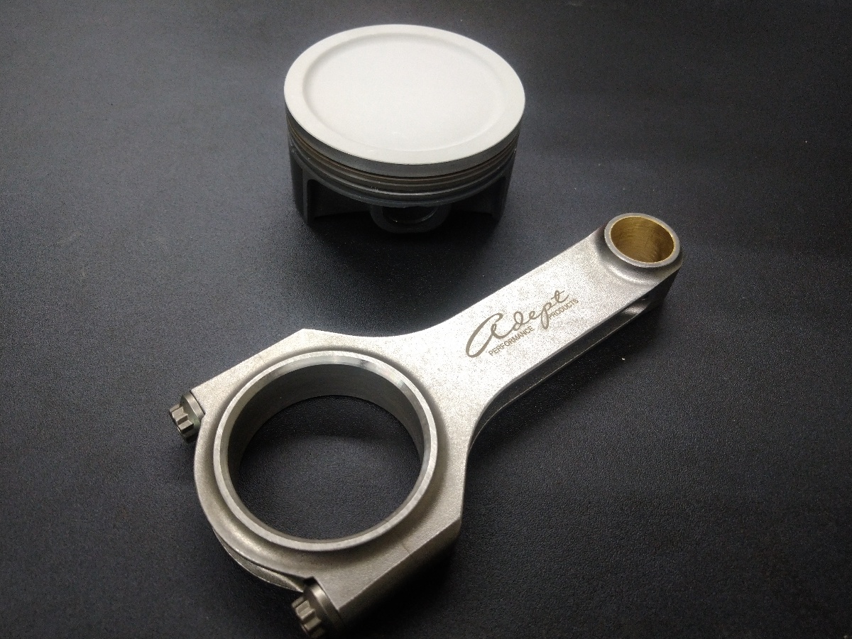

Rods are in.
4340 steel with ARP bolts.
Next step is machining everything together...
Very nice. You should cut a window in the side of the block so you can look at them occasionally.
Ha nice... I replied to his text with “those are too nice to hide inside a Cologne block.”
If it goes like I think it might, the window may not be optional.:ROFLMAO:
