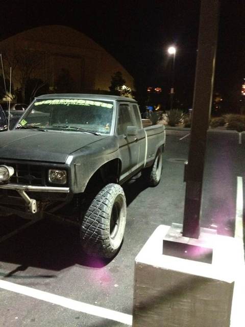

Another small update let my grandfather drive the ranger the other day and he ended up blowing the 2.9. So on to bigger and better things. 1996 ohv 4.0 from a exploder.
1988 ranger prerunner build
I haven't been doing to much go the truck lately. I've had a lot going on moving into my new house and the biggest update.
Well I got the 4.0 in and running a few hours later the old tired 7.5 let go so its on too a exploder 8.8 4.11s with an LSD. It's all swapped over just waiting on the drive line.

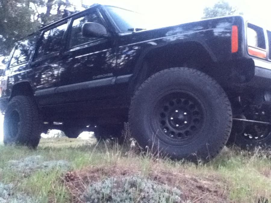

That is one good looking truck...We almost have the same wheels :D
  • 1988 ranger prerunner build
Thank you nice jeep sometimes I wish I had 4x4. That we do mine are eagle alloy 101s. I need another one just haven't had the money to buy one. Does anyone have any ideas for a new color I want to paint it again its already pretty tore up.
