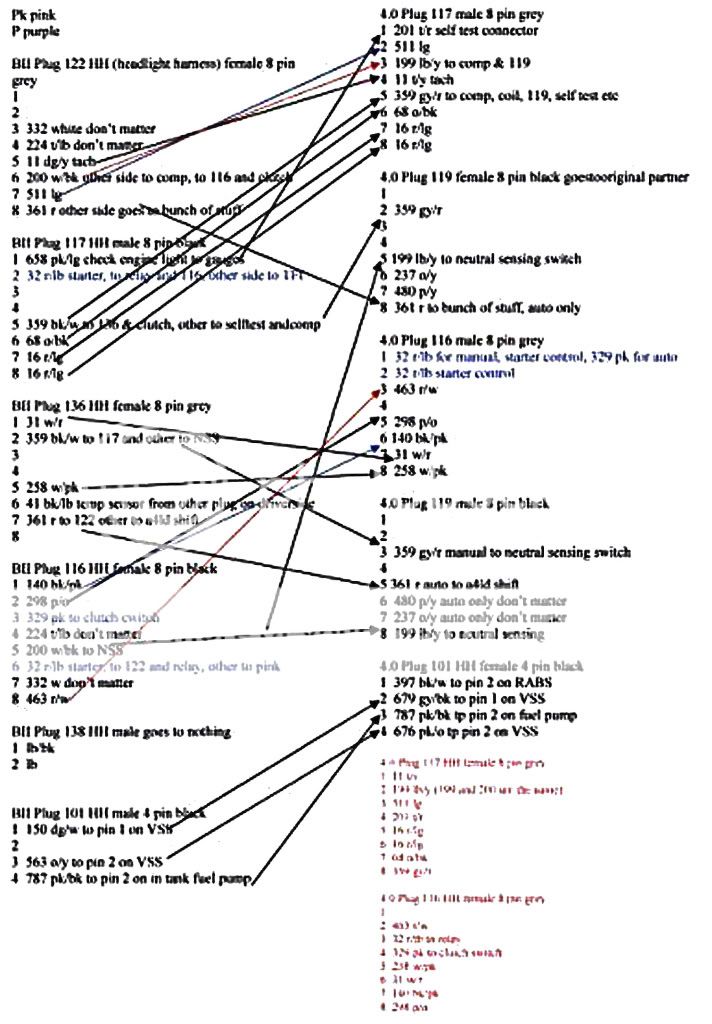

Now you should have a big mess of connectors from your original setup on the driver side firewall and a mess of connectors for the 4.0 wiring harness. None of these are direct plug and play from the '88 2.9 to '92 4.0. Sorry! This is where the majority of the 4.0 swap write-ups have failed at least for these years. Yes, you can figure it out by staring at both wiring diagrams but it can be difficult. Here's what I did to make the bitch run.

You now need to ground the GRY/YEL wire in the 2 PIN black plug on the end for your 4.0 harness. Now when you turn your ignition on you should hear the relays click on and the fuel pump turn on. Fire that bitch up! There are numerous other wires that need to be attached but this is all you'll need to get going.
Also to get the alternator charging with the 4.0 harness you need to run the LT GRN/RED over to the firewall harness LT GRN/RED. I'll make a thought out post with ALL the wiring colors and splices needed for this swap at a later date.. Also keep in mind that the engine temp sensor and tachometer will not work correctly. I used the oil and temp sensors out of the 2.9 and have yet to find a fix for the tach which reads too high. A tach for DIS is around $66 but I'll try resistors first just to see if it's possible.
Look at the conversion chart on my Photobucket to make the remaining connections.

Here's a chart someone did for their BII 4.0l swap. It helped me with the Ranger swap as well as it's very similar.
