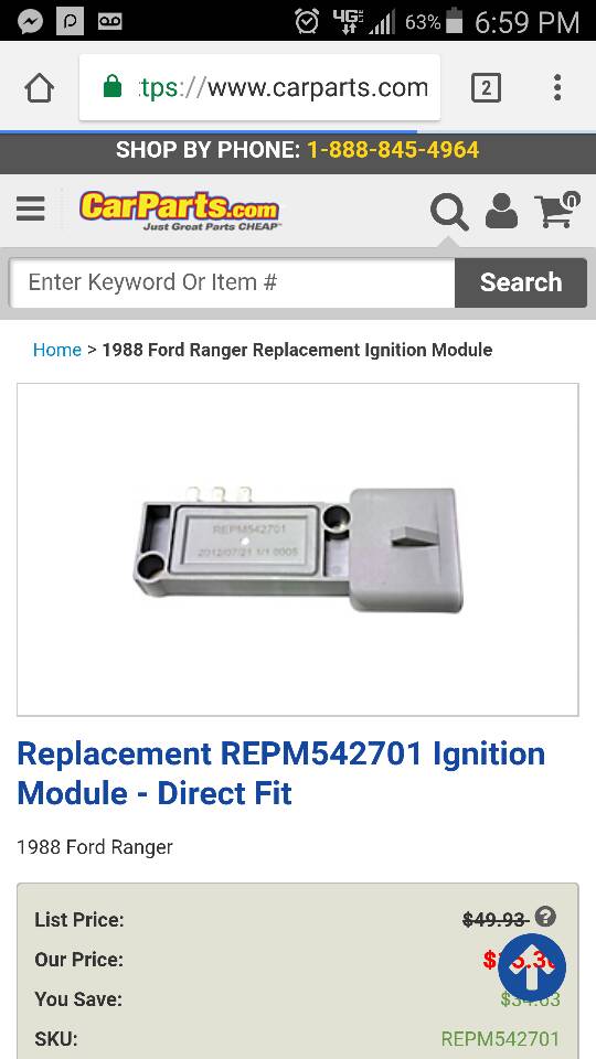

This is what I bought, not this exact one, but I got it from Napa and it looks just like this. Is this the right part? I also picked up an ignition switch because incase this doesn't work. I get off work around 11pm and will be back out in the shop with updates for everyone.

Yup, that piece of shit looks just like the OE piece of shit.
FWIW I don't think very highly of the TFI systems. Actually, the system itself is great. It's the placement of the heat-sensitive module that was shit.
