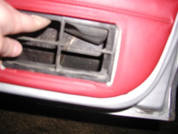

live in omaha, ne. there's a pocket of some sort, took it apart the other day, thinking it's for a vent though... it's got like rubber flaps on the inside, my heating system sucks in that truck anyway, maybe i should get rid of it lol....

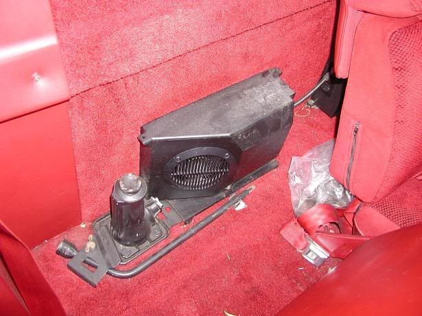

for example your back speakers, if there 4inch and the plastic has a 4 inch circle of plactic strips for the sound to get out. iffffff you can take the plastic off and see if you can expand the hole in the metal enuff to put a 5 1/4, 5x8, 6x9 in there and it will look all the same, when you put the plastic back on. if you need to and can/want to, you can cut a hole in the plastic too and mount the aftermarket speaker cover over the hole it will give you a clean look and you really havent lost any space back there,
had a buddy do the same thing but in a differnt way
installed the speakers (6x9) cut out a 7x8 hole the the plastic and cleaned up the edge really well to were it was perfectly smooth again. and cut the flat part of the aftermarket speaker grill out and mounted in on the back side of the hole. so when it was all back together, it went from new hole to black grill with a nice seam... look nice

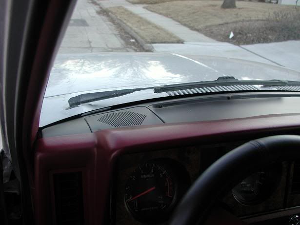

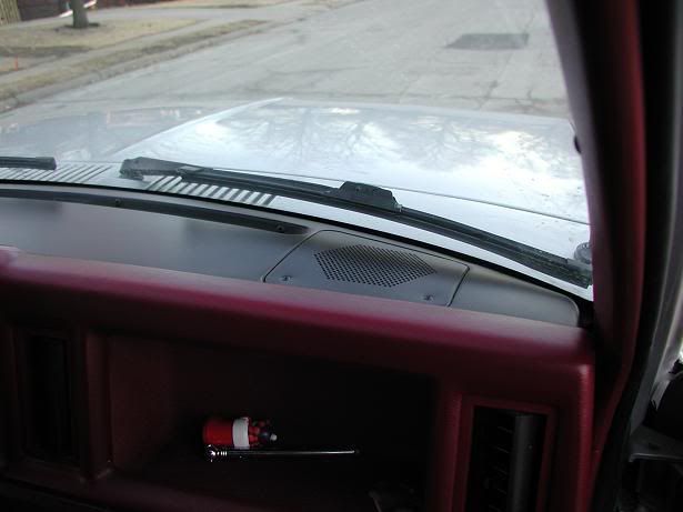

can you take some pics of the factory speaker locations in your rig, I'm not too familair with 88 rangers
i used car domain to look up and 88 xlt the doors should be just fine for putting in speakers so you dont have to use the 4 inchers in the front.

different views... don't mind the dust lol... i need to detail the inside one of these warmer days
door panels are solid besides the ?vent? can anybody confirm or deny that it's a vent?? not sure how a vent would work in a door, how would it be connected? anyway...

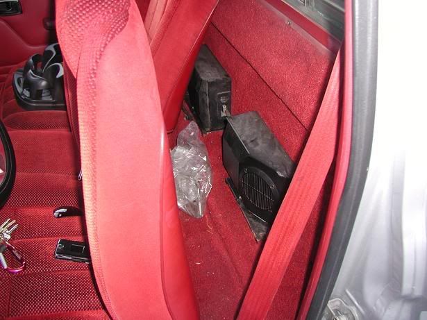

i the first thought that popped in my head. would be get rid of all that behind your seats. and get one 10'' and two 6x9's and make a three chambered box back there 10;; in the middle 6x9 on eather side. maybe just a lack of sleep idea.
like a really long power wedge will fit nice back there

i would ditch those rear speakers and enclosures. either replace them with a pair of 6x9 in some enclosures. then run those off the deck. or add a 8 or 10 inch sub. can you post a picture of what the doors look like with and without the panels on? maybe they can be modified to accept a speaker.

well I wish I would have seen this earlier I have my door panels off of my 87. but yes that is just a vent it is so when you shut the door you dont blow out the seals around the windows, ya you can stop laughing I don't think my 87 was ever that tight but maybe when it was brand new. and I know that there is no spot in my doors for speakers yet, (not saying yours doesn't) but since I changed my dash to a genV dash I need to find a way to mount door speakers. My plan is to enclose the the sheet metal in the with a removable sheet incase I ever have to change a window. I will then take a speaker ring that will fit my speaker like this

as far as getting to the front speaker i would say it just taking out the two front screws.
but as far as the back idk if it was good or bad just really different.
but my three speaker idea sound good still with 4 hours of sleep. it will work and be different. and kinda makes life easer. if you build a wedge box lest say 3 feet long you can have the sub in the middle chamber and the 6x9 right nex to it in there own chambers not that they really need it but it will look clean, and kinda cool in my two cents and its alot less fabing. and it you dont have the room to lay them out flat you can put the speakers on the side then you only have to cover the depth of the speaker.
