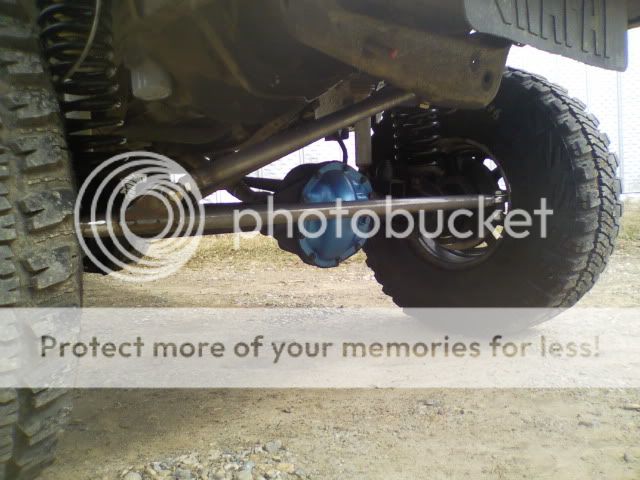

here's my steering setup idea, this is plumcrazy's truck
any reason of welding the drag link to the tie rod instead of taking it over to the knuckle like currie or rusty does?
the only reason i can figure is that it keeps the DL and the track bar closer to the same length
There's gotta be a reason of each method. Just curious as to why you chose that method
i chose it for a few reasons. i think it'll be a little stronger. it lets me put the tie rod on top of the knuckle. and like i said, it should make the track bar and DL closer to the same length/angle. but what do i know, this is my first SAS lol we'll see what happens as i go.

looks like the DL and TB should match up pretty close

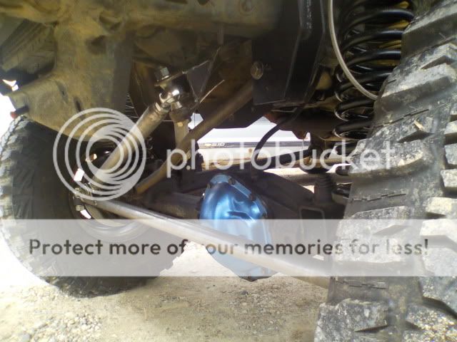

worked til late again tonight, so the pics are dark, but you can kinda get the idea
i rebuilt the axle mount for the track bar, the new energy susp. bushing wouldnt fit in the 2x2 tube.
then cut down the TB so it was easier to work with. still need to trim an inch or two off. i'm gonna have issues with the cross member, so i'll either need to move the TB frame mount or cut up the cross member. you can sorta tell in the pics, but they're dark.
the steering angles also look like they're gonna match up pretty close though, so that's good. my heims should be here tomorrow or friday, so i'll be able to figure out more this weekend when i set up the steering links
