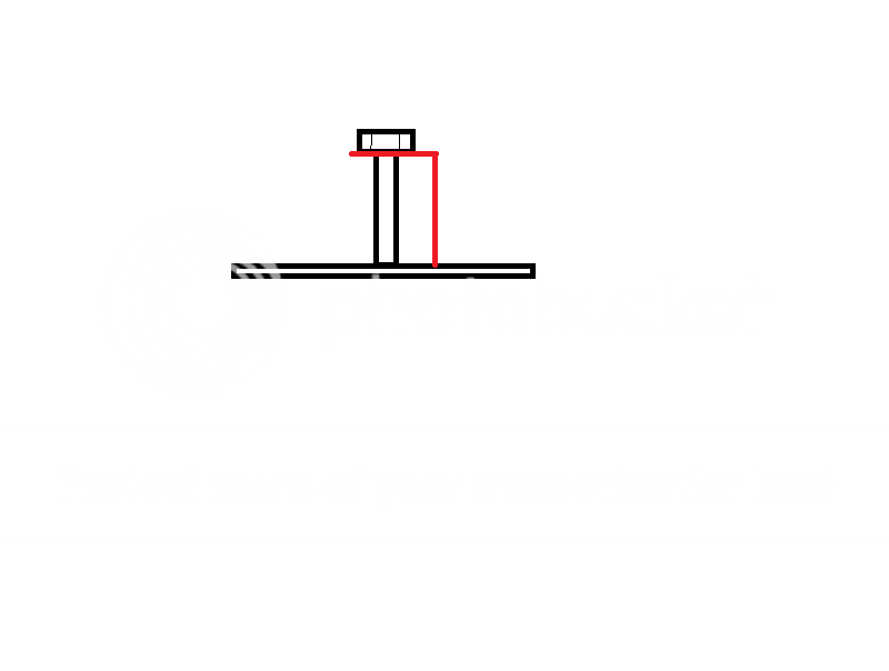

what about mounting it in double shear? know what i mean so itd be like |] not the best pic but im on my phone the | being the bolt

is it dropping in the bushing or is the whole bolt moving? thats what i mean about the double shear put a plate by the head of the bolt and then back down to the bumper thatll stop it from pulling on the bolt
still not 100% sure what you mean by double shear

like that. but you would have to shorten up the tubing on the other side of the pivot so it swings inside the brace without hitting it
ok i see, i thought that's what you were saying
it'll cost $5 and an hour of time to see if sleeving it helps, if not, i'll do something like that. i should've waited to plate the back side where i cut the angles.
