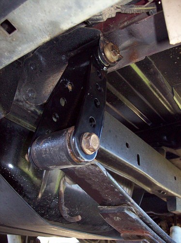

Your shackles are backward.
yeah i wasnt sure how they mounted, so i consulted the write up in the tech library before i installed them and it said they could go either way. so i just put them in like the factory ones were.
here's what the tech library says
6. Now install the new BellTech 6400 shackle in place of the stock shackle. Install in reverse order of removing the stock shackle. You can install the shackle backing plate in either direction. The stock shackle has the back plate towards the front of the truck. Make sure to use red thread locker on the nuts of the spring and shackle bolts.
if it looks like it's limiting wheel travel i'll reverse them, but i dont see it being a problem
