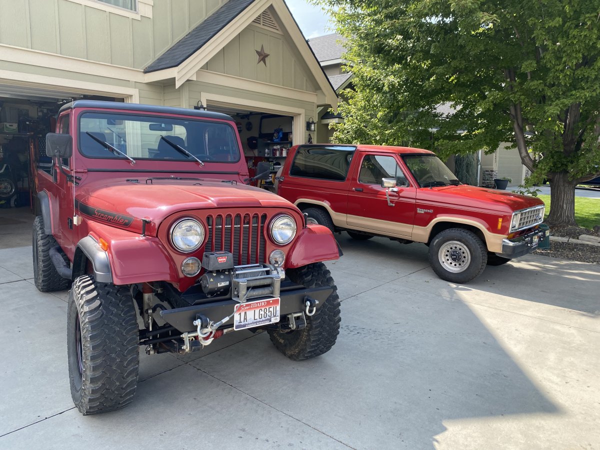

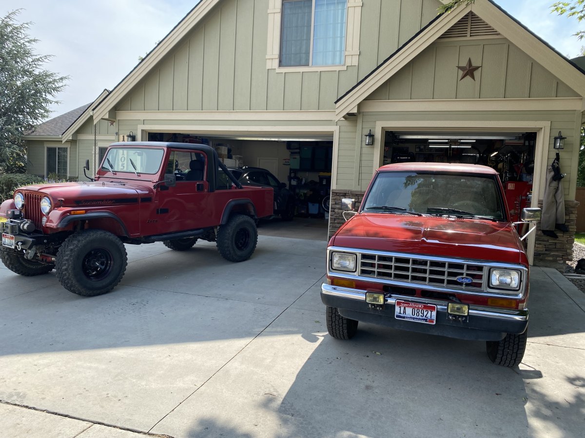

That is a nice looking B2.
Nice vehicles, is the Jeep a 1/2 hard top with a solid back behind the front seats and turned into a mini-truck/half-cab ?
It's a CJ-8 Scrambler. Has a longer wheelbase than the CJ-7. Was built w/ option for the 1/2 hard top or half soft-top. There is a removable lower bulkhead below the rear of the top. Manufacturers later came out w/ full hard tops and full soft-tops. CJ-8 were only available from 1981 to 1986 (end of the CJ era). Fairly rare and more valuable than a CJ-7 or CJ-5 however there were only available with an inline 6 or iron duke 4. No 8 cylinders however a lot of guys swap them in.
I was selling cars at dealerships in the 1980s/1990s and it seemed like you couldn't give them away. When I was a parts man/driver and service manager at the AMC/Renault/Jeep dealer, I do not remember seeing one in for service or ordering parts for one, so, they were are pretty rare even back then. I would have liked trying one out as a snow plow for small driveways.
Learned something new today, thanks :)
