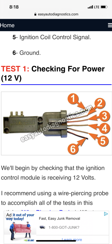

I did some tests at the ICM plug on the backside of the distributor, i probed the #4 wire with my ignition on to test the positive lead. I’m getting 12V. So then I did the same test at the #6 wire which is ground. Probed the wire with ignition on and I’m reading 4.09V. I tore the whole harness apart and found that the wire runs inside of what I think is some sort of insulated tin foil? With 3 other wires from the icm, which are also wrapped in a bare wire. I followed the insulated line all the way back to inside the cab next to my ECM. The ground wire and that bare wire both end up in the cab by the ECM. The bare wire ties into the ring terminal with the ground cable. I cleaned up where It grounds out inside the cab. And probed the wire closer to the battery near my eec relay. And I’m still reading 4.09V

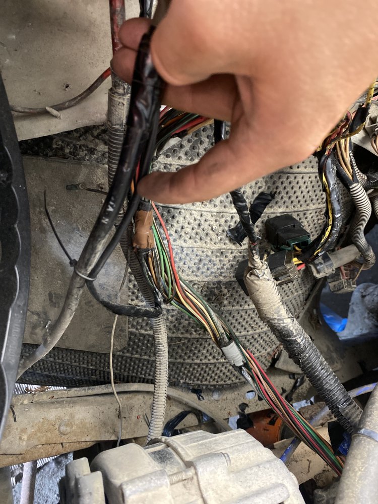

I’m going to attach a photo of the ground I think you might be talking about. Don’t mind the rats nest of wires right now lol. I have my ground wires on my battery running to a shut off switch cause my keys are stuck in the ignition (my back yard immobilizer) I did have to splice that wire and connect it to the my shut off. Would that identically cause a bad ground reading to the wire that runs directly to the ICM plug?
My index finger is on the wire I believe you are talking about. I was just about to try testing the ground spot itself That the wire from ICM is running to beside my computer right now and see if I’m still getting the same 4.09V reading

Okay, so this is a little bizarre… I checked probed the wire just down from where it connects for the ground inside the cab. I was reading 12V I came outside the cab, probed, was reading 12V disconnected the ICM plug from the ICM, checked at that point. Got between 3.95-4.10V.. plugged it back in and I was reading 12V at the plug.. still crank no start no spark.. I don’t understand why, when the plug is off, that it’s not reading the 12V..

Toskin, I had a similar problem with my electrical... As Franklin2 mentioned in his excellent reply on grounding connections and the foil wrap, there is a single small gauge wire connected at the negative battery terminal. This single wire has another connector before it disappears into the harness and that is responsible for a number of other grounds (up to 4 or 5 according to an electrical schematic I have for the Ranger). That small connector at the battery terminal was bad and when I replaced it with a good connector, that solved my problem.
