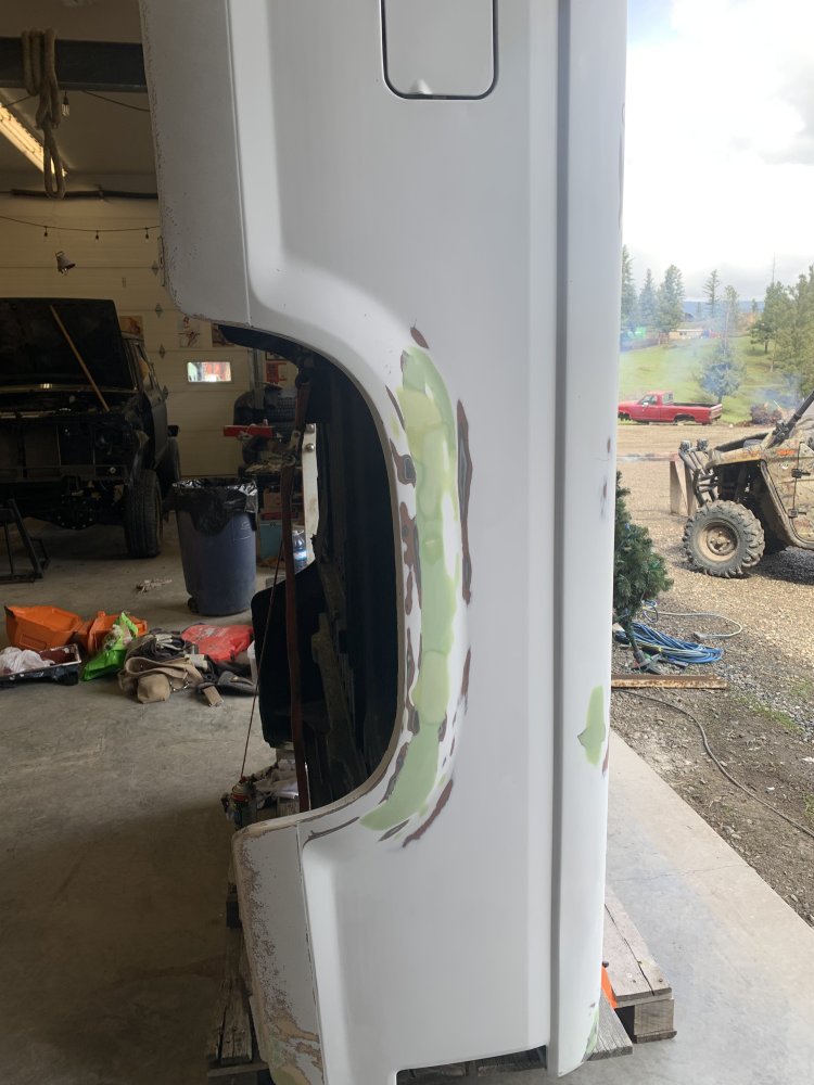

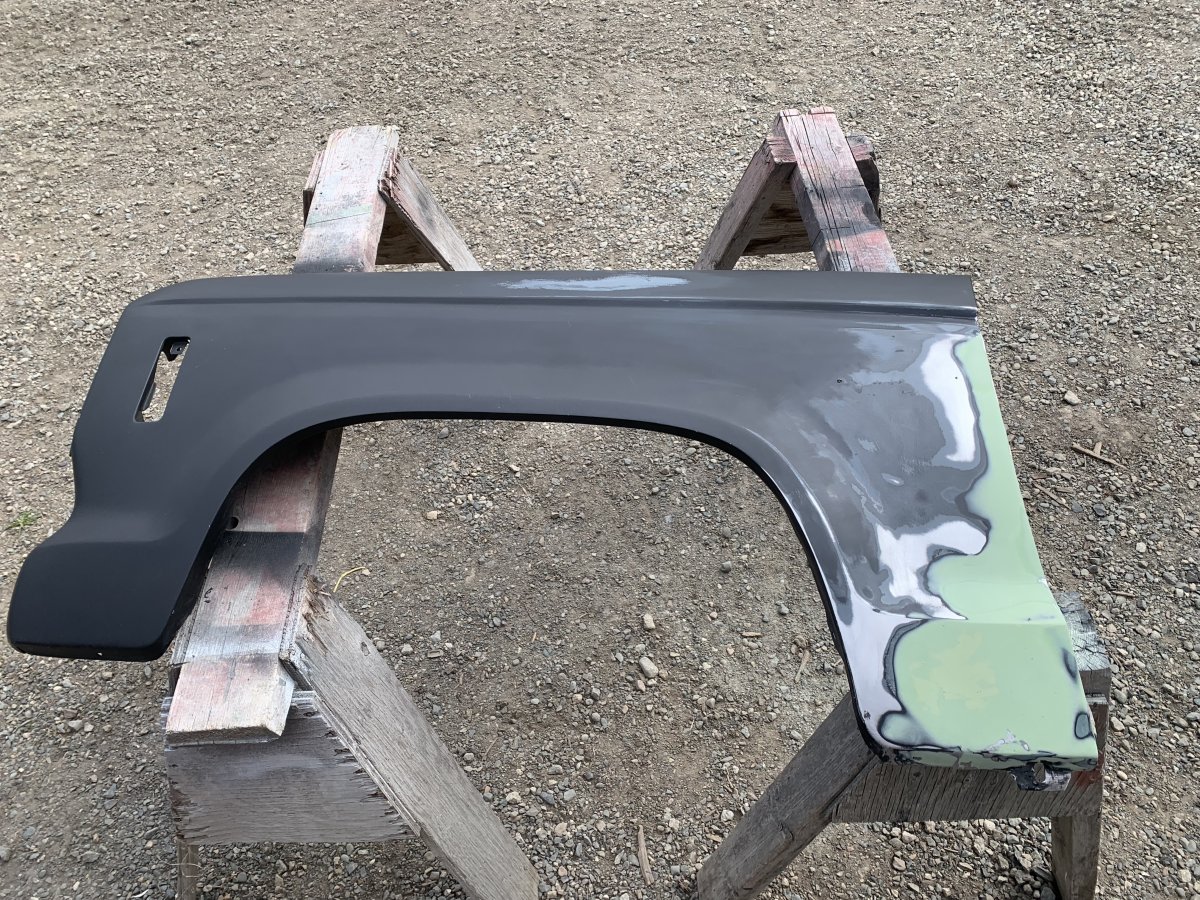

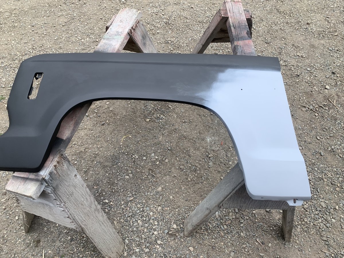

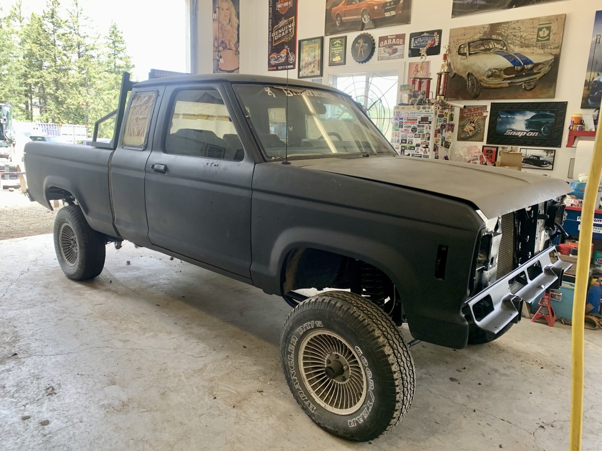

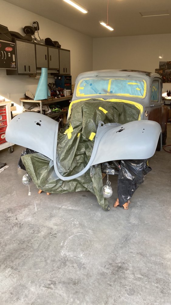

Front fender is done. Had to redo the welded patch I originally did and added some thin rod and weld to the edge to help with the gap issue. I’m still a bit of a student/weekend warrior at this bodywork stuff but it’s fun, even with the mess and dust everywhere. Added some high build primer to smooth out some sanding scratches I made getting a little impatient with the 80 grit. Just wouldn’t come out with the 220 good enough.
This is the third time I’ve added filler and sanded it almost completely off. This fender has fought me the entire time the sumbich. 😂
Anyways, it’s all one color again and it finally fits with some shimming. Gonna hang it tomorrow.

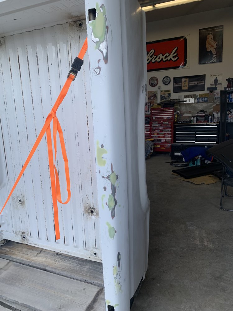

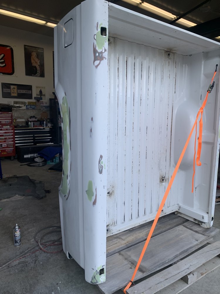

Got the box blocked today too. Hope to get it in primer tomorrow and set it on the truck.

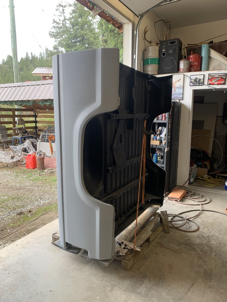

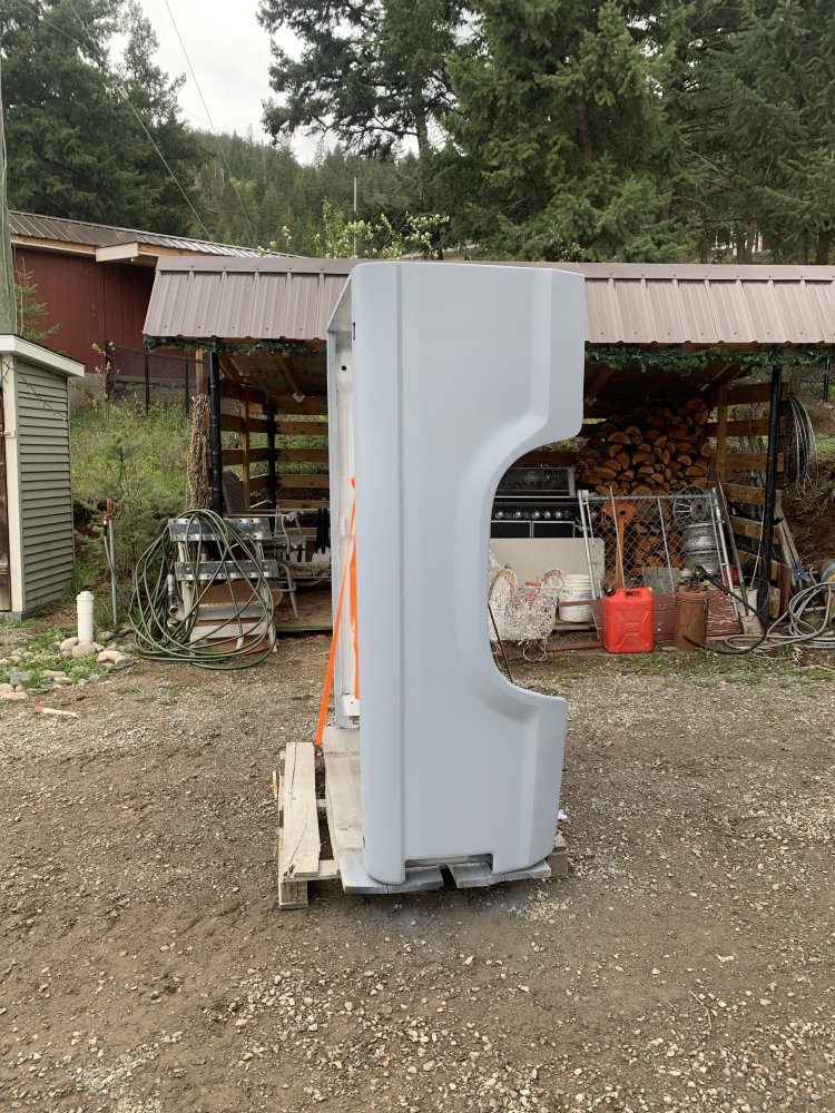

Got the box blocked and primed with some high build. Then I got distracted working on my faux gas station. Had to switch it up a bit from all the dust. 😝

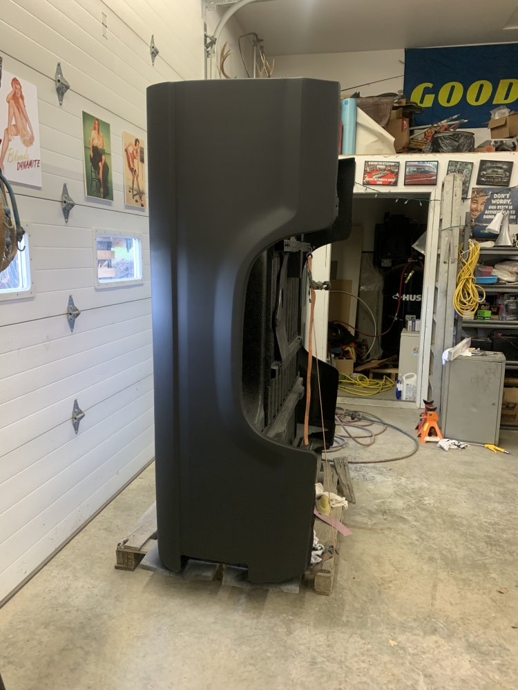

Man, even with starting with such a clean box it was still quite a bit of work with all the real estate there. I’m glad it’s finally in one color and ready to drop on the truck for stripe layout. So glad I found this box though, because if you look back at the original box,… well let’s just say I see why dudes just make flatdecks. 😂. Inching along. Progress on the faux gas station too.

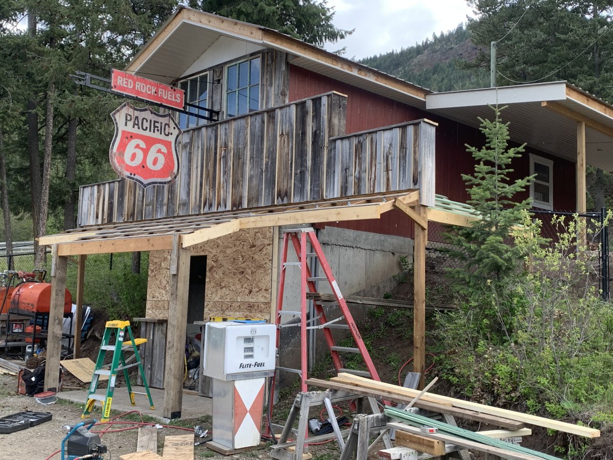

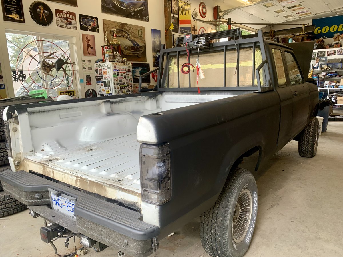

Ok, been hammering away at the gas station project so not much done on the Ranger lately. I did set the box on the truck today just to see how it looks. Still need to prime and paint the ends and cut the hole for the fuel pump access door. Mocked up the tail lights and the rack just to get some inspiration. Loving how it’s looking and can’t wait to get this thing In Raptor so I can begin final assembly. This was the kick in the ass I needed to get back on track. 👍🏻

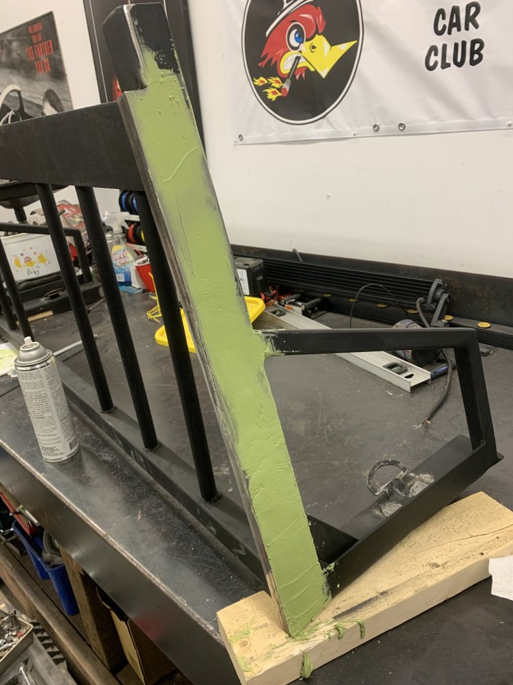

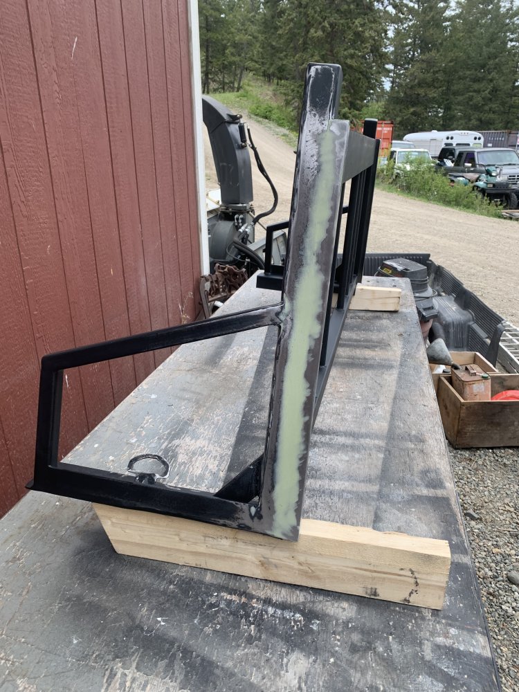

Wife was tired and went to bed super early. Decided to spend a few hours in my shop. Welded some 1/2” angle steel to the front sides of the headache rack so I can hide the winch and light bar wires a little more effectively. Will also protect them if boonie bashing. A skim coat of mud applied for a smooth painted finish, which I’ll block out tomorrow.

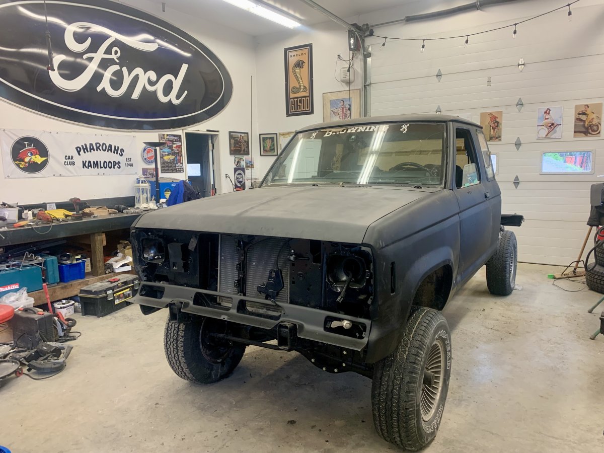

Then I spent another hour easy trying to properly fit and gap this damn driver side fender. Still not perfect but I can see the door needs an adjustment as well. Which may help the overall body lines. That’s a job for tomorrow with some help holding shit however. It’s almost 1am. I’m done for tonight.

Got the fender fitting good with the wife’s help. Still might mess with the door to make it better. Got the rack blocked and in primer ready for paint.
