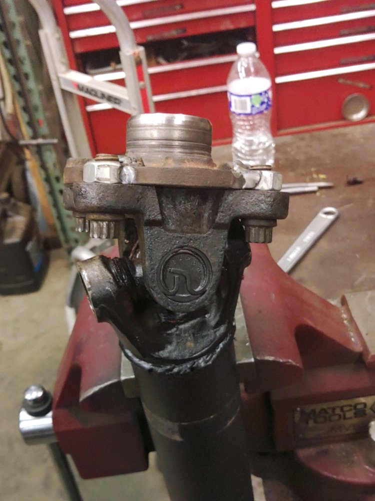

A little insight, I had snapped a Yoke flange when I got the 87 ranger, so I took the flange off the 91 ranger. The 91 ranger driveshaft was larger in diameter so I had adapt the input shaft to fit the Yoke Flange. You can see better what I mean in the photos.

But I still have to mess with the driveshaft either adapt my current one to fit or pull one off a 91 ranger. Can I just cut the 87 driveshaft Slip Yoke Ujoint and weld the 91 Slip Yoke Ujoint, similar to how I did the Yoke flange so my current driveshaft will fit the 91 transmission and the 87 rear diff? Or due to the torque difference should I use a driveshaft off a 91 ranger?
Also does anyone have any thoughts how my input shaft would hold with the added torque. It's held up to 130 ft-lbs the last three months. Should I look into getting an adapted in Input shaft?
Dumb question but why didn't you just take the flange from the '91? The flange on the axles changed in '90 to use 13-10 U joints instead of the smaller one... everything else stayed the same. No matter what axle they had the same axle shafts but the flange was different between 7.5 and 8.8 from the pinion spline difference which I imagine was your reasoning...
The rest is fine, I wouldn't stress whichever input shaft you're worrying about, I'm putting twice the horsepower my M5OD was designed for to it and it's fine...

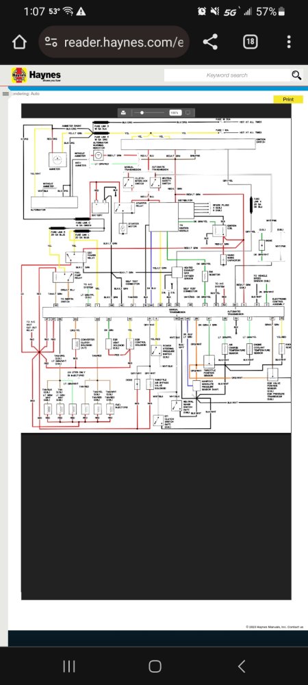

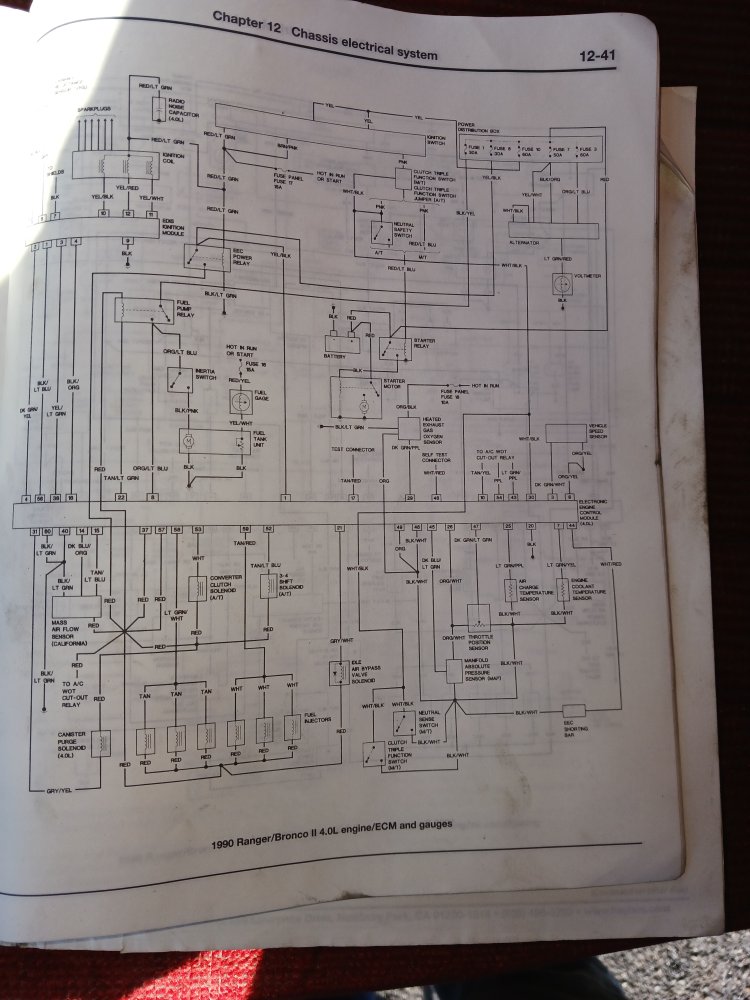

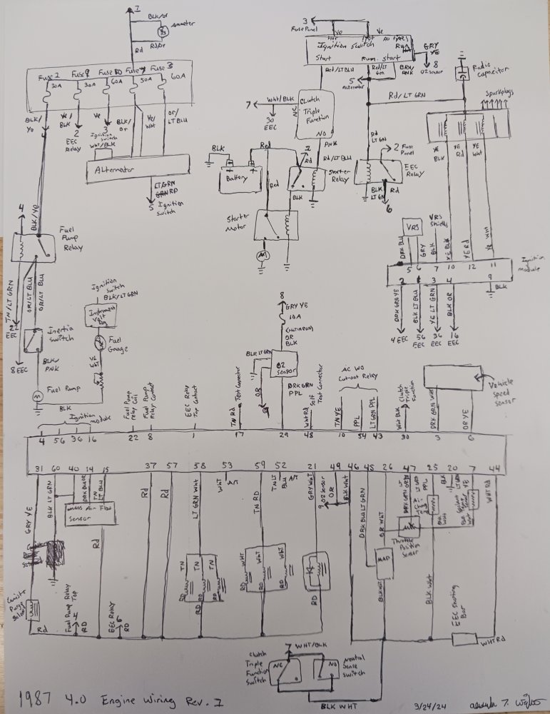

I've reached a point where I've got the 4.0 V6 pulled from the 91. I was sketching up a wiring diagram that converts the 2.3 to the 4.0 based off haynes drawings of the two. I was curious if any of you would give it a look and tell me if there's anything unnecessary or if there's something wrong with it. My 87 ranger with the 2.3 has an ammeter while the 91 ranger with the 4.0 has a voltmeter I believe I figured the wiring out right. It appears the meters are just galvonmeter wired as either voltmeter or ammeter and so I should be fine wiring it the same as it was for the 87. I'll post the drawing in this post. The hand drawn one is my draft for the wiring conversion. The printed picture is the 4.0 v6 wiring from 91 and the web page is the 2.3 l4 from 87.
I would've done that but I had sent my driveshaft to be repaired with the flange off the 91 and they welded it on and threw a ujoint on for it. When I got it back I noticed that it didn't fit the input shaft for the 87 rear diff. So I tried using the other input shaft from the 91 but it didn't match the tooth pattern as the 87 if I recall correctly. So we quickly modified the 87 input shafy so we could get her driving. Sorry bout the late reply been busy with work.
Amp Meter and Volt meter are 2 different things
Volt meter is just hooked up to Key on power in the cluster
Amp Meter needs a Shunt on the alternators B+ wire from alternator to Vehicle
A Shunt is a smaller gauge wire than the B+ wire so has higher resistance
Most of the AMPs travel from alternator to vehicle on the larger wire
A few AMPs will travel thru the Shunt wire, which is hooked to Amp Meter
If hooked up correctly the Amp meter will show a +(charge) with alternator working, with key off alternator off no charge or discharge, if alternator should fail then Amps would flow from battery to alternator on B+ so Amp gauge shows - (Discharge)
Basically it shows the direction the AMPs are flowing on the B+ wire, to the vehicle(charge) or to the alternator(discharge)
The Shunt wire size is important as you do NOT want 50amps flowing thru the firewall to the cluster, it would blow the Amp gauge in any case and not a good idea
Look at the 2.3l alternator wiring harness you will see the Shunt wires on the old B+ wires
Looks like the red and yellow wires on the last diagram are the Shunt

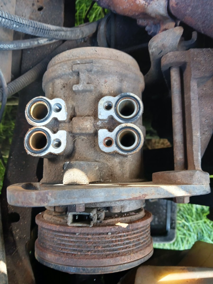

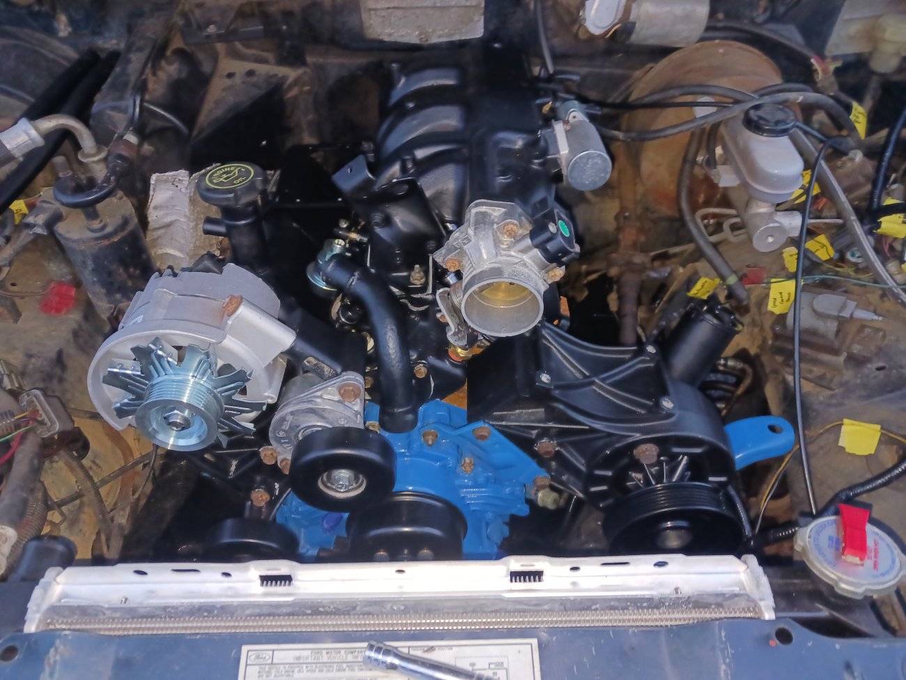

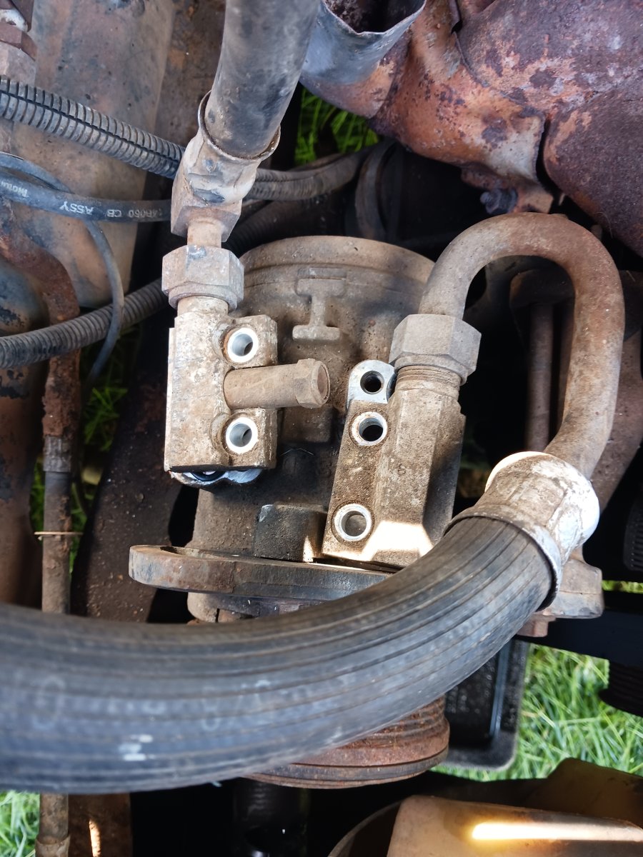

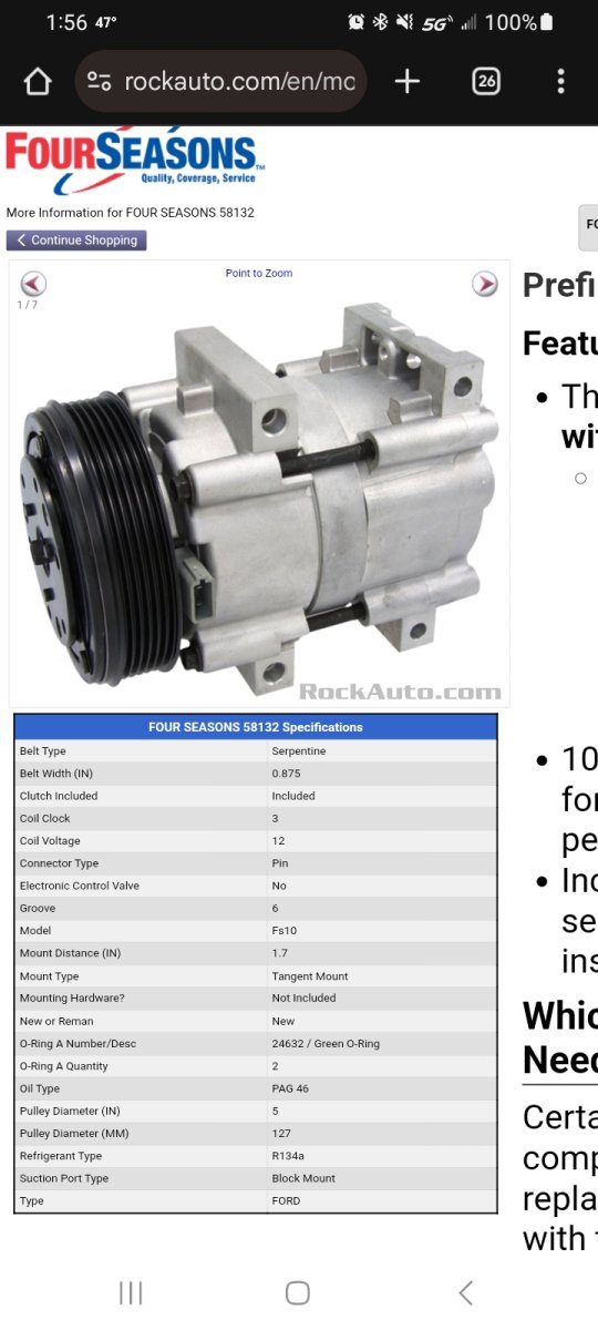

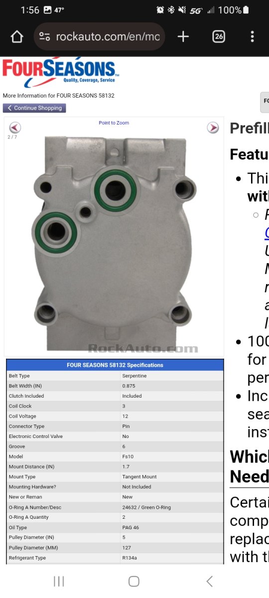

Howdy Its Alex. I've installed the Engine and the transmission in the Truck. I'm still working on installing the Auxiliaries. While Installing some of em I noticed the 91 4.0 v6 didn't have an AC compresor Pump. The 87 Ranger has the factory AC system so I have the AC condesnor, Drier and the blower motor and all that stuff. The pump from the 87 doesn't mount to the 91 4.0 v6 engine.
I was curious if the 91 pump could run the AC system in the 87. If so I'll just get a pump and a serpentine belt that includes AC. I don't know much bout AC systems so any help is appreciated. Thank y'all for your advice and help. Have a great day, God bless y'all.

If your 4.0 engine still has all of the mounting brackets, and it was a factory installed system, your best bet would be order an AC compressor to fit that year and engine.
As far as putting a '91 pump in the '87, you'll need to see if the compressor mounting ears line up with the '87's brackets. Personally, I think it'd be easier to get a V-belt pulley and clutch before changing everything else over to a serpentine belt.
Besides the actual physical mounting of the compressors in both cases, you'll need check that the AC pulley lines up with the engine's other pullies.
And I think that manifold (where the Freon hoses attach) on the compressor changed somewhere within those years, so you'll need to look at that, too.
You've made good progress; thanks for the update.

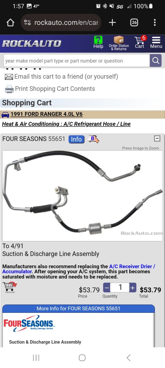

So the 4.0 has mounting spot for an AC compressor. It drives off the drive belt/V belt/Serpentine Belt whatever you call it. The line to the Compressor I think that's the manifold it does change. The first images are the 87 pump. The second images are the 91 pump for the 4.0 it'll bolt up right above the power steering pump and runs off the serpentine/drive belt/ v belt. I'll get new lines for the condenser/drier that'll match the 91 pump as seen in the images.

Stock 91 parts should fit just fine. Since you said you don't know much about AC, how do you plan on handling the refrigerant?
