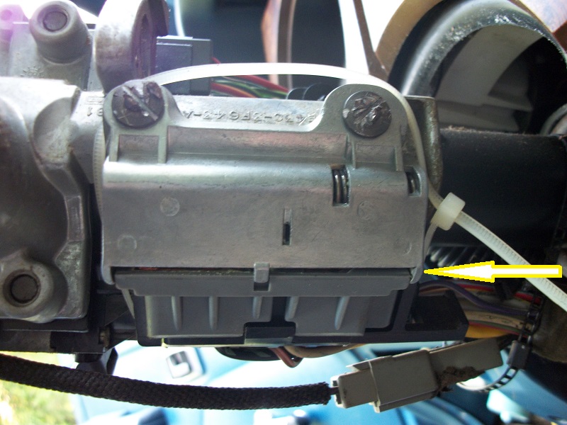

Removing two screws from underneath will let you remove the steering column plastic trim peices.
Now you can look at the electrical part of the ignition switch. Check for a gap on the switch between the plastic and metal parts. Wiggling the wires or the plastic part will help show if the two parts have loosened. It will look like this:
If the switch is tight, you can also meter the switch wires to confirm that it's not the problem, before moving further down the circuit to troubleshoot.
If the ignition switch is bad, you can replace it, or try strapping it back together (like the one pictured).
