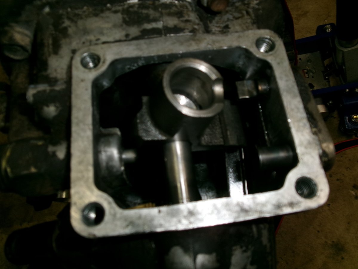

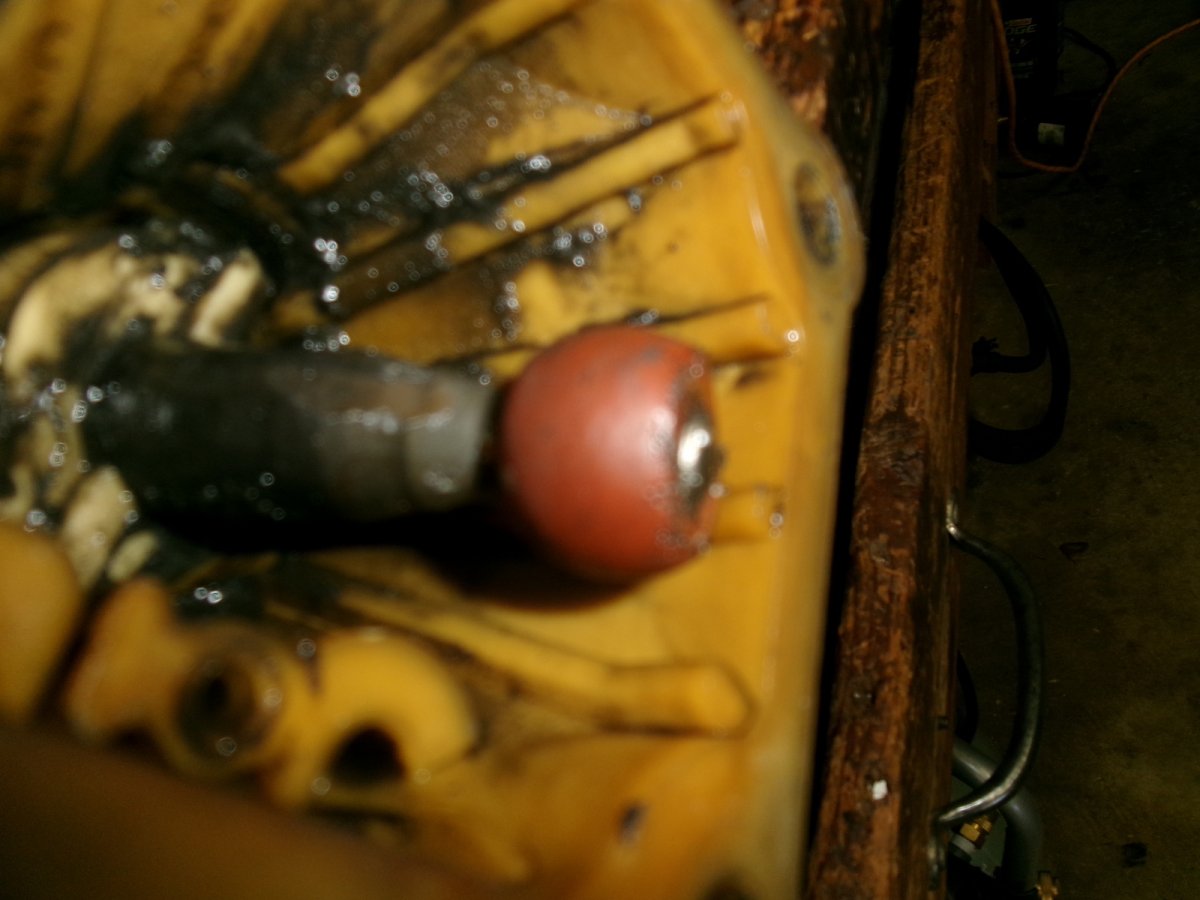

Hey, newbie here, original owner of an '87 Ranger, 2.9 TK-5 trans, mfd. March '97.
The hydraulic throwout went, and working on that, but with the tranny on a stand in the garage, I put the shifter back in after fixing up that bushing with some 2 part epoxy, but it only seems to want to shift into 2 gears, I can't move the shifter to get it to select other gears. Did I screw up somehow and how do I fix that? Thanks!!
I seem to be able to move it into the gears by hand, and if I put it in 1st then put the shifter on, it acts like all is well but then won't go back over to the 1st and 2nd gate. ???? Did I put the bushing too low on the shaft, would that make any difference? It might, mightn't it.

View attachment 95631View attachment 95632
You might have better luck starting your own thread over in the transmission forum
It's because you missed the hole with the end of the shifter, i think. Put the shifter in neutral and try again.
