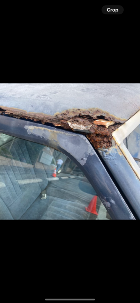

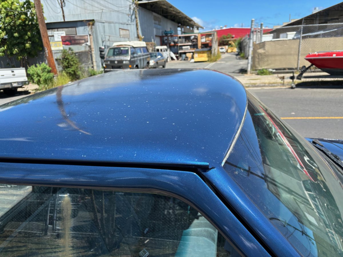

the roof was super rusty so I rallied and did the metal repair and painted down to the other body color line / got some new wheels and tires and there she is

I'm curious, what color is that? I assume from the condition of my clear coat here in sunny Colorado that it is not original with your Hawaii plates.... unless maybe the hood is stock paint or it was garaged it's whole life.
