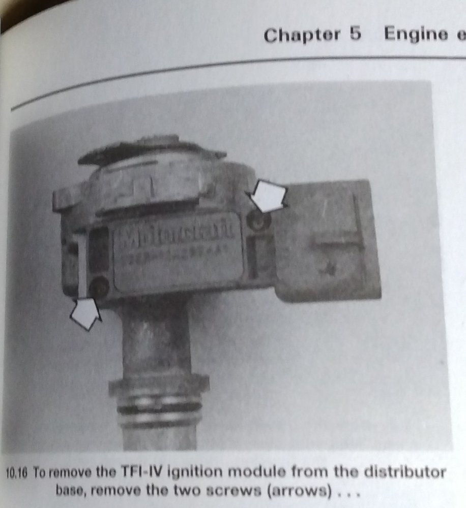

No junkyards near me had any Aerostars and only had Mercury Cougars that weren't in the years listed in the Ranger Station article on how to do this. I just grabbed the heatsink from the only 95 F150 in the yard and the connector for the module. Unfortunately I forgot to bring the special thin wall socket tool you need to take the module off of the heatsink, so I had to pay $28 for a module I can't use. I figure I'll just solder on some 16 AWG wires to extend the connectors. There's a good open place to mount it right near the firewall on the driver side fender. I had a question about shielding though, would it be enough to just buy some shielding tape and wrap it around the wires? I also saw that it seems like only the PIP Out, Spout In, and Ignition ground are surrounded in shielding tape on my current wiring harness, all the others are just unshielded wires. Would I shield just those 3 wires in the extension I plan to make, or should I shield them all? Also, would I shield the extension for the 3 wires coming from the spade connectors (Hall Eff. Ground, Hall Eff. Power, PIP Signal) that usually go straight from the module to the distributor?

I am a big manual reader/manual follower. I did just like the write up suggested and grabbed all the wiring, shielding and the heat sink. All that remained was deciding which suggested method to connect to the distributor.
The way I understand it, all of the shielding is critical since the module is no longer directly connected to the distributor.
