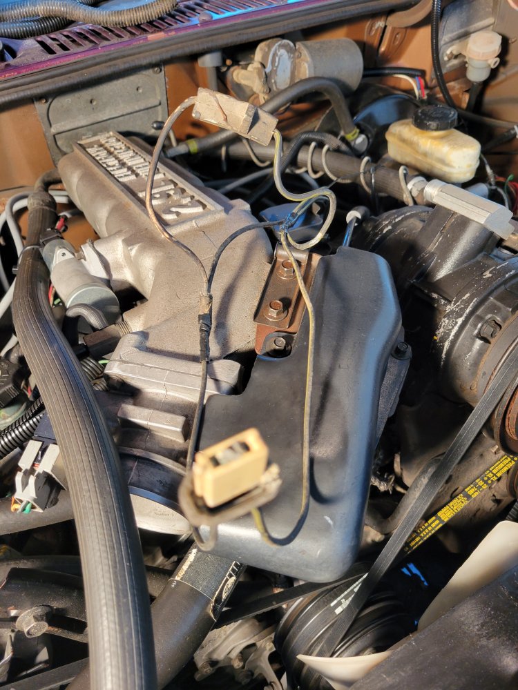

Great help from this forum over the past few years helping me resurrect this gem from the dead.
Detailed her last week to a beautiful shine. :cool:
With the summer still on, I figured I'd take on the (stock) A/C. Replacing hoses, I figured I'd check the compressor before closing the checkbook.
With a direct jump from the batter, car running, the clutch engages and runs!
Otherwise...no A/C from inside the cabin, so I started troubleshooting. (Clearly I'm stuck, or I wouldn't be posting...😬)Found the 30A fuse blown, so replaced that.
  • A/C button pressed (defrost mode), the light illuminates...

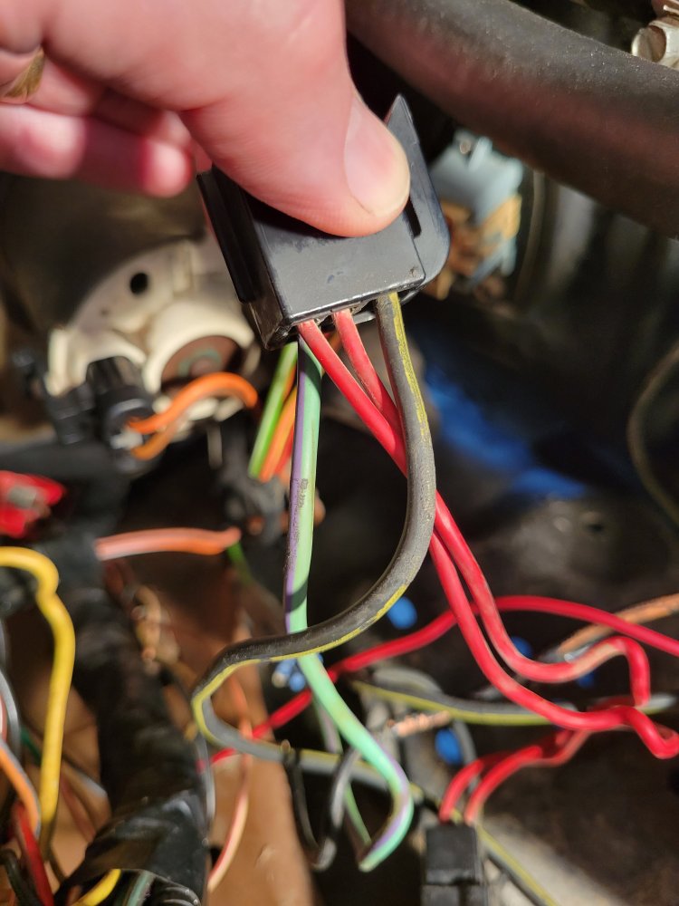

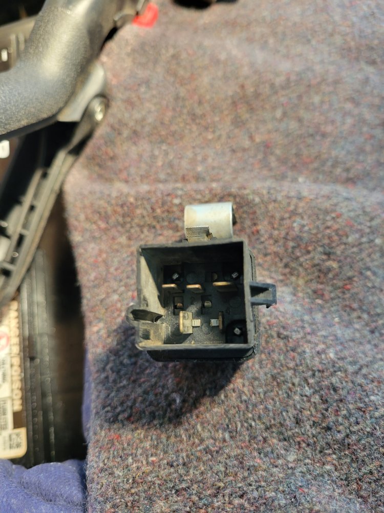

  • WOT relay (picture attached) seems to fit the "2.3L EFI" diagram from this post. With the WOT relay removed (KOER) I read:
    • 13.63v from the far left red wire (See picture below)
    • .43v from the center red wire
    • 13.73v from the Lg/P wire
    • -.04v from the B/lg wire
  • WOT relay installed (KOER) I read:
    • 13.60v from the far left red wire
    • 13.6v from the center red wire
    • 13.65v from the Lg/P wire
    • 13.65v from the B/Lg wire
  • 13.6v on the near-side of the pressure switch connector.
So far so good! (A/C button --> WOT relay --> pressure switch: energized!
I add a jumper between pressure switch blades (Just to eliminiate a possible failure there) and the fuse blows.
I removed all tape and plastic casing around the B/lg wiring headed to the compressor for a visual inspection, and I see no visible shorts. I confirmed the ground wire is clean/secure on the passenger wheel well. Just for kicks, I test for voltage on the A/C clutch connector (red lead to the battery "+"), and both blades read 12.38v.
Here's where I'm raising my hand for what to check next. 🤔
Other than the fusible link, I wouldn't think there'd be a closed circuit between those two blades, so maybe a short in that connector?
I'm also curious about the BK/Y wire coming off the A/C compressor (one leg goes to the pressure switch, the other seems to head to the EEC), as that white connector looks confusing. (4 red wires, B/Y and a ground wire all meet)
Any recommendations on where the short might be?

Thanks for the quick response!
I noticed the same feedback to another person, and that comment caught my eye: "WOT relay MUST BE a 5 pin relay or it won't work, make sure you have a 5 pin relay in the WOT base."
The picture I posted shows 4 pins (and a 'stub'?). I only have 4 wires going to the relay. I'm not the first owner, so is it possible that 5th wire is missing/modified?
Meanwhile - I did he test(s) as requested:
Since I don't have two wires at the top (2) blades, I'm not sure if the (lg/p) wire is 30 or 87? In any case, I do get 12v on that wire with the a/c button is pressed and 0v when it's not. So we're good from the a/c button, through the relay and to the pressure switch?
After replacing the WOT relay, no "click". The A/C button is still illuminated, so the fuse hasn't blown again. (I went through 3 today, testing)
So there's something wrong with the wiring between the pressure switch and the A/C clutch...
Does having both the connector wires at the compressor reading 12v provide any hints? (red probe on the battery "+", black probe on either blade - both read 12v, and I get continuity between those blades.)
It only needs 4 wires, but the relay needs to be 5-pin model
4 pin relay has no 87A, so no ability to pass 12v to the AC Clutch when relay is off
As said, its a "reverse" relay setup for this, passes 12v when relay is OFF, cuts the 12v when relay is ON, which is why it doesn't need the 5th wire
Look at the diagrams of relay bases, which one do you have, mini or micro?
We/you do not care about slots 85 and 86, they are for control, and there is no control of this relay required UNTIL you are driving at Wide Open Throttle
Just test slots 30 and 87A only 1 will have 12v, key on, AC button on
WOT relay will never "click", unless you were driving at Wide Open Throttle, and I doubt you would hear it, lol
Definitely micro.
(bottom 3 are horizontal, top two are vertical)

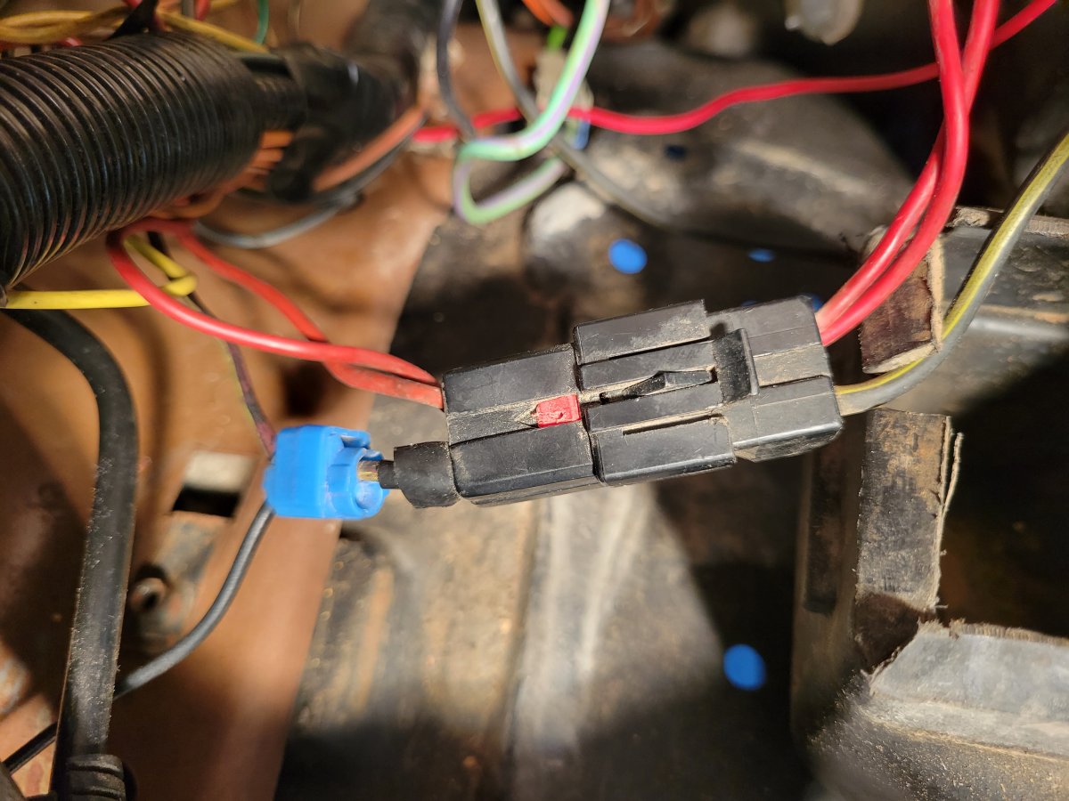

Any tips on troubleshooting power getting to the A/C clutch connector?
I'm seeing voltage in both blades of that connector. Seems like a grounded wire?
I'm guessing the 'dashed' lines are energized and the 'solid' lines are grounded. That would suggest the blades on the a/c compressor expect a positive on one side and ground on the other. (Yet I'm finding both sides will read 12v with the other probe on the battery "+".
The diode...(fusible link)...looks like it joins positive and grounded wires which isn't making sense to me. Thus, I'm unclear on how to troubleshoot "no power" getting from the pressure switch to the a/c clutch switch. What am I missing here?

If the AC Clutch is plugged in then BOTH wires should show 12v if AC is on
Clutch is just a coil of wire, so 12v in = 12v out
If you unplug the AC Clutch connector then one wire will be 12v and the other 0v, a Ground
If both wires show 12v when its unplugged then the Diode is bad

So I cut out the diode and retested...still getting a 'ground' on both blades of the compressor connector. Tracing the B/Y wire toward the EEC, it appears to connect directly to a ground wire. (Black wire in this picture is grounded to the front body.) Not being the original owner...is that wiring correct? (A/C has never worked since I bought it)

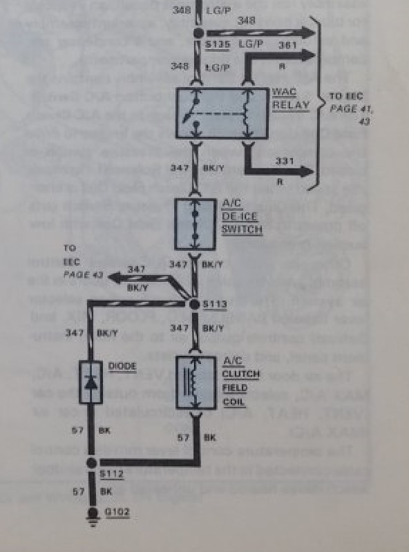

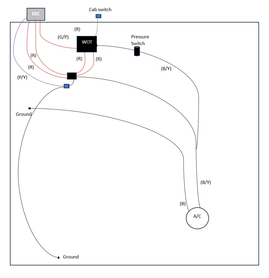

Great summary, but that isn't addressing the grounded ac clutch (b/y) wire.
I see we keep referencing a 1991 wiring diagram which does not reflect this '86 B2. I'm attaching an accurate drawing (albeit Microsoft Word 'chicken scratch') showing the actual path as:
Cab switch -->WOT --> Press switch --> A/C Clutch --> Ground
It's the plug intersecting [4 red wires, (b/y) and a (p/y) + (b) wire] that has my attention now. For some reason when I test between battery (+) and the (b/y) wire at the A/C clutch switch, I'm getting 12v. Given one branch of the (b/y) wire goes to that plug which has a body-grounded (b) wire - it makes sense that it's grounded (but shouldn't be?) However, even when I remove that front-facing ground wire from the body, the (b/y) wire at the A/C clutch is still grounded.
Anyone have a wiring diagram for this '86 Bronco 2 showing where those wires should go, and for what purpose?

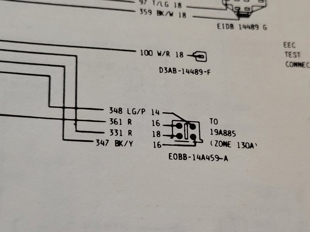

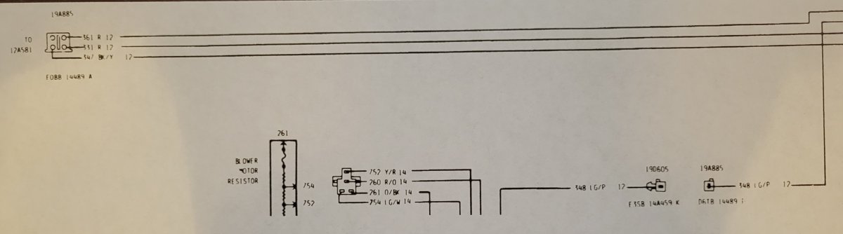

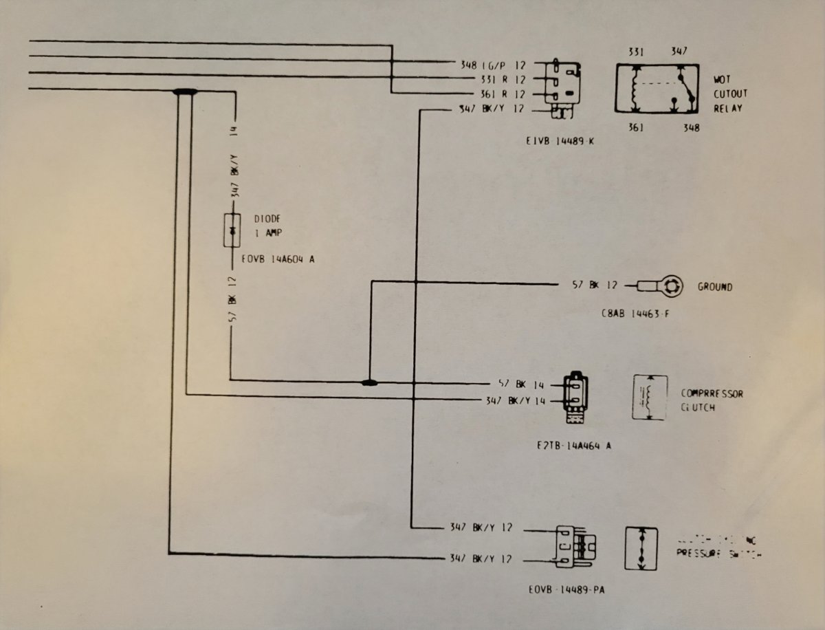

I found the '86 digrams in the back of a Haynes manual. The reference above is for an '87, and it appears the routing is a little different (a/c clutch --> WOT --> pressure switch in the '87, but ac clutch --> pressure switch --> WOT in the '86. (As I'm visually confirming in my truck)
Diag1 shows the routing (347) from the a/c compressor --> press switch --> WOT... Also the two red wires (331 & 361) and a lg/p wire (348) coming from the WOT...
Diag2 shows (361), (331) and (347) terminating in a connector (1448) connecting off-page to 12A581.
Diag3 appears to be the other end of that connector (14A459), where the same (331), (361) and (347) continue on to the EEC (not shown, but validated). The diagram shows an lg/p (348) leaving 14A459, but not entering (14489). In my previous post, a picture of that connector under my hood just doesn't match up. There's no lg/p (rather an empty socket), and the (b/y - 347) is jumped into that blue connector where a purple/yellow wire heads toward the EEC, and (b) wire heading elsewhere. (Assuming it was to be grounded, I grounded it next to the radiator) Unless I'm looking at the wrong connector in Diag3...
Anyone with more of an electrical background than I (none) recognize this? (I can scan/upload the full page diagrams if it would help)
