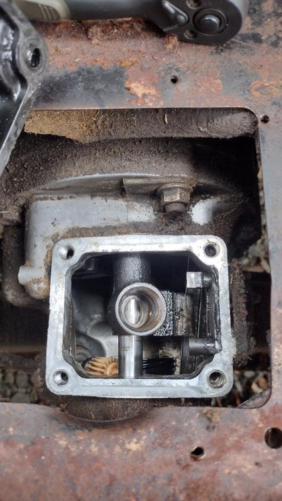

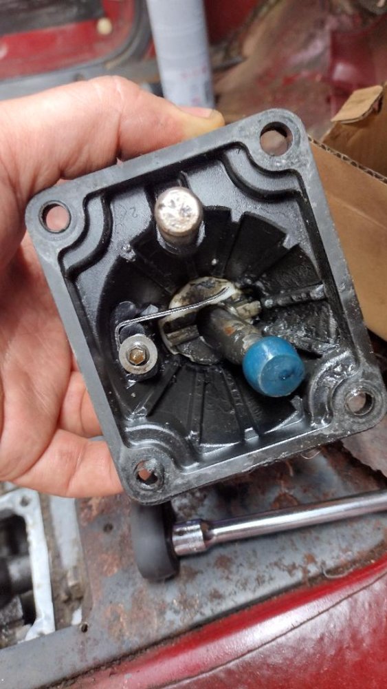

Bought a 1985 Ranger and the shifter is very loose, does anyone know which transmission this is?
EDIT: SOLVED, I believe it is a TK5.
Yes it's a 5 speed. I could not find a single company that had the correct bushing, and I could only find 1 company that makes the whole assembly. Hopefully this will have it feeling like new.Does it have overdrive? I wouldn't be surprised if a 2.0 was bought with a 4 speed. Either way, usually the sloppy shifting can be tied back to the ball ont he bottom of the shifter being worn out IIRC. Memory says that it is a plastic ball that fits into that cup and it can wear down, if not full disentegrate, over time. I recently found out that core shifters actually makes a repalcement short throw shifter for these transmissions. I wish that it had been available years ago when I still had the 2.8L and TK5 in my '84.
