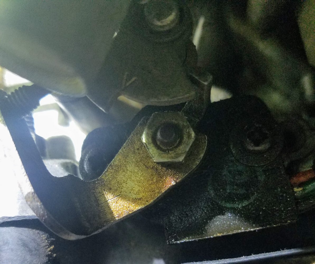

I didn't have the fast idle at the V on the cam. It was way past it, so literally choking the motor out the entire time.
I only have one step as I suspected, but seems to running well. I attached a picture of it. This is before I adjusted it correctly.

I would say I'd probably turn the fast idle speed screw another half turn. Didn't sound like there was much of a difference between idle and fast idle.

Half a turn tighter for fast idle? Does not having two steps on the cam effect fast idle and idle?

There should be two screws that control speed of the engine. Idle speed screw and a fast idle speed screw. One shouldn't affect the other... unless they're way out of adjustment. The idle speed screw contacts the throttle shaft. That one sounded pretty good to me. The fast idle speed screw... item 4... I would try another 1/2 turn tighter (faster). Turning the fast idle speed screw should have zero effect on base idle.

The idle speed screw and fast idle speed screw are on opposite ends of the carb from each other right? Idle speed is over on accelerator pump side (in this case) and the fast idle is over on the choke side.
That is correct...
That's what I thought, just wanted to confirm.
I haven't touched the idle adjustment even during the carb rebuild.
I'll tighten the fast idle screw in another half turn tonight and see what we get.

The "V" you have on the fast idle cam is the second step, that's where the fast idle screw should sit when the choke pull down has vacuum and you tap the throttle to make it drop down. Before the pulldown has vacuum the screw should be on the top step holding the throttle open more. Most 2.8's, even back in the 70's in Pintos and Mustangs would flood if you pumped the throttle more than once cold, you don't even need to floor the throttle as long as you open it enough for the choke to close. With the engine warm and the fast idle on the second step the engine should be running around 1500. I would also warm the engine and set the idle mixture screws before doing any other adjustments. Using a tach or a vacuum gauge slowly turn one screw looser until the idle starts to lose speed or vacuum, then tighten the screw until it starts dropping again, then loosen the screw a whisker. Do the other side then go back and recheck the first one. No, whisker isn't a Ford term ,we used to say c**t hair but I've gotten smoother as I've aged.

Went out tonight and adjusted the fast idle screw half a turn.
Pressed the accelerator and she fired right up!
Noticed the fast idle was higher (as it should have been) and the engine warmed up a lot quicker.
Came off fast idle and sounded great.
It hasn't ran this well in 10 years. So happy I got it running well.
