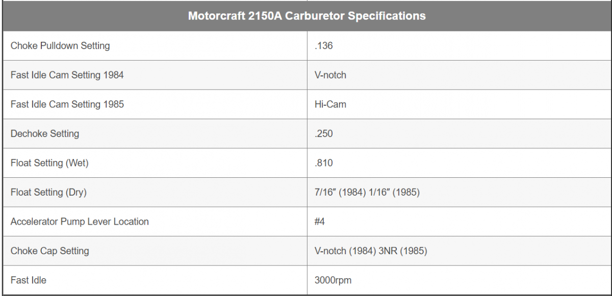

I also don't understand what the "dechoke" setting is in the table or the "choke cap setting" that says "3NR" for the 1985 model year. Since this was the last year for the feedback carb, I think they made some silly changes.
I forgot to address this part....
Dechoke setting. I believe this is an adjustment so that you have an "unflood" option with an automatic choke. This should "open" the choke plate by holding the pedal wide open. So when pedal is wide open... cold engine... the choke plate should open to a spec listed in your instructions and adjusting it as specified.

The tech library also states "V-notch" in 1984 and "Hi-cam" for 1985 -- what is the difference?
