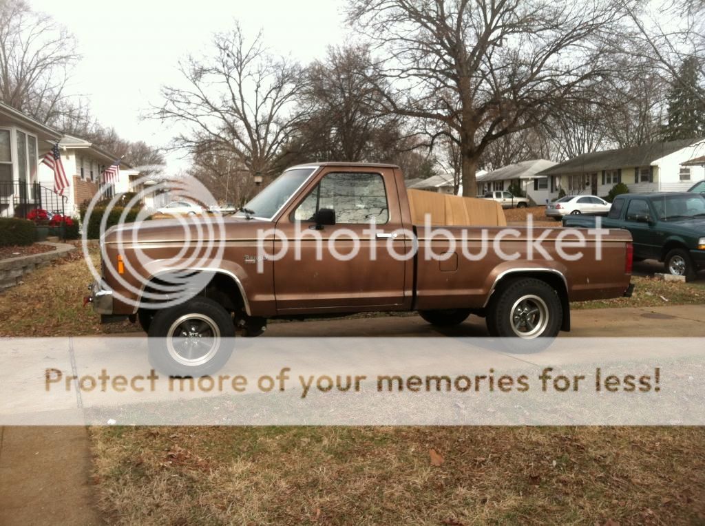

So work has slowed to a crawl and I've finally got time to work on her again. Yesterday I managed to get everything loose and the motor ready to be plucked. Before I started tearing her apart I drove around the block with the new suspension set up just to be sure it was all squared away. Here's a pic of her out in the sunlight:
