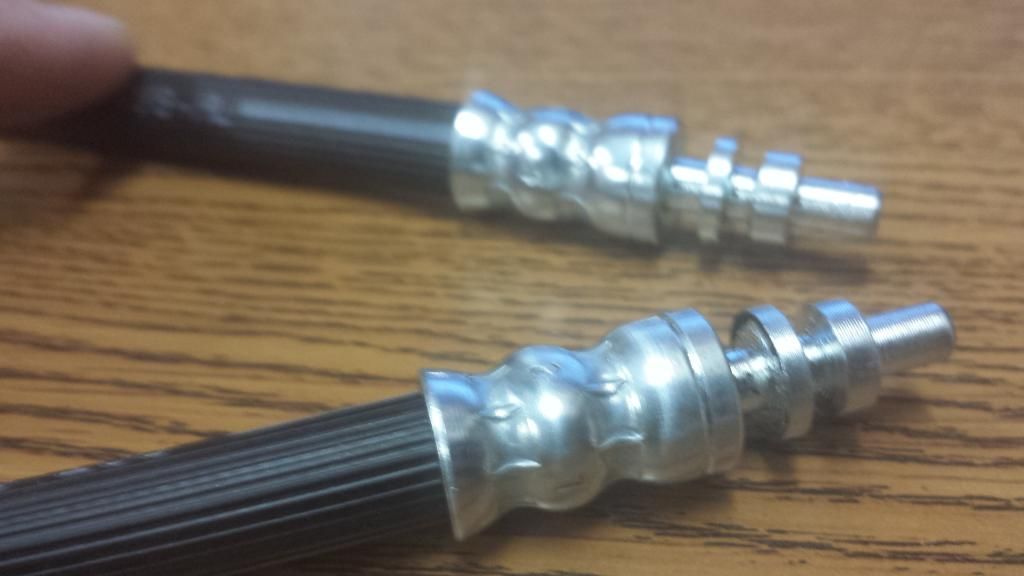

I'm gonna do my best to explain what I've found. I finally had some time to try to pull the line. As suspected both sides were held in by roll pins. I had to remove the slave cylinder and master cylinder in order to hammer them out with a punch. I ended up putting them both gingerly in a vice and tapped them out. Turns out the old line had melted a hole in itself from I guess touching the exhaust. I took the line to a local hose and fittings place. The guy told me that this type of fitting is called a spicket (spigot) fitting. He made me a rubber one that matches the old one. Hopefully tonight I will get a chance to test the new hose. The fittings are a little different so fingers crossed! :headbang:
The old fittings cut out of the hose
