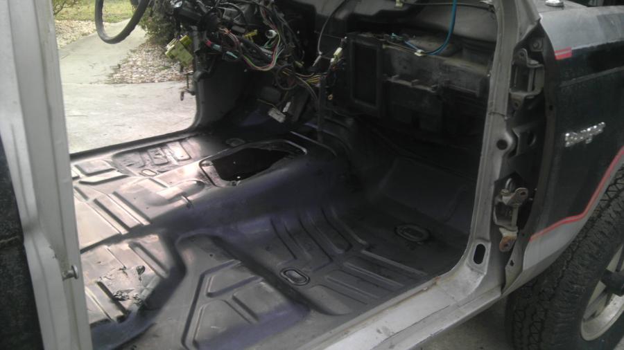

adding some more photos for perspective and to keep me motivated to finish this project...

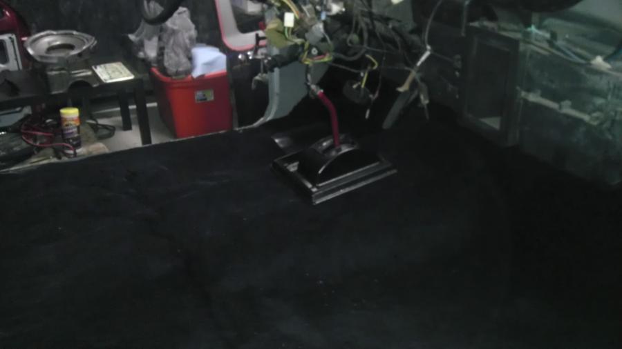

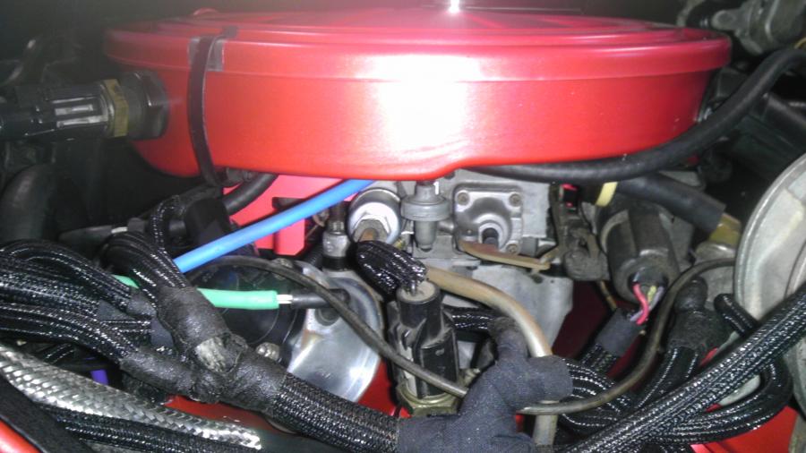

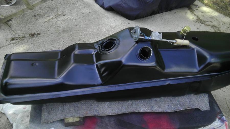

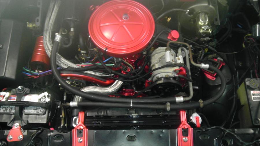

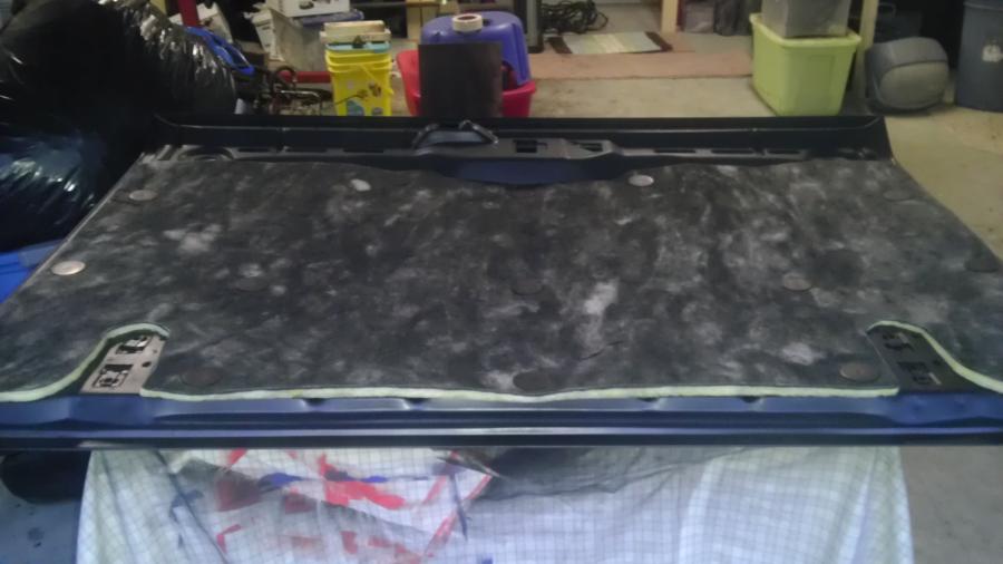

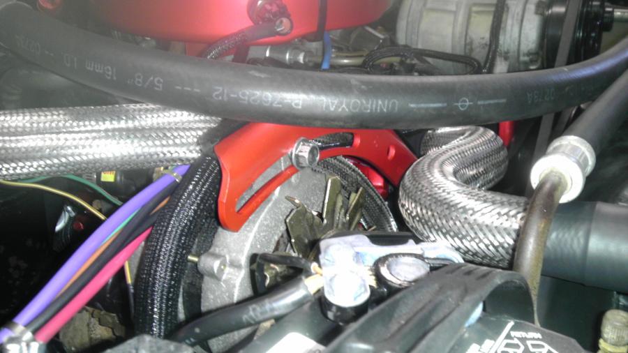

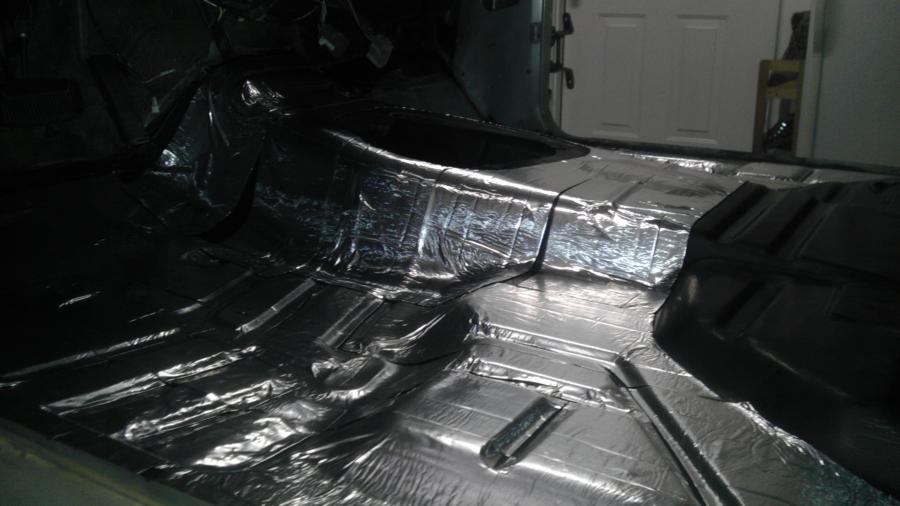

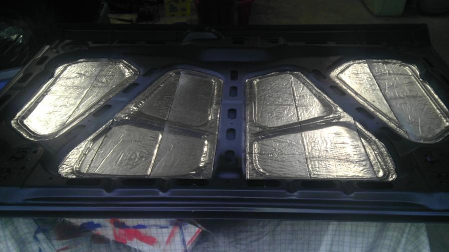

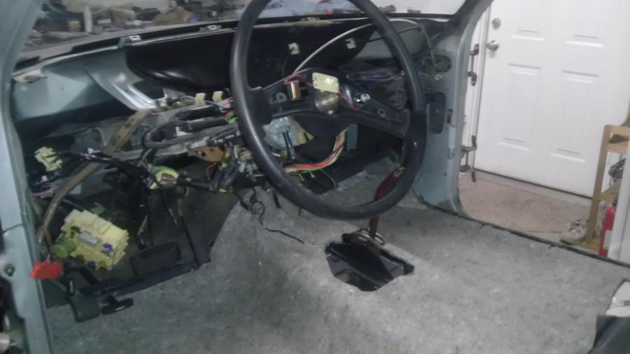

most of this work was completed weeks/months ago...flooring is a composite of new floor pan, POR15, cheapo version of sound dampener, padding, molded carpet...hood is the same sound dampener + generic fiberglass insulator...new tank with refurbished sending unit...and a few engine bay shots w/ close-ups.

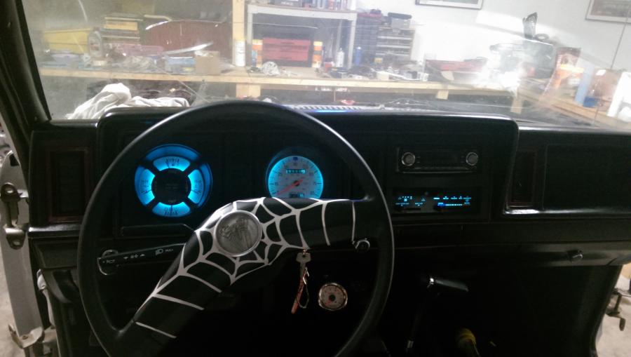

However, I have been able to squeeze in a few things:

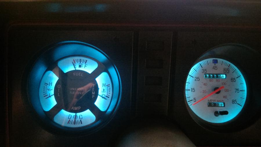

- ditched the monofilaments for LEDs in the dash
- picked up an NOS speedometer on ebay for $20 to replace my wonky one...I like the fact that there are only six tenths of a mile on it (for my sake, let's go ahead and pretend someone didn't wind it to all 0's), and I still can't believe I got it for only $20 (yes, works just fine and isn't wonky)

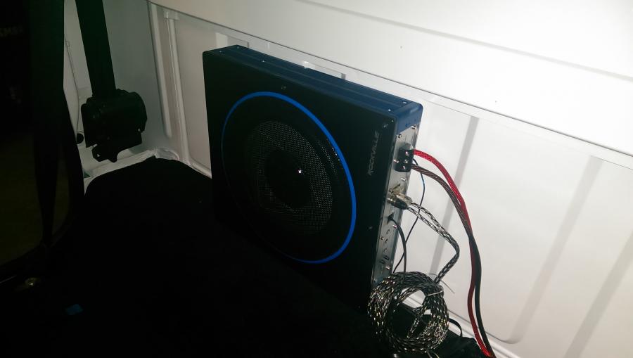

- finally wired in the DEH-6700MP stereo and put 4.5" kickers in the front, and wired up a Rockville 10" slim powered sub...ok, I'm admittedly not thumping down the street, but the sub has got some serious kick which rounds out the sound...I like.
And last, used my high tech tool to pull KOEO codes and got:
flash-flash...flash-flash-flash...pause...flash-flash
Not sure yet what to do about the TPS. I've got an aftermarket a-la autozone one in there now. may just go ahead and replace with OEM.

The gauges look nice, bright and easy to read.

1 other thing i wanted to ask, nice new under hood protection, where did you buy that silver coating and the tough looking felt under lay. or what is it exactly?
thanks
thanks again for hanging on to the 2.8 stuff :-)
the silver coating is, funny enough, thin attic insulation I bought from Home Depot...hopefully did my homework well and it should withstand underhood temps no prob (I hope). It also holds some sound-deadening properties which is why I lined the cabin floor with it. Maybe not as effective as the pro stuff, but certainly a much, much cheaper alternative.
The other insulation is fiberglass and not at all as sturdy or tough as it may look. I bought it from LMCtruck, along with enough plastic "pins" to hold it on. It was inexpensive (so I suppose I knew it wouldn't be too tough), but I wanted it and I like it. You have to cut to fit (I made a cardboard template first), and the sheet you get was big enough for two cuts.
thanks for the info, was looking at that stuff and thought wow it looks good.

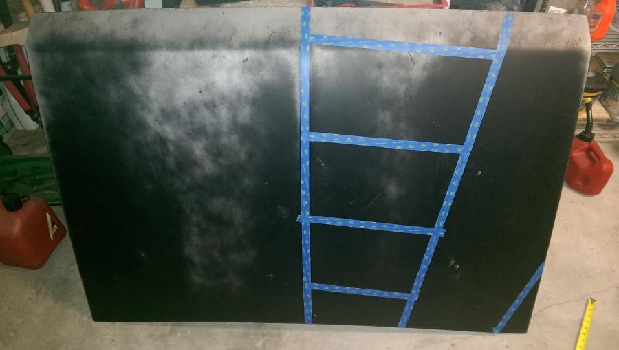

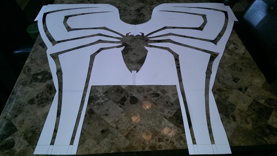

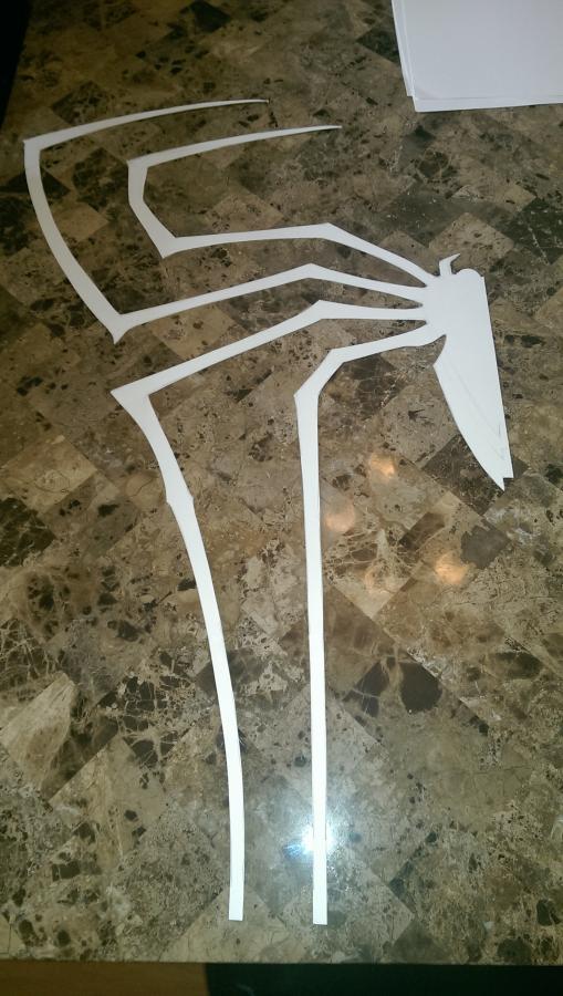

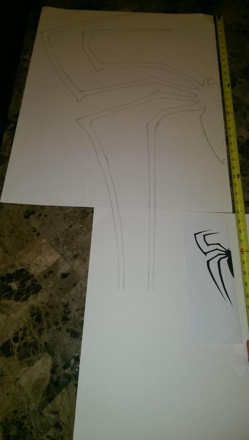

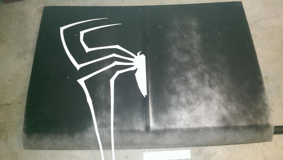

hood graphics
finally got around to conceptualizing the hood graphics so I thought I'd throw up a preview of how i'm hoping my idea will pan out.
pics in order are:
- original drawing (w/ reference)
- stencil template (which was modified slightly from original drawing)
- template double-checked for size on hood
- completed stencil (negative)
- basic web concept
I've got a few things to do for surface prepping, and am hoping to paint in a week or two...
Thanks for watching!
