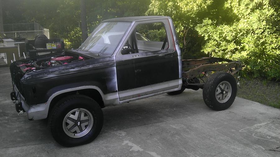

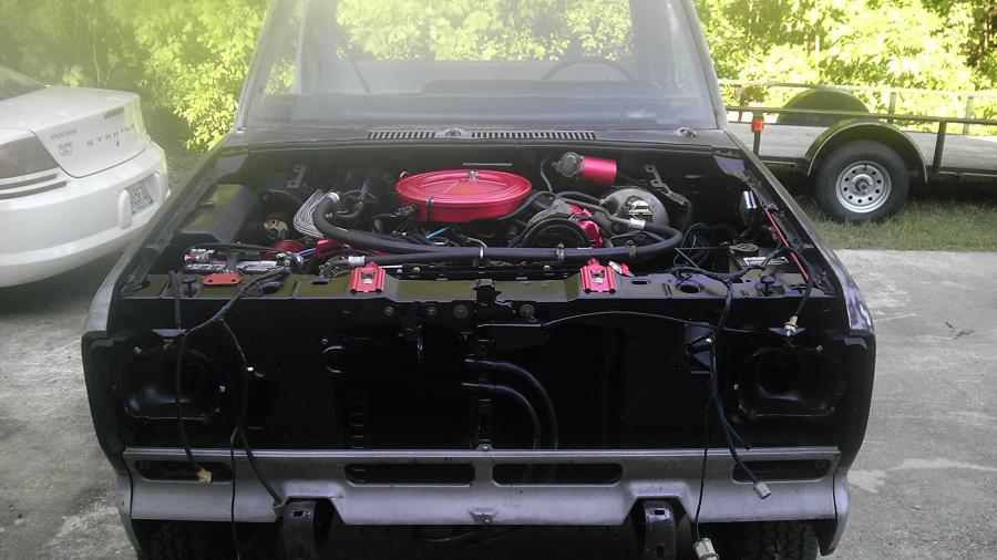

Had a few minor setbacks which delayed my tour of the neighborhood...new radiator and brake hose for the most part...and finally got everything (timing, fast idle, curb idle, etc.) dialed in. Put the new brake hose on tonight as soon as I got home from work, bled the lines, and away we went. Before today her tires had not touched asphalt in about 4.5 years...felt so good and she did so well...but still so much more to do.

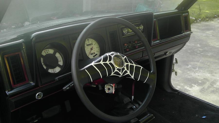

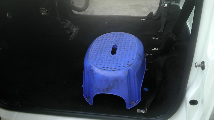

Here are a few pics I took after backing out of the garage...went all out with custom seating for the first drive ;-)
And oh yeah...I'm kind of a spider man fan as you'll likely notice on the interior pic.
And yep, I aired up the front tires before driving...

I was in a project that went the other way with the gutted interior, and if the parts for the 2.8 weren't so hard to find it would have been a resto, but alas it was a restomod. Your engine bay is beautiful! What are your exterior paint plans?
Thanks Lariat! I'm trying to keep it as close to restoration as possible, but you're right...2.8 parts are hard to find. Fortunately I had a pretty solid inventory in the bay to work from.
The interior will be finished off w/ custom vinyl seats that match original design, but will be black w/ white pleats and piping. The spider in the steering wheel needs some finishing touches as well; I put in a small circuit board w/ LEDs, and 9v, and a push button and the center glows when switched on.

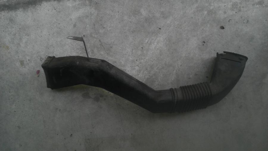

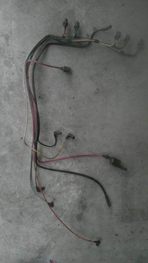

Went to the junkyard today (Pullapart)...came across an '85 with a 2.8 in it and scored a couple (what I feel are) rare finds: original set of vacuum lines, and an original cold air intake.
As you can see, fading and damage (CAI to air cleaner housing) is surprisingly minimal.
Just gotta clean them up and blow out the lines.
Should be nice additions for the "authenticity" of the restoration...
