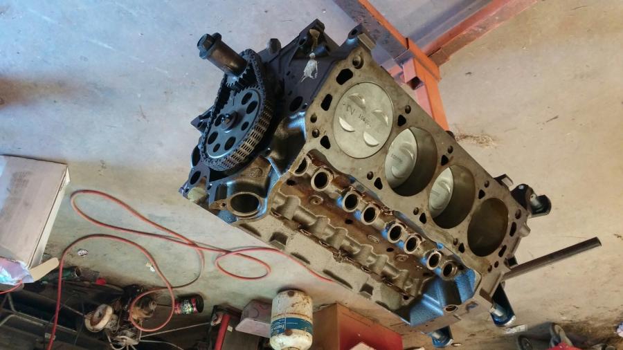

Here is a picture of my NOS 2001 5.0 short block that I am building for my 84 Ranger. The only issues I see is that the 5.0's are 50 oz. imbalance and 302's are 28 oz. imbalance, I think as long as the flywheel and balancer are both the same 28 or 50 oz. it should work. The bigger timing gear on a 5.0 does not have a locating pin hole in it for the eccentric to run the mechanical fuel pump, you may have to drill one to make it work. Oil filters are in the same location. The is a hole in the drivers side of the 5.0 block for the dipstick that will need to be plugged if you are using the dipstick in the timing cover.

One other huge thing to keep in mind, those two engine will have different imbalances. The Explorer is going to be a 50 oz engine. The 68 is a 28 oz. And you can't just throw the Ex balancer and flywheel on and go, it will still be out of balance. The most painless thing you can do is deal with having a single odd-ball bolt on the engine mount.
