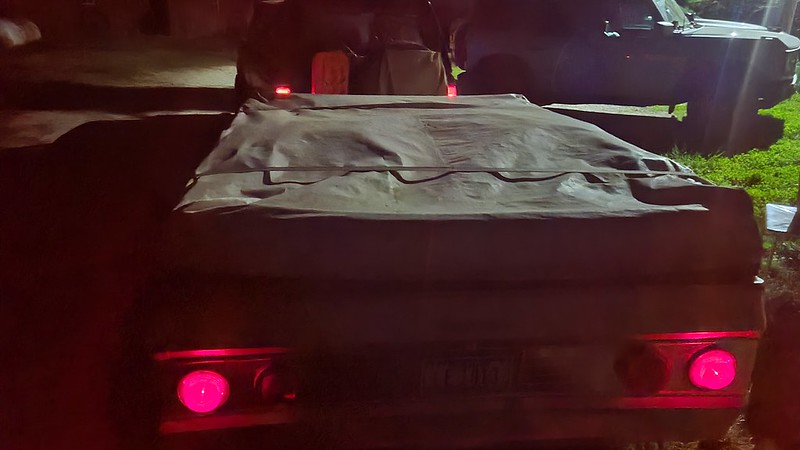

Then we get to replacing the trailer connector. I had a new one, one of the pins fell out as I was taking it out of the package so I returned it today for a new one.
1965 Apache Silver Buffalo
Tail lights
Brake lights
My phone wanted to go to night mode which doesn't work with turn signals but they do work.

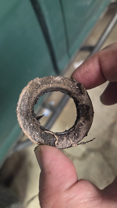

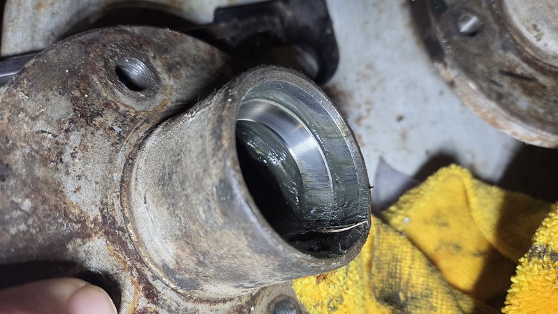

Decided to open a can of worms and see what this thing has for wheel bearings in it.
And...
Both sides were loud, PS was worse than DS, nut was even loose on PS as well.
So we proceed to pull them off and apart. Outer bearings don't look that bad.
Inners not so much...
So I beat the races out to just go with new. I hate to skimp on it with these dinky little tires spinning like crazy to keep up with these dinky little A14 bearing sets.

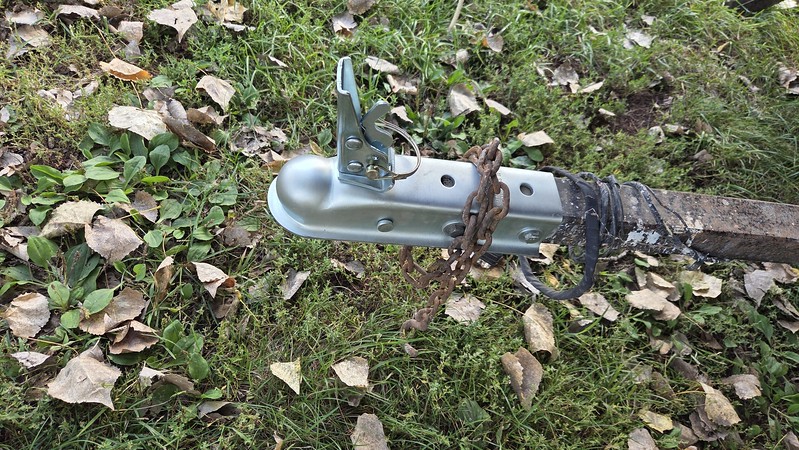

I've been wanting to lose the 1-7/8" ball since day one, it is the only thing in the entirety of my family that uses that small of a ball. TSC had these on clearance so I snagged one.
I was pleasantly surprised they were 50% off sticker when she rung it up so it was less than $5. When coupled with my 6" drop receiver with a 2" ball I snagged at U-Pull-It (also $5 lol) the trailer runs dangerously close to level.
