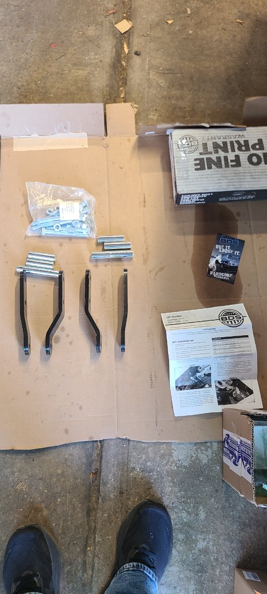

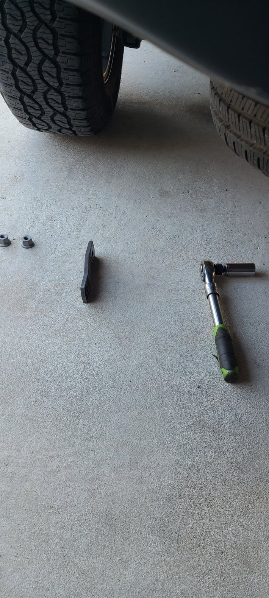

Here are the shackles laid out with the hardware and instructions. They are well packaged and the instructions, though generic, give you basic steps and importantly, the torques at the end.

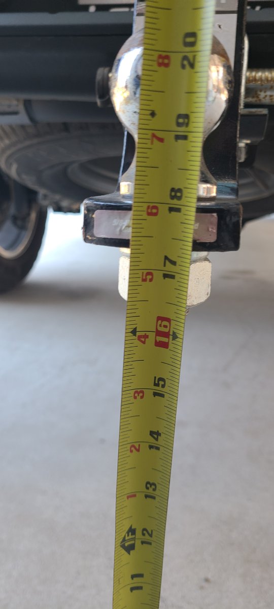

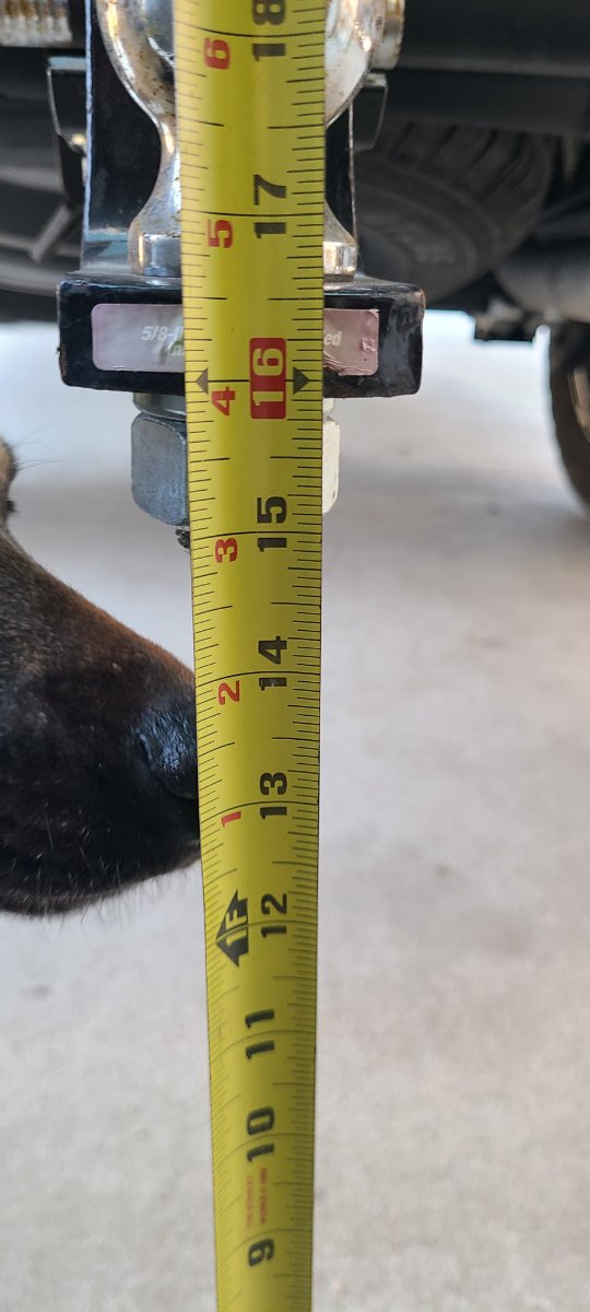

This is the hitch on the stock shackles. I figured this is a great refetence point since its easy to measure from.

Here is the bds and the stock so you can see the difference. The stock has one thin side with the bolts welded to it so they are not going to spin when you loosen the nuts. The side with the welds is bent smd shaped to add stregth to the metal while keeping weight down. A common manufacturing process used in aviation and later in automotive parts.

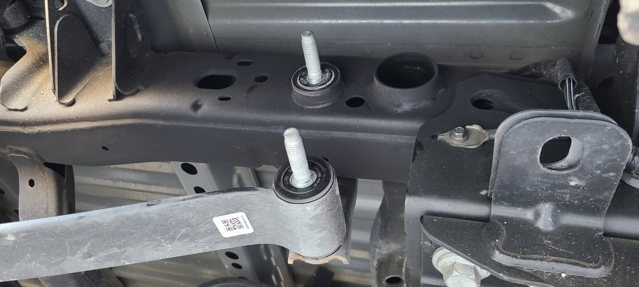

Install the longest siver tubes in the frame bushings, one on each side. Put some bushing grease on them and just slide them in. If they try to push the oppsite side bushing out, while installing, jist put your hand over the bushing and push back amd you will get everything together. As it gets to the last quarter inch, it will get tough so you can tap it in with a rubber mallet, use a long bolt, washers, and nut to pull it together, or even a large pair of pliers with the washer will do it. But, also jist slowly squeezing it between your hands does it too, just a lot slower.

Here is the hitch height after the final torque showing i got, basically, 1.5 inches of lift with the shackle install.
I am sure it will settle a little more over time. If i remember, i will measure at the 500 mile recheck of the hardware torque that the instructions say to do.

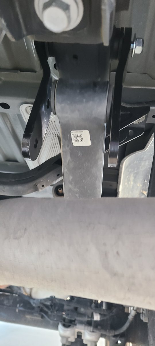

And now you done with your install. The truck looks great and the parts are very well made.
