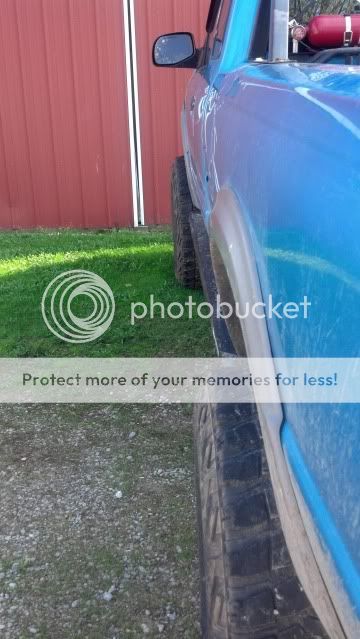

Sounds like the same spec dc2's I'm running. I'll try to get you pics when I get home.
Sent from my HTCEVOV4G using Tapatalk now Free

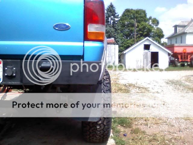

sorry i forgot about this. heres pics, as promised.
Gen 1 and 2 bodies are about 2.5" narrower per side..
Sent from my XT907 using Tapatalk
Thanks buddy.im surprised thats not as wide as i thought they were gunna be
And i deffinately need 12.5s right? Cuz igot a set of free 9.5s it would be nice if the would work
9.5s would look ridiculous. IMO stick with a 15x8, they can handle 12.5s down the road. I regret getting 10s, because at 10 psi the tires pop the bead too easy, they arnt bad with the 14.5s, but the lip of the rim still rubs trees and rocks.
I agree if this is a wheeler go with a narrower wheel. My aluminum wheels don't really leave the street. I've got a set of 33x12.5 mud terrains on steel 15x8's
Also, plum's right about the body on the earlier trucks being narrower, the axle is also about 1.5" narrower. I have since swapped in a d35, its a little wider up front.
