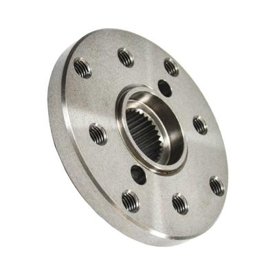

You used to be able to get this for the pinion and tcase flange....you can do like mentioned earlier and drill your own as well....which may prove easier.
