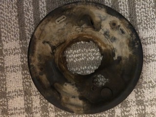

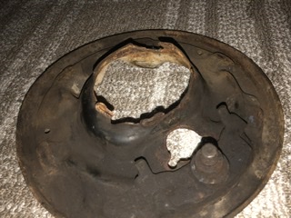

Hi! I have a 2002 Ford Ranger and the 10” rear backing plate on the left side was completely warped. I have been having the worst time trying to find a replacement 10” backing plate when I ordered from oriellys I got in some 9” backing plates. What would it take to convert from 10” backing plates to 9” backing plates. I already ordered the 9” drums and backingplate before I realized I had a 10”.

judging by the photo you may have more problems than just a backing plate.

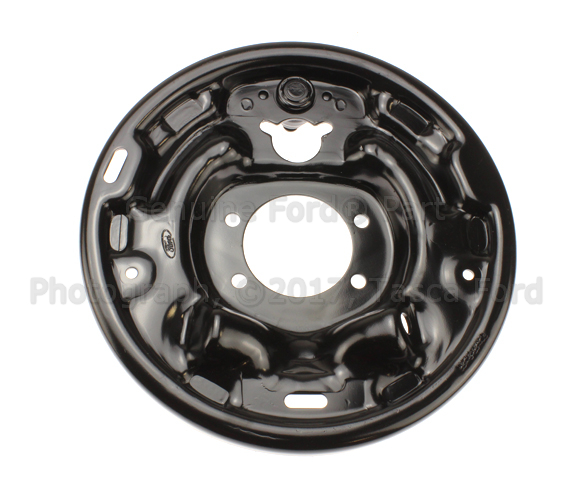

this is from the Tasca Ford parts site.
thank you for that I’ll try looking there after this. I’m in Alaska on the Kenai Peninsula I’ve tried just two of the junk yards I know of here in AK with no luck, I’ll have to google some more I suppose. The guy I bought it from was launched a boat or pulled a boat from the water with the parking break on. It still would stop but the breaks were very weak.

I've found the driver's side, part number F57Z-2212-A Link. Thus far, I've been unable to find a replacement passengers side, but the part number for that is F57Z-2211-A
Its difficult to say off of pictures alone but it would appear as though the difference between a left and right is where the holes are drilled, if this assessment holds true, you could potentially purchase two driver's side plates and drill the appropriate holes (painting the newly exposed metal). In addition, if you still have the rusty ones, you could compare them now before making any financial commitments

EDIT: The link you provided is to the driver side (left) not the passenger side. (Right)

Edit: Ford part # for Right/passenger side 10" backing plate is: F57Z-2211-A. Labeled as discontinued by ford dealerships but I hope having the proper part number helps you find it easier. Having this number will help even O'Rielly's get you the proper size backing plate even if you must get it from the manufacturer Dorman.
