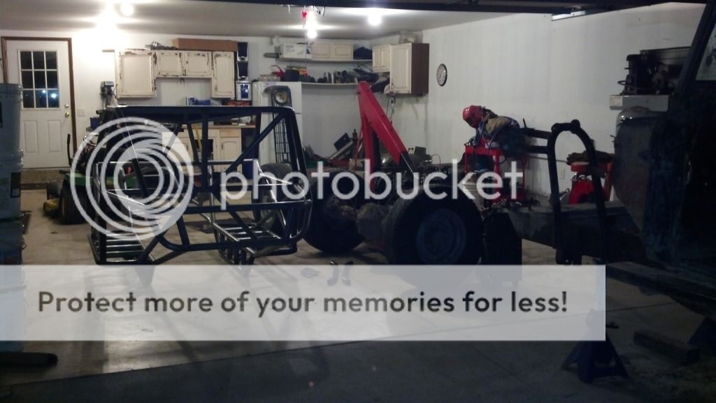

Moved pics from the album they were in to a new album. Don't know if the links got broke or not, so I'll repost what pics I have...
Order placed on Monday 11-5 at about noon..
Got this on Tues.

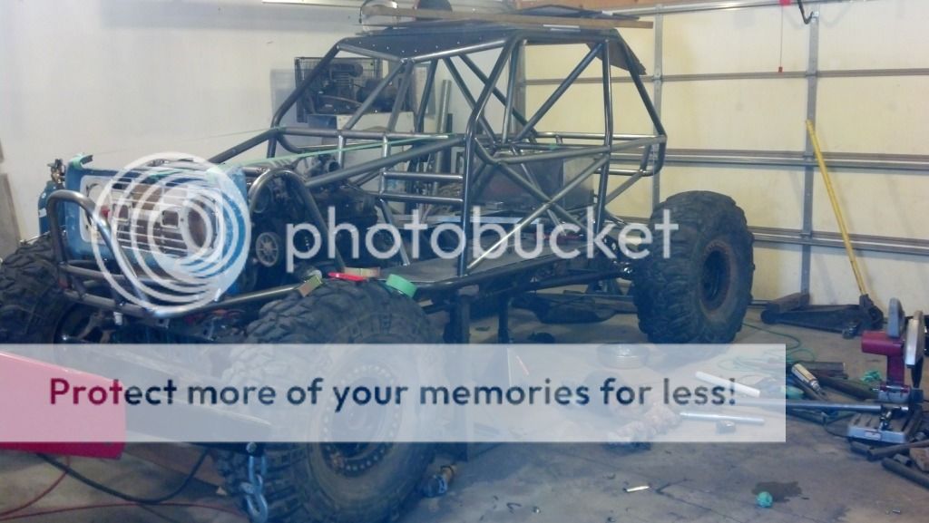

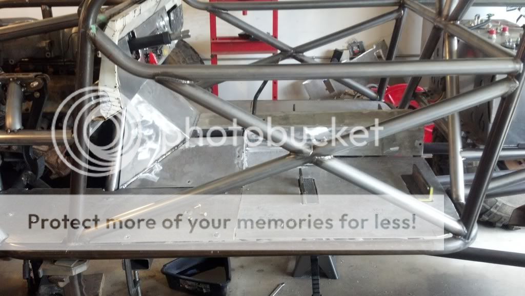

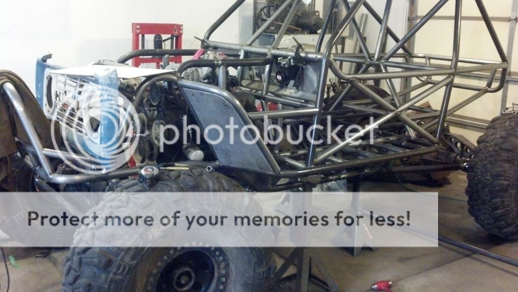

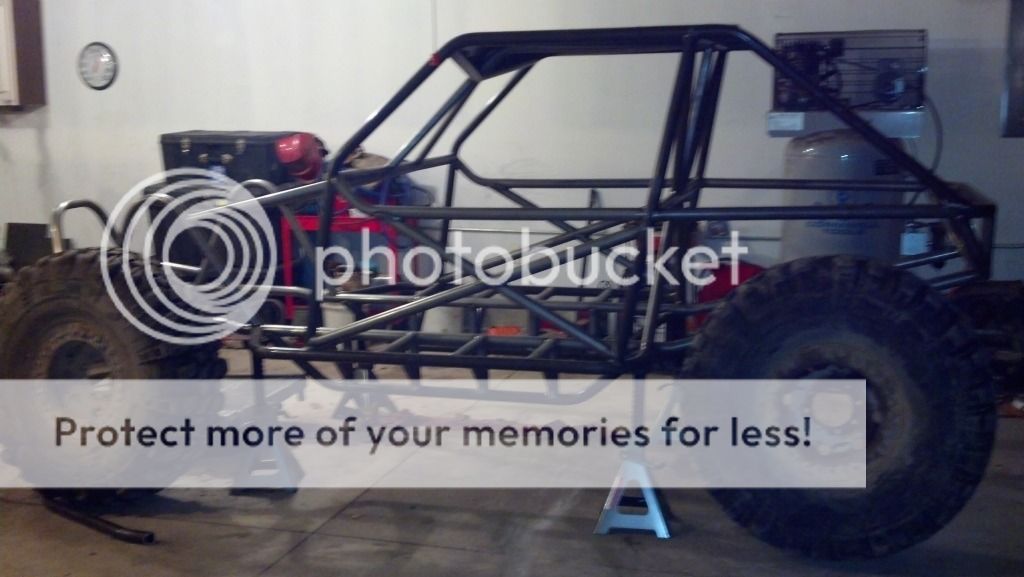

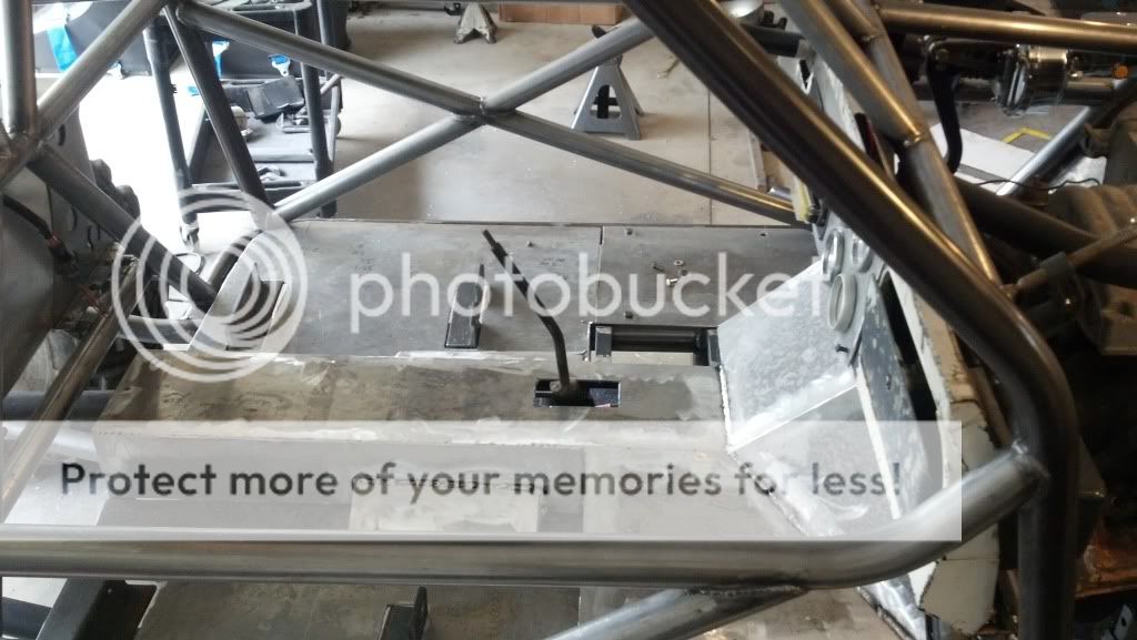

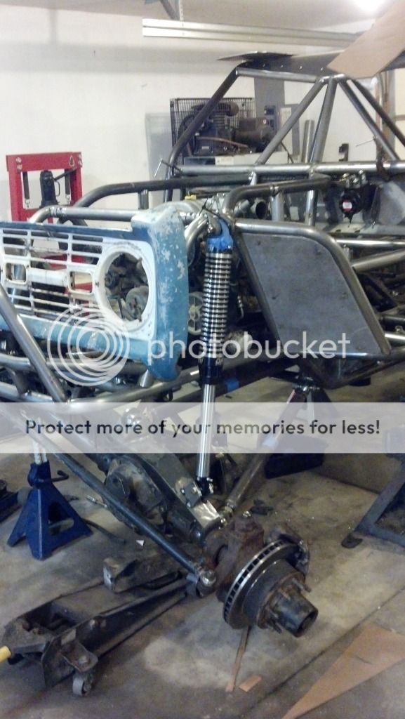

Floor is all cut out and mostly done, need to secure it in a few more places on the chassis. But won't do that till the drivetrain is out. Also figured out placement and lengths of the front driveshaft. Still need to build a carrier bearing support. Once thats taken care of on to the exhaust.

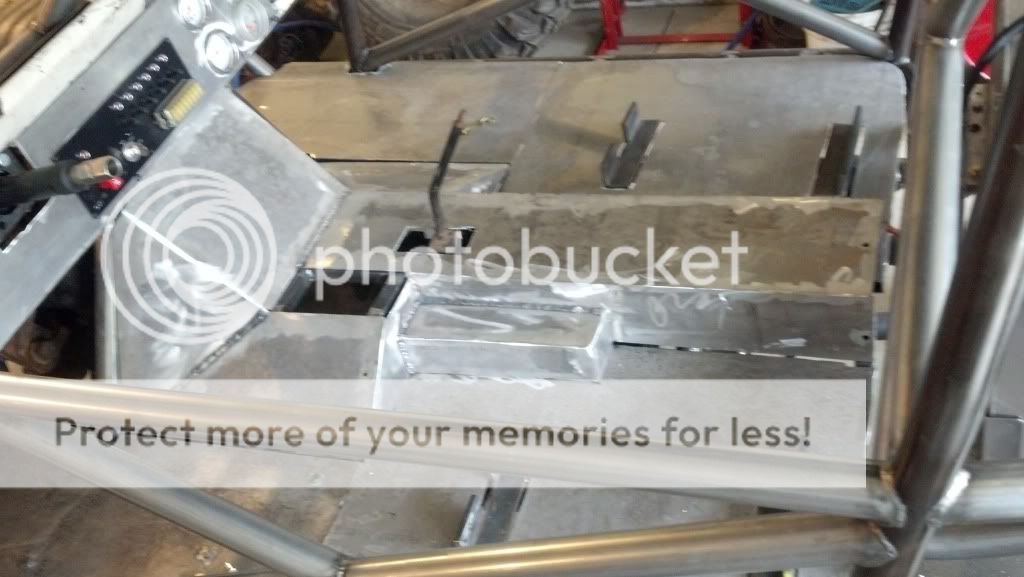

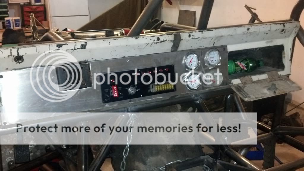

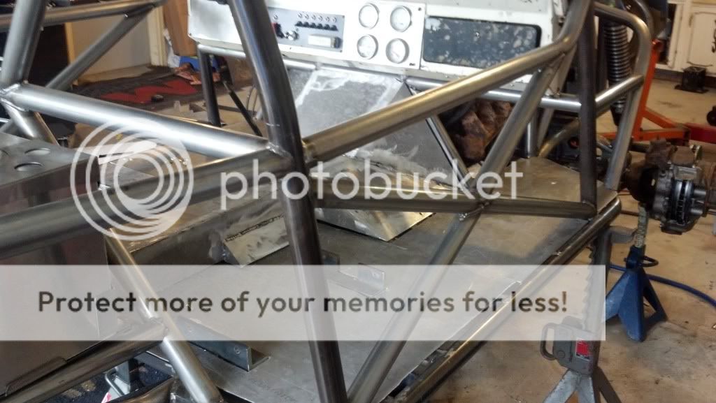

12 volt guy switch panel mounted up.

Fan all set up. Your typical taurus fan, I cut the shroud off and made a new one.

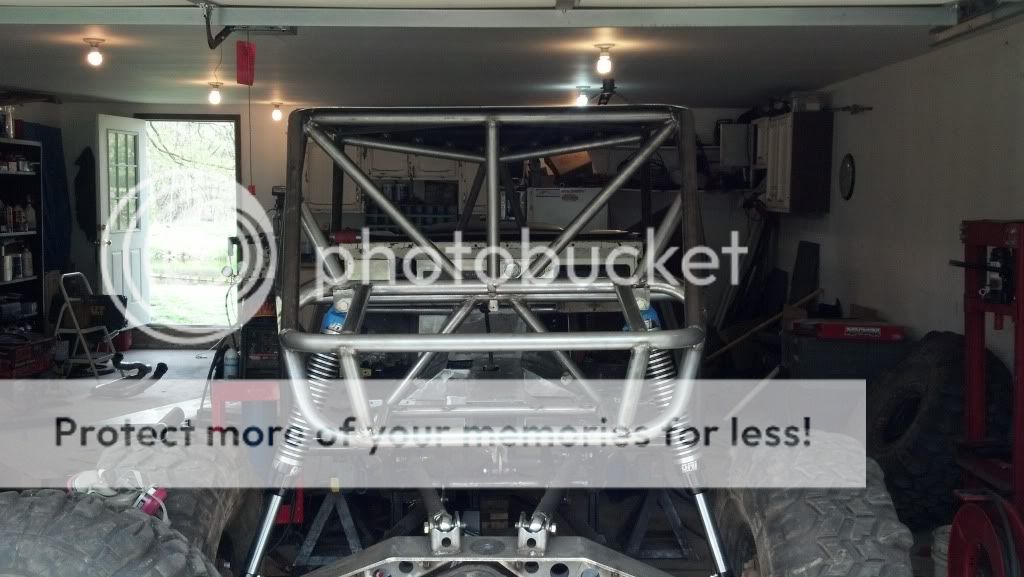

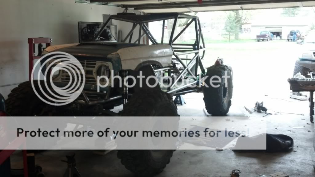

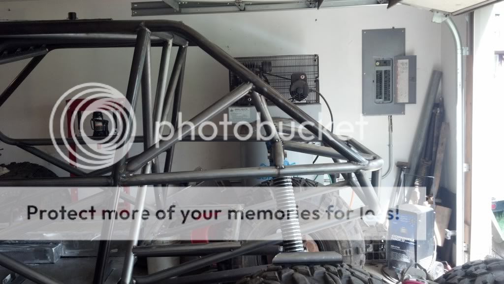

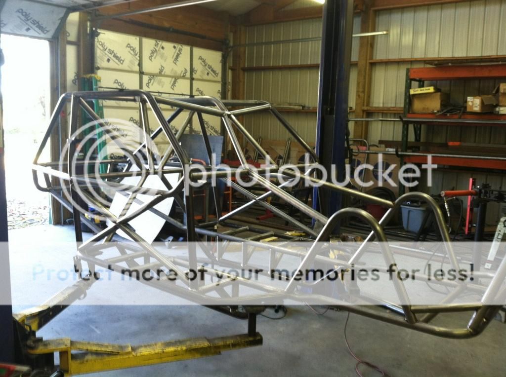

One thing I did notice was the mounting of the front strut (it might be just an optical illusion though). At full droop, they should never be at more than a 90 degree angle. It will be more stable that way. Just a suggestion, but I would outboard that lower mount slightly.
I love the fact that you kept the glove box.

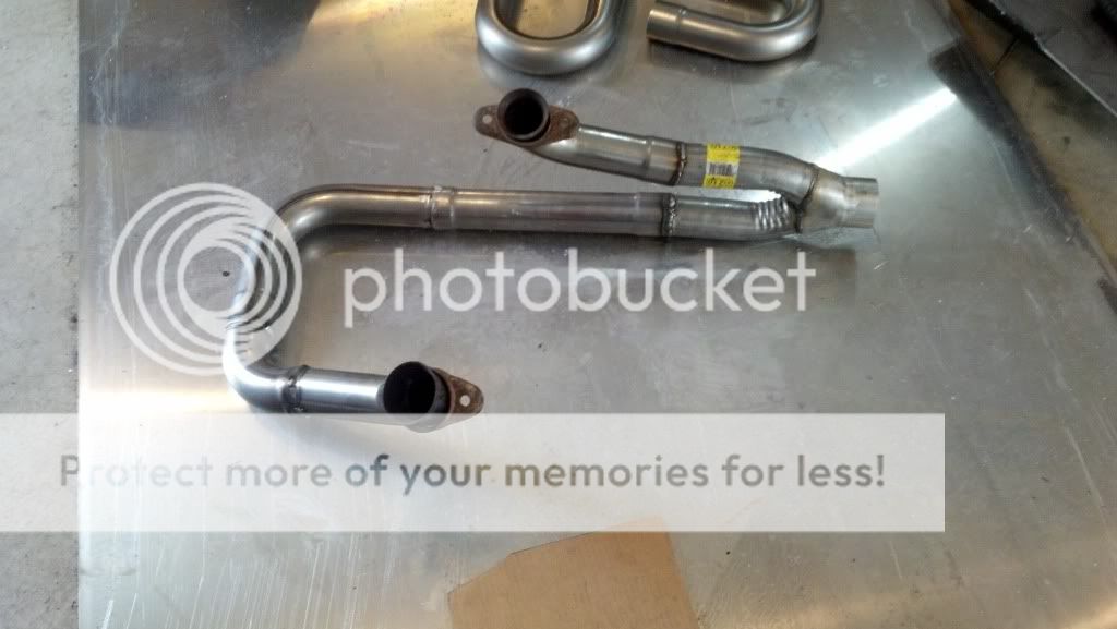

Exhaust ypipe is built. Whats a quieter bullet style muffler? I could fit a flowmaster style but I don't like how close it is to my tcase and trans mount. And I think it would really cook the pass. floor.
1-Ton of fun
Clears the 4 link bars and driveshaft. Gonna use a band style clamp where the drivers pipe goes under the pass pipe so it can be removed in two pieces in the future.

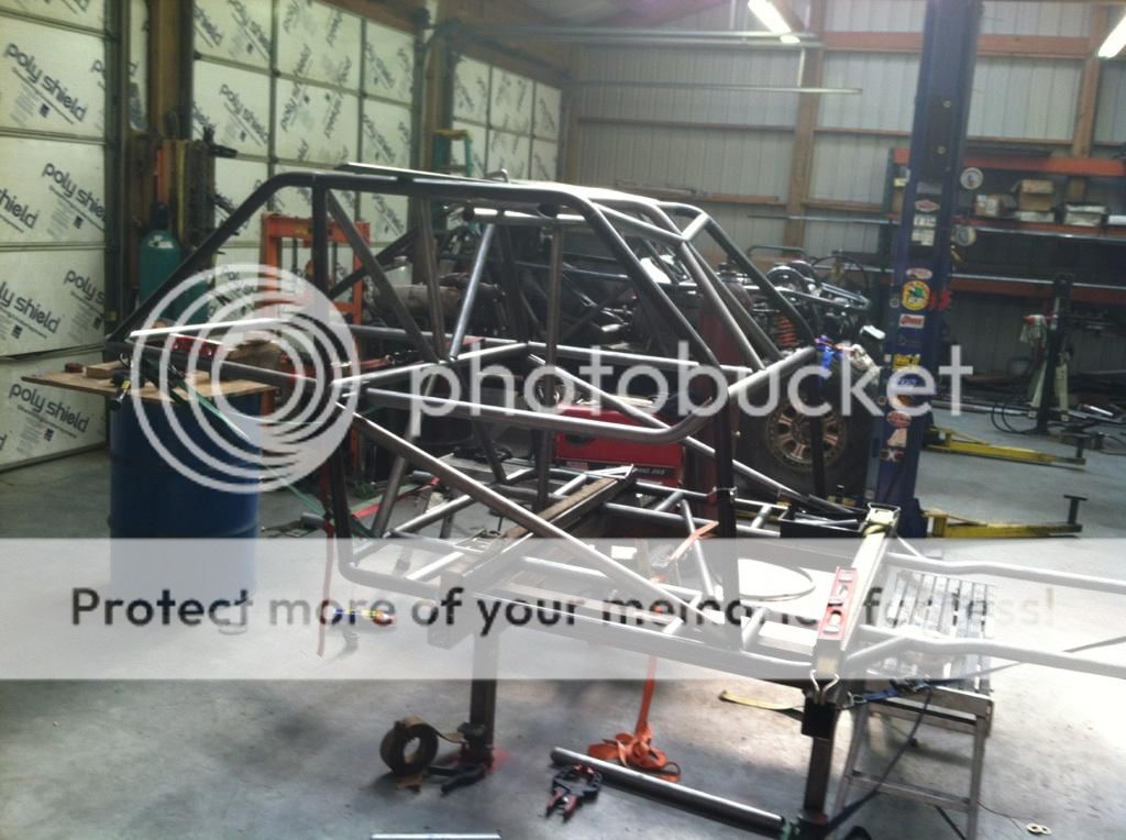

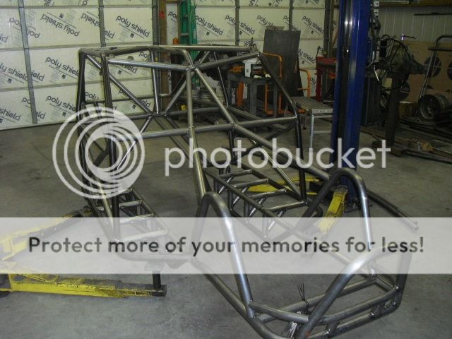

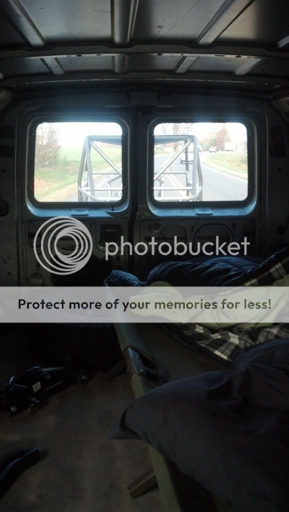

Added some tube in the rear.

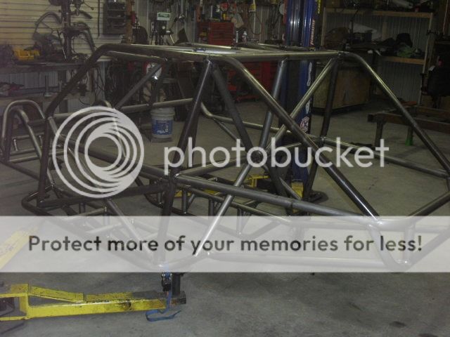

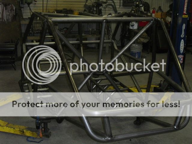

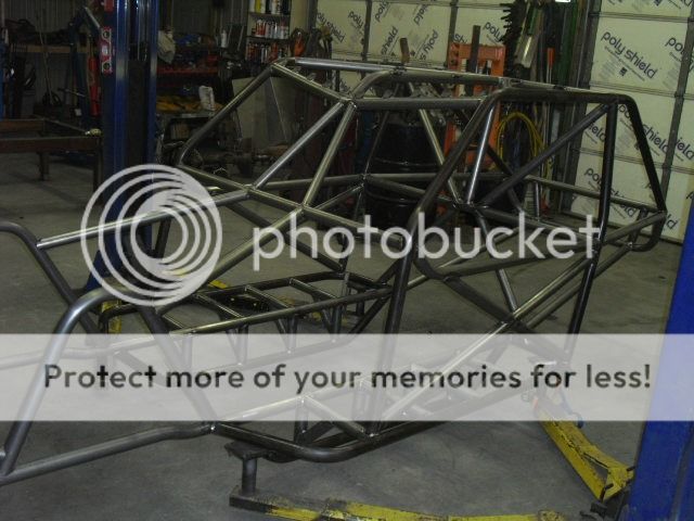

Added some more tube in the front and worked on the sheet metal a little.

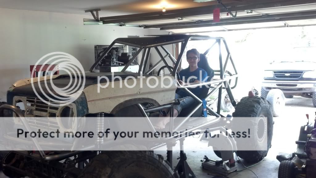

And the wife taking a seat...
