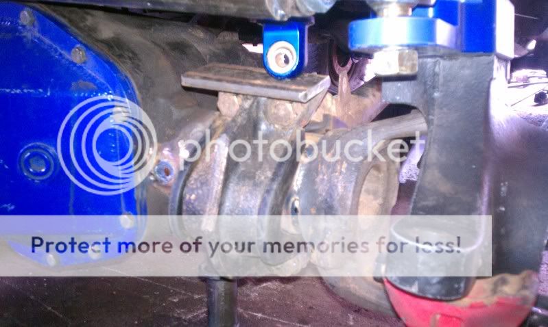

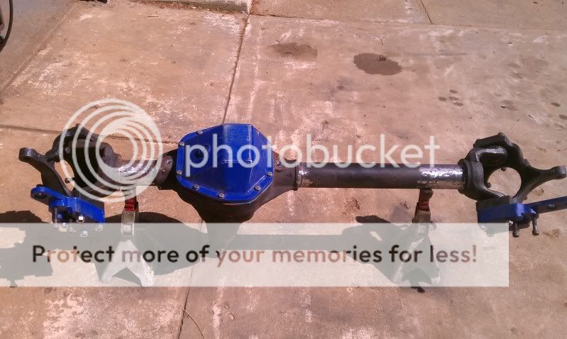

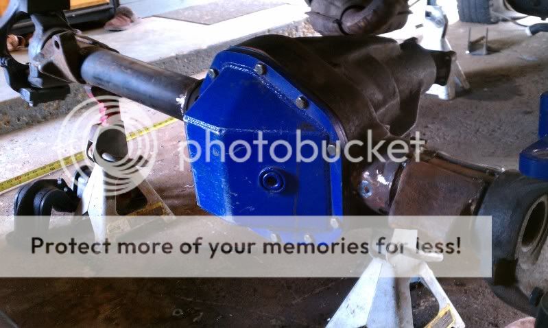

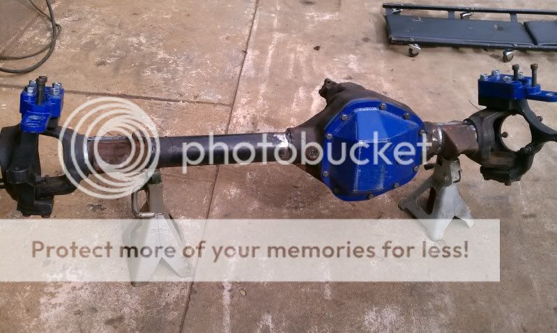

Stripped the front 60 for the new wedges, then welded the tubes to the housing and welded in the plug welds
1 Ton Explorer Sport build
Then put the axle under the truck, mounted the wedges and the arms on, unwelded, positioned everything where I wanted it, then tacked the wedges in place.

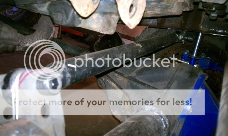

I also made a tie rod

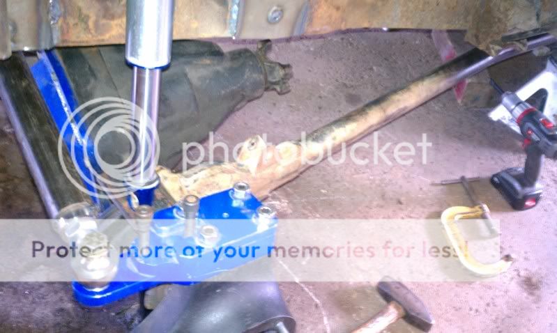

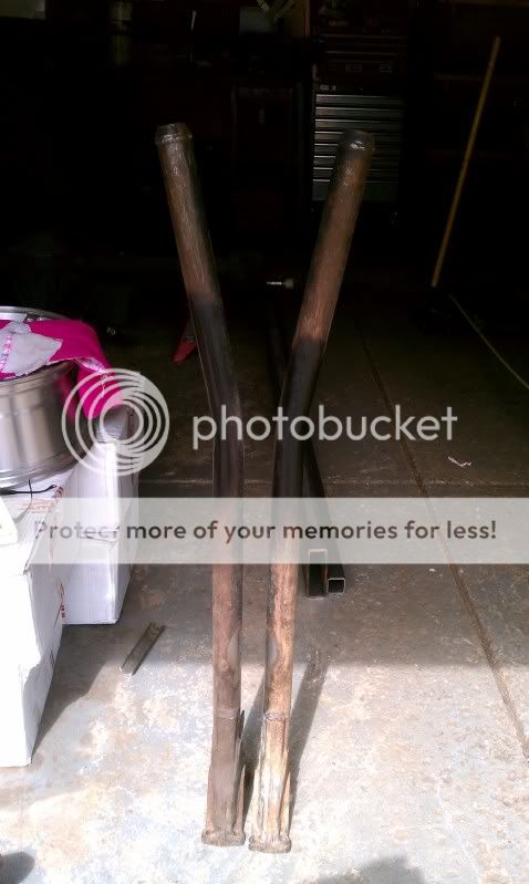

Then I decided that in order for me to use these arms on this frame I either had to shorten them to put them under the frame or bend them, I bent them.
I need them under the frame for a few reasons, like no room for a crossmember, so I can tuck them up higher, and because it make my life easier haha.
I also made the lower shock mounting plates and spacers for the radius arm caps.

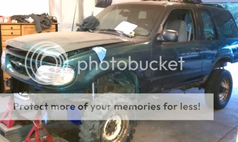

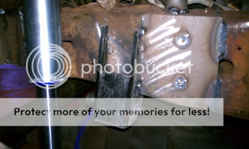

After I made that last update I went back out and welded the wedges on for good

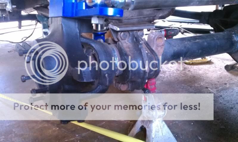

Then put it back under the explorer and bolted the arms on with the shock mount pads.
The arms ate still on the inside edge of the frame but I can deal with that. Just have to gusset it up, we will see. It will be another couple days till I can get out there.

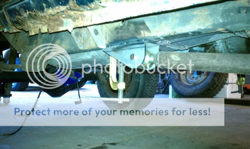

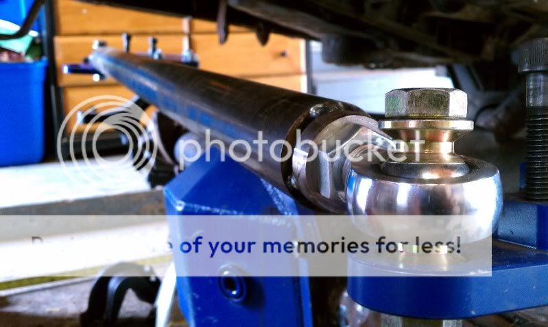

Cut up the track bar brackets to fit the frame and made a track bar, then tacked em all on, might move it all a litte yet

Then I went and put the jonny joints in and centered and squared the axle and mounted the frame side hangers, just tacked for now.

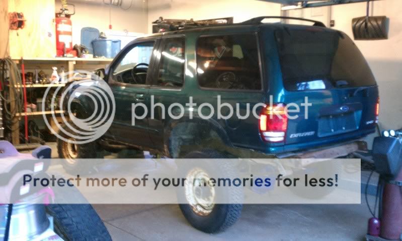

Almost a roller....

Gonna charge the shocks tomorrow and flex it out, do some gusseting and lots of welding....hope to have it sitting on its own weight.
