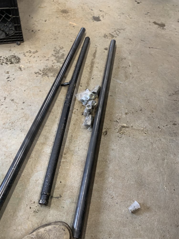

I'm moving along, I don't 100% like how my OTK steering came out. I order some more weld in bungs and Flip it back down to UTK. It would make my drag link to tie rod bar a lot more inline, and i would be able to move my steering stops back to more normal.

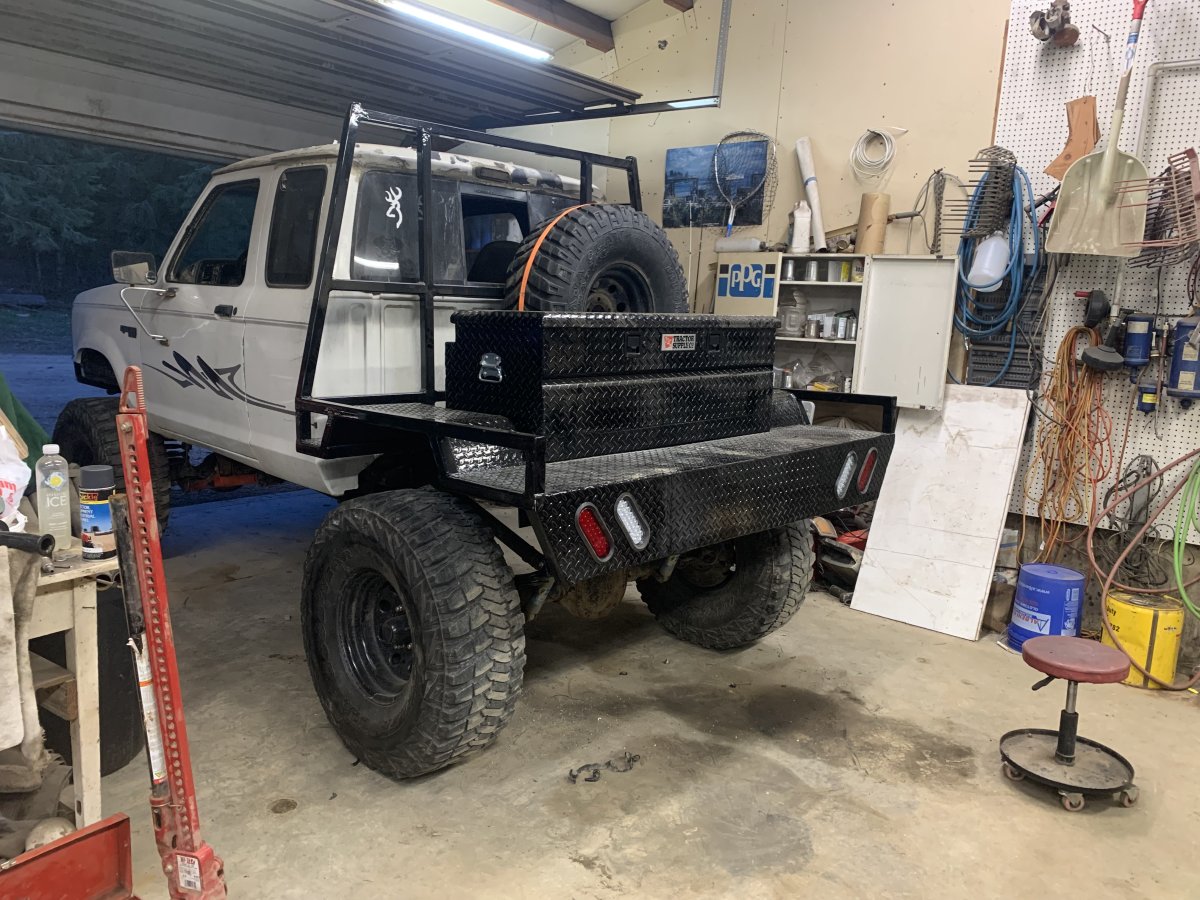

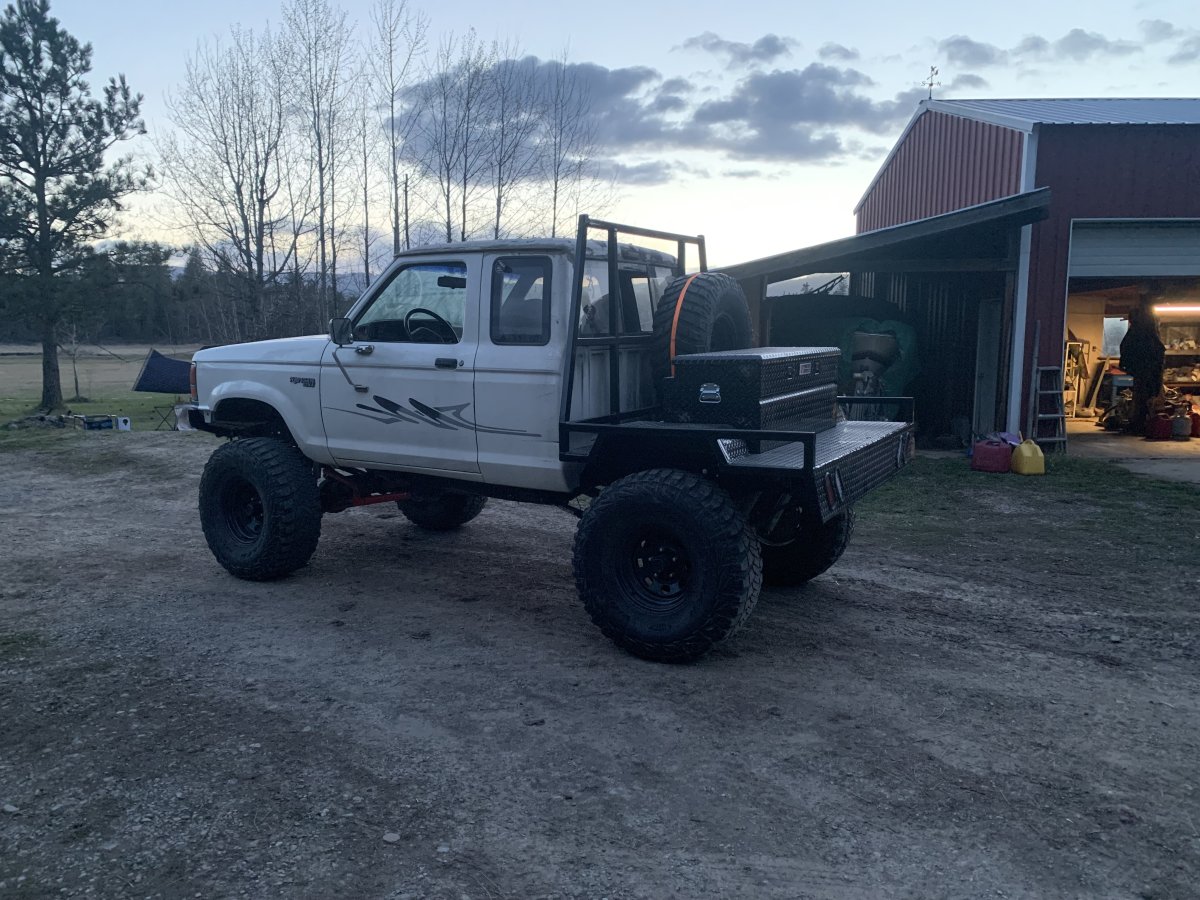

My flat bed is pretty much done, got it back from powder coating and got most of my stuff on it, just a few things to do still.

That short bed looks great.
That is a true short bed. Excellent departure angle. (y)

Thanks guys! Yup bed is 4ft long by 6 ft wide. Haha it’s pretty short! I had to get creative since this cab is on a b2 frame. Fuel cell is in the tool box in the back.
