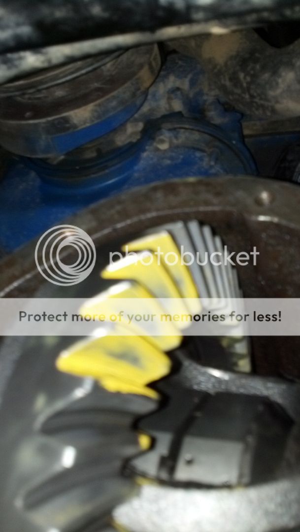

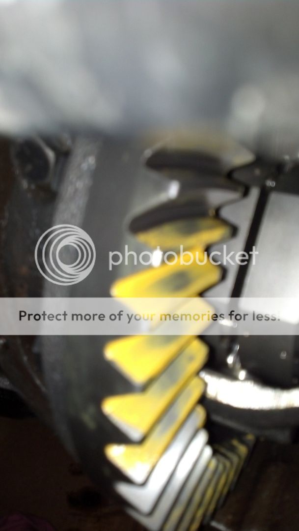

Thanks setting up gears isn't my favorite thing to do but it's not as bad as most people think.
Found out that because 8.8 repair bearings stick out from the axle about 3/16" they wont work with the Grizzly locker. Had to go back to regular bearings and seals so the axle would go in far enough to get the c clips on.
Got the front 5.13's in but the pin broke off on the spindle nut so I ordered some stage 8's.
Pics suck must have been shacking. And rear backlash was 0.012 front was 0.006.
