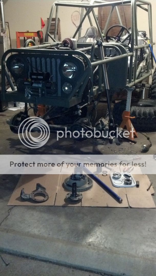

Already working on it. Didn't replace the ball joints during the build because they looked okay but after one wheeling trip the lowers are shot. picked up a set of moog's from Advance and started pulling it apart tonight. Has to be ready for Turkey Bay on Saturday.

Not that lucky when it happened to my buddy Jeremy. We had to pull the trailer back into the woods but first had to get his rig up the hill he was trying to climb when the front end started bouncing and ball joint broke. My lowers had zero grease in them and lots of slop uppers weren't too bad but replaced all 4 with Moog's.

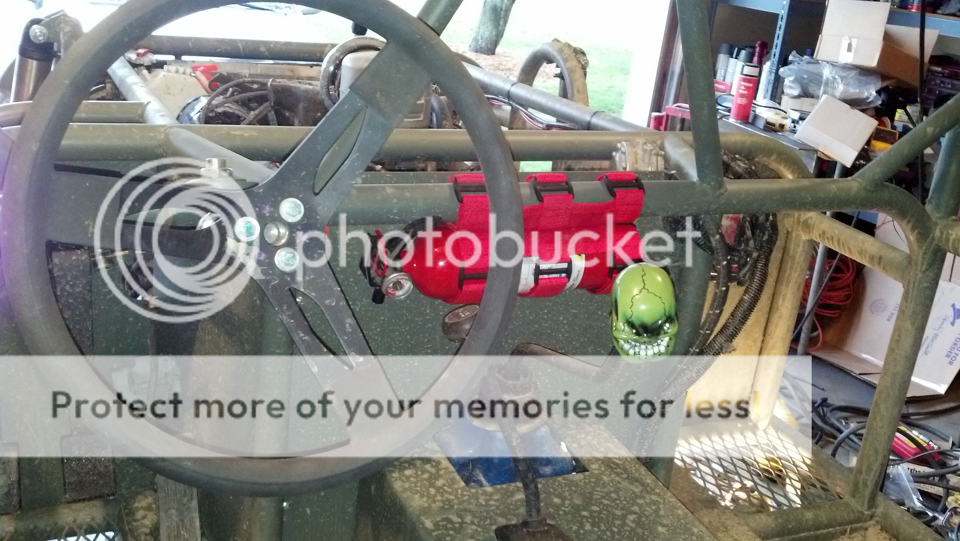

Also got one new 39.5 Irok so now I have a spare. And a fire extinguisher holder.

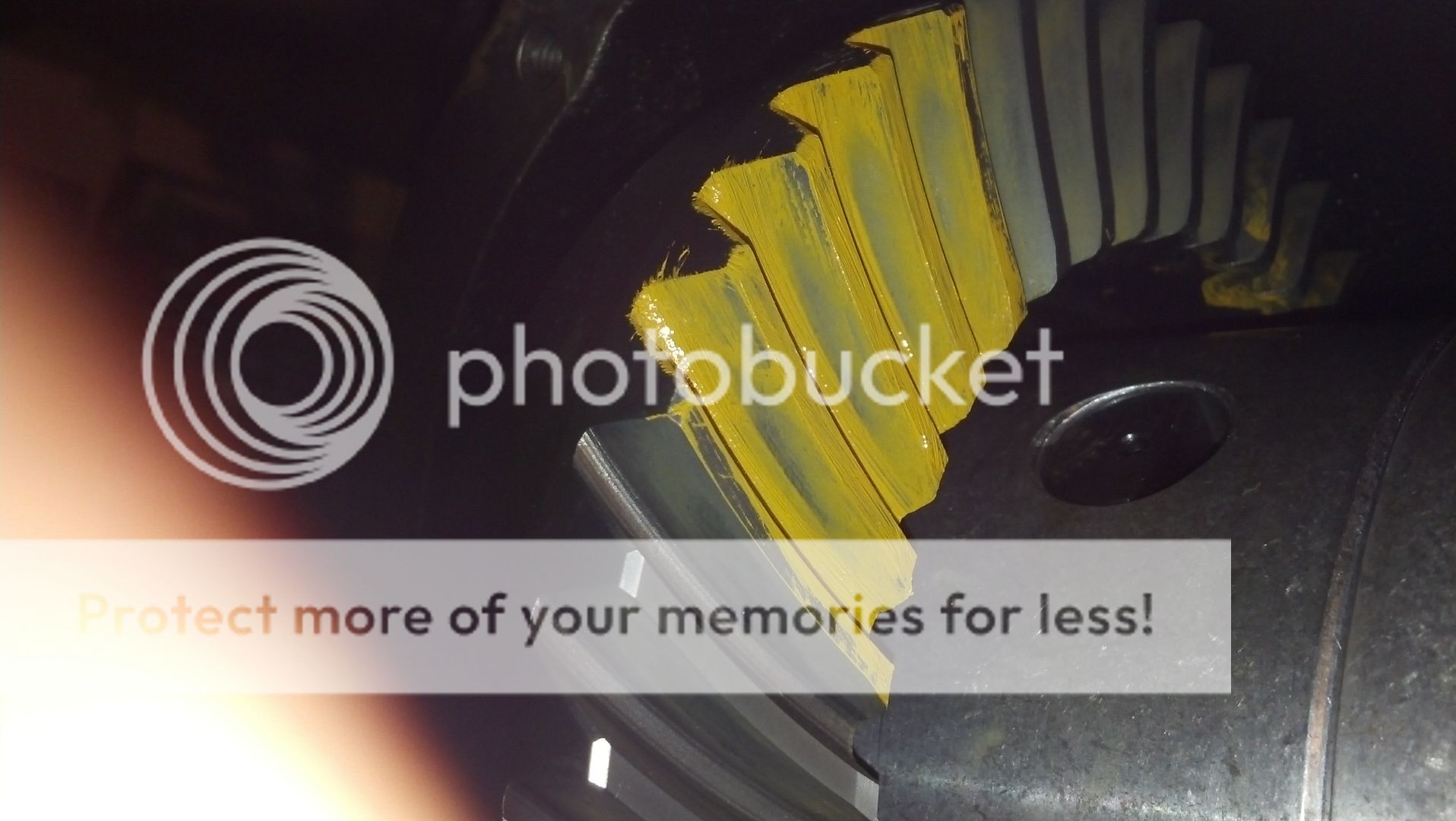

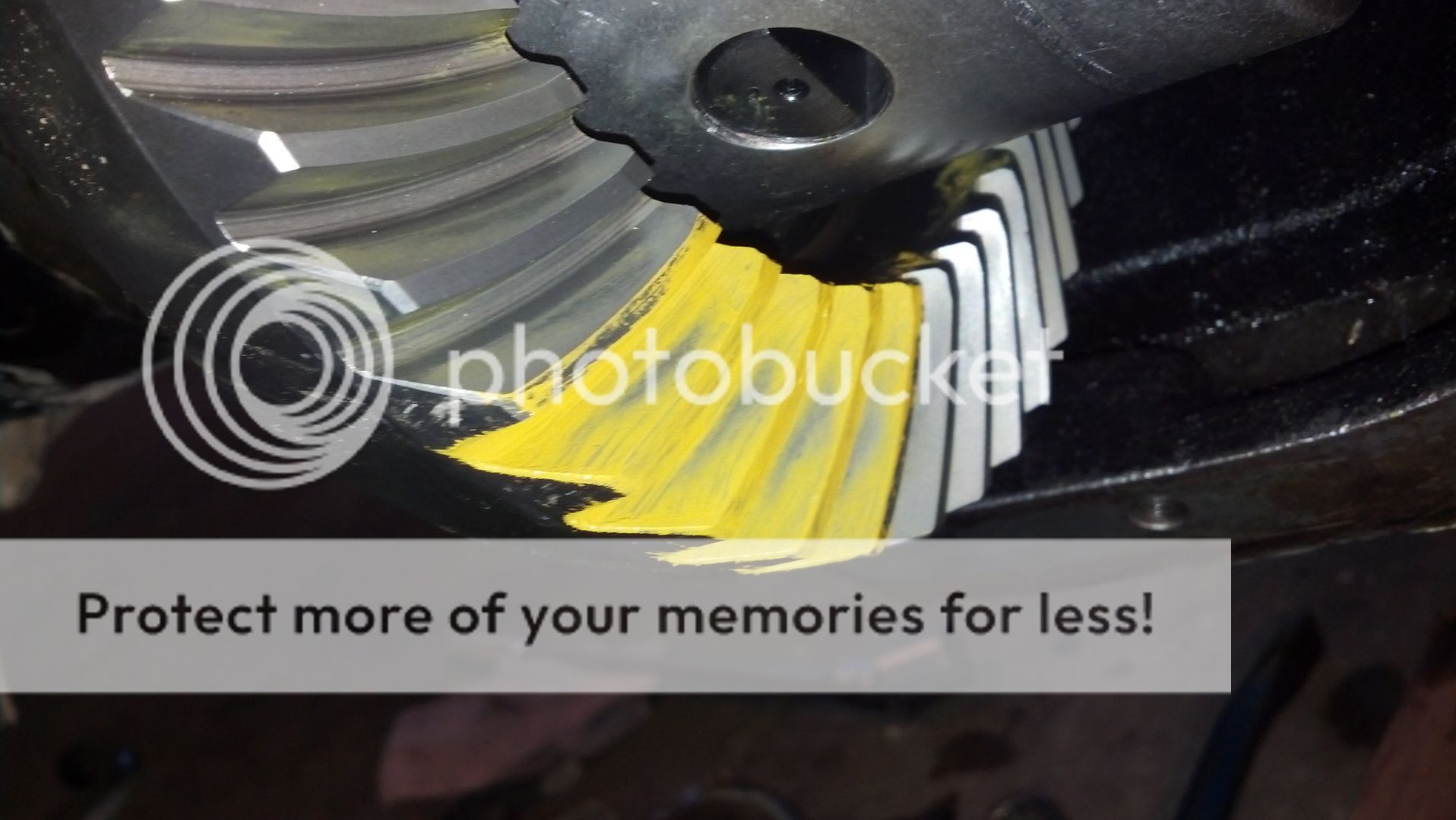

This is the 8.8 final gear pattern. Only took four tries that's pretty good for me.
