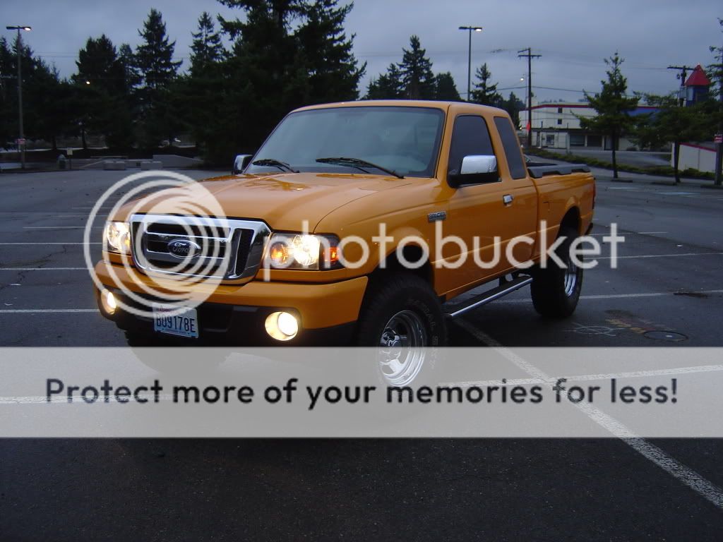

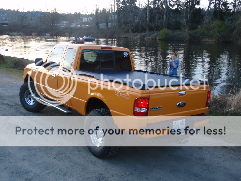

Here's my 2008:
Body lift and slight torsion bar crank:
This is after installing torsion keys off of an '07 or older truck... clocked slightly from the keys that came on the '08 and newer.
