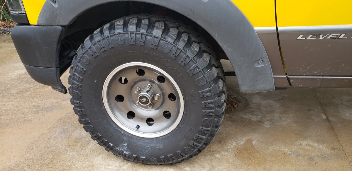

Things are coming along. I re-finished the Alcoas. The outside rim was corroded from tire weights. Ran orbital sander with 240-320 around the problem areas, then some Scotchbrite sponge, 400 & 800 inside before a re-coat of Rustolium "Classic Clear". 3 light, & 1 heavy coat. Got a good gloss going. Should of been satin perhaps??

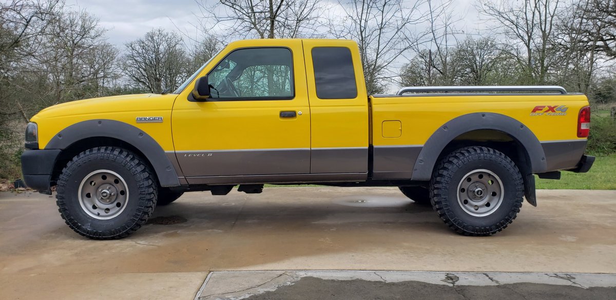

These new meats are Mickey Thompson "Deegan 38" 32x11.50xR15. The other tires were junko chinese rejects. Terrible. Now these honeys can handle on the road, and so far unstoppable in the wet soil & adobe around here. These other tires I had had better than 3/8ths left. Glad there gone. I did get more than a few interested on an online marketplace. So I at least got paid $20 each. So what do you all think? Coilovers coming soon. Will most likely get them ordered this week. Going for a 2 inch lift MAX, Just level it out and get that ride that it should of had from the factory. Otherwise I'd have to build up some bigger (longer) A arms. Bob Fox gets my $$ again. Hi Bob. - Doug
That, good sir, is a b-e-a-utiful truck.
I always like the Alcoa's on the Level II Ranger's. One day when I can find a nice set (and the budget allows) I am going to get the gray ones like that for my truck.
The core support is on my list as well, it seems that all the Rangers will need it replaced at some point or another. If I recall correctly, you can find a replacement one for not a lot of money. Sadly I do not have the welding equipment or experience to work on mine, so I will probably send it out to a body shop that I know that does good work. They will be faster and better than whatever I can do in my driveway.
