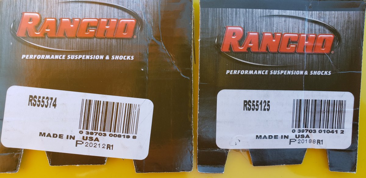

New shocks..........
The fix is in...........
49039
No more stutter bumps making me stutter. The Rancho 5000x did the trick. Almost as good as my '13 F150. The front came up just a hair during driving. No more front end diving. I now know what the throttle does whine turning. Much, much more control at low speeds, during transitions. From stopping to back on the throttle time is much less. Before I guess I was waiting for the suspension to settle down. The part numbers selected had slightly more travel (1/2") then the other 2 sets of the front & rear. All new hardware was included in the front pair.

I am glad the shocks helped. If they were original shocks to the truck, the definitely needed replacment.
In the SPR section, it has 11cc, which denotes the #1 torsion bars in the front, and the C (strongest) rear leaf springs. That is what usually should be on a Ranger FX4, but I know on mine, it came with B torsion bars, and when I upgraded to #1 bars, it got better.
Also, check those rear shocks, the part number is RS55125, which I think may be a little short for your truck. RS55126 may be better for your application. Check on Rancho's website, and you can see the difference between the RS55125 and the RS55126 in compressed and extended length. It's not much, but perhaps it may be enough for the shocks to max out when driving. (If I am wrong, someone else please chime in.)

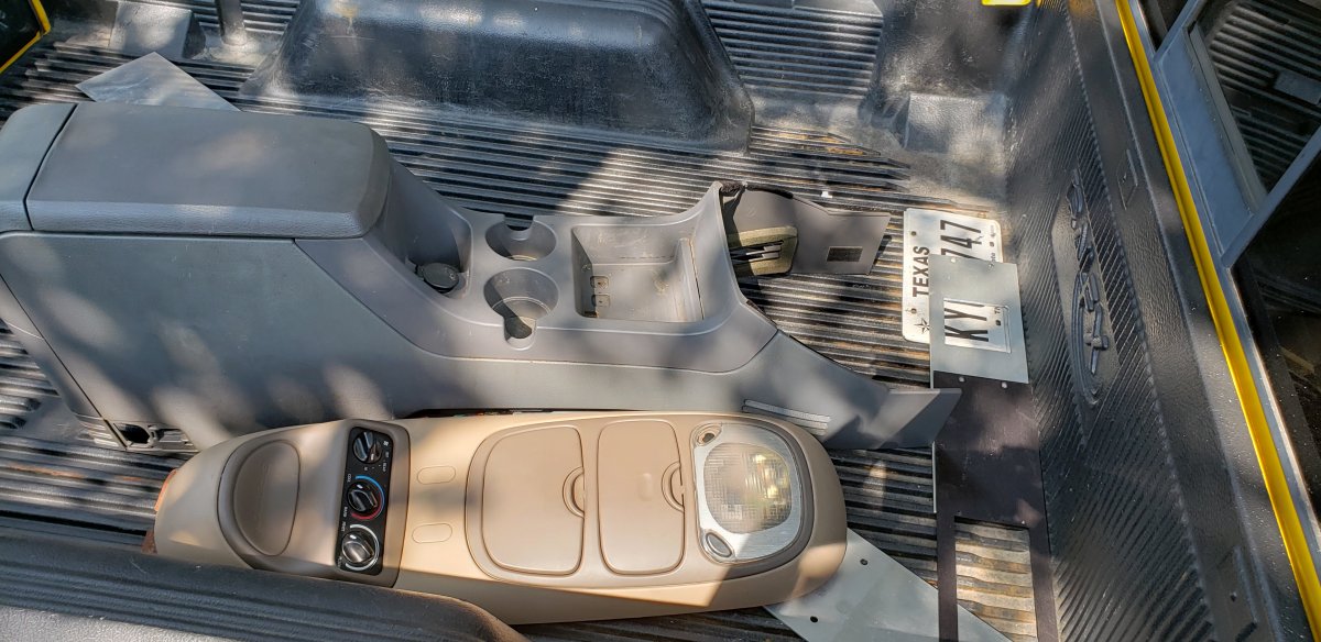

Found an 08 with nice glossy black fender guards. Darned. Anyway, here is what I scrounged from 2 different Explorers. The overhead console will extend all the way back to my existing dome light, came with the well rusted sheetmetal mounting bracket. The installation may require a 1/2 inch of trimming off the flip down visors. The center console will be a nice upgrade. Some trimming may be required. First thing is to clean & sand then find some (Plasticote?) vinyl semigloss or satin colored black rattle can. Could transfer the VAC control up top with some extra wires and open up a nice slot below the radio for a 2-way transceiver.
