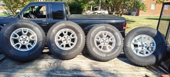

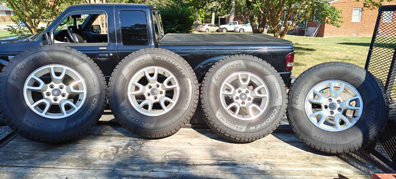

The 265/75/16 Coopers that I ran on my my factory 16's measured out to +/- 32*10.50
The did "fill" the wheel wells better, rubbed a little bit at full lock.

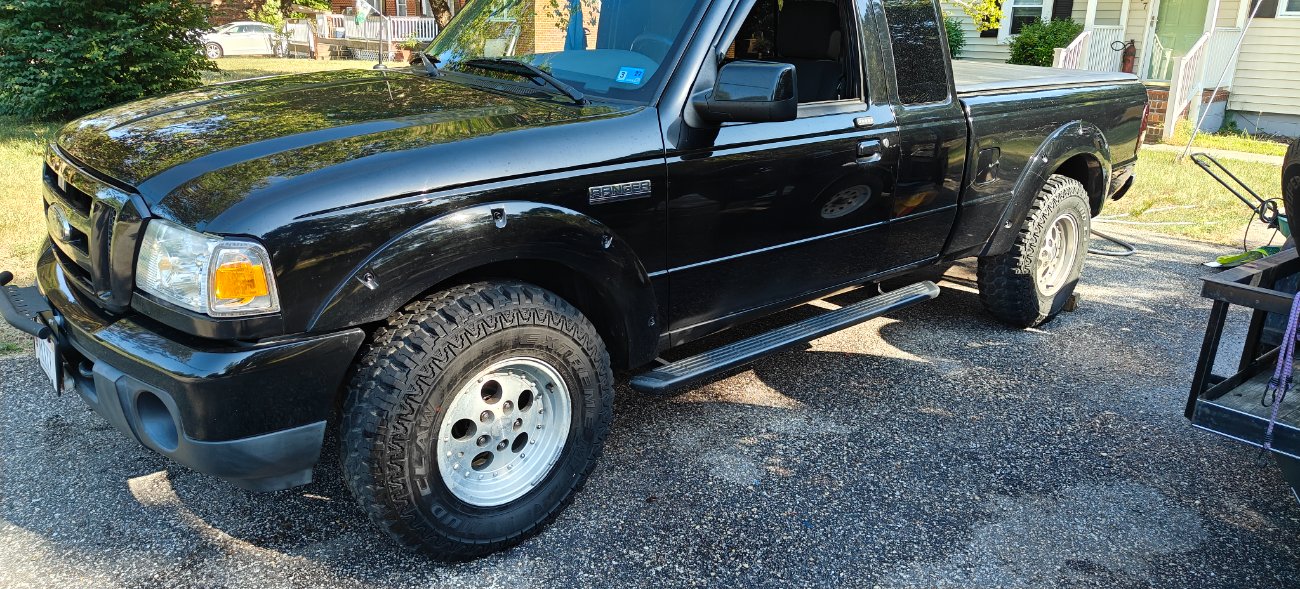

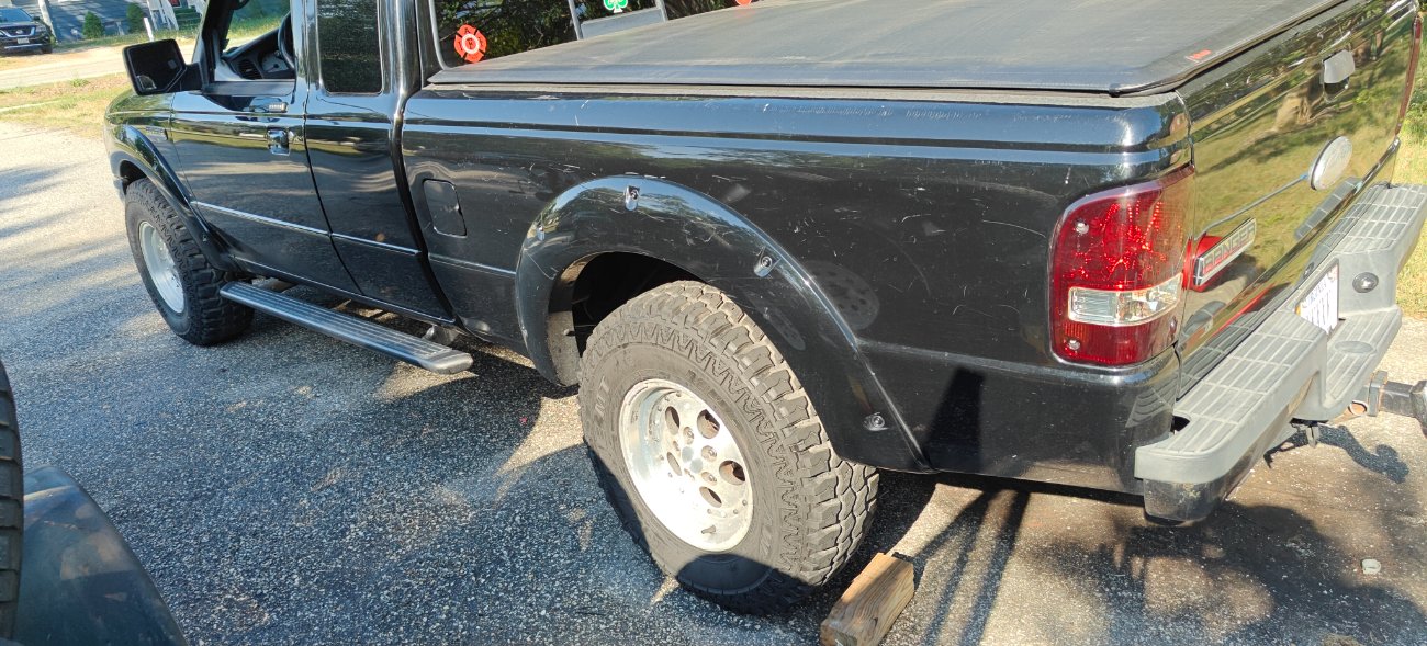

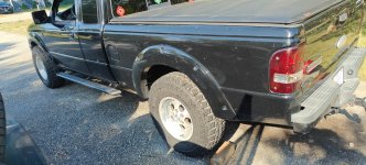

I swapped on 15" Jeep Gambler wheels with some generic 31*10.50 MT's
They DEFINITELY look smaller too!
They make the truck look "smaller" but I suspect some of that is the "Ranger lean" and that it's a 2011 and Ford had lowered it in the name of "fuel economy"
I needed to add 2" spacers (Titan) to make up for the completely different backspacing, the inner lugs rub it tiny bit at full lock, but again I think a little of that is the aggressive tread.

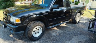

I (for the first time) have actually put a SMALLER tire on a truck that I own. 🤷‍♂️

Those are the OE 16's.
The 31's only clip the inside at full steering lock, but so did the 265's.
