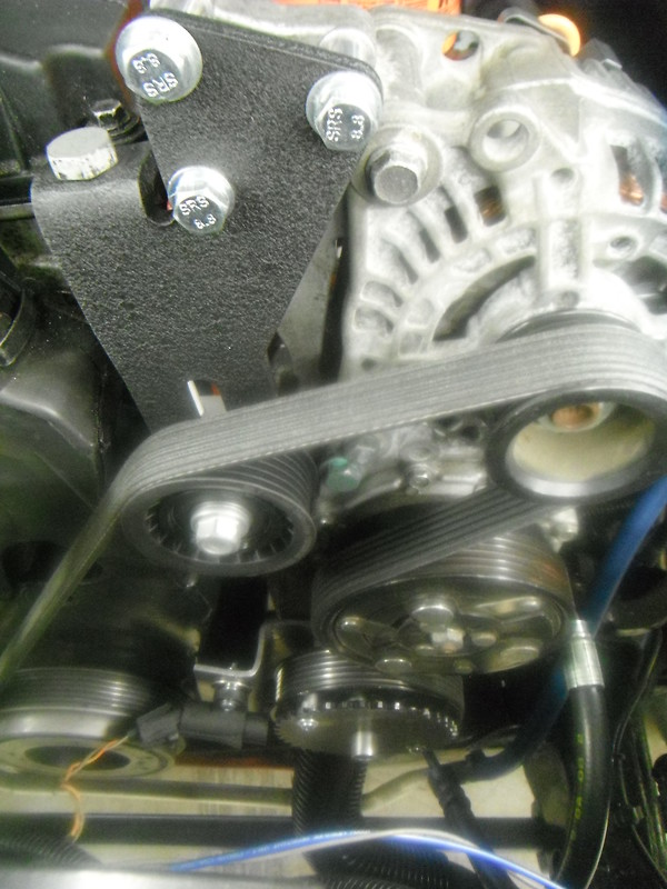

Crank pulley is about 5 5/8" and PS pulley is about 4 5/8. I'll try mounting it on there and see what we get.

The sensor looks very close the the crank pulley but its not, just the angle of the pic.
Darn nice machine work :)

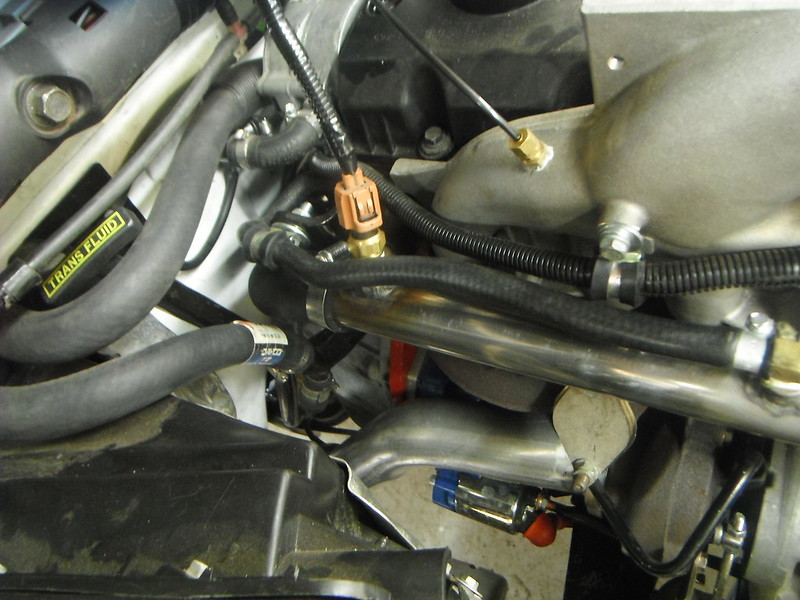

I used the VW ECU output to run the Ranger gauge along with a resistor inline to get the gauge to zero but it's not giving a very accurate reading so I'm welding a bung into the upper return pipe and will stick the stock Ford sender in.

Welded a bung into the upper rad pipe and its all good.

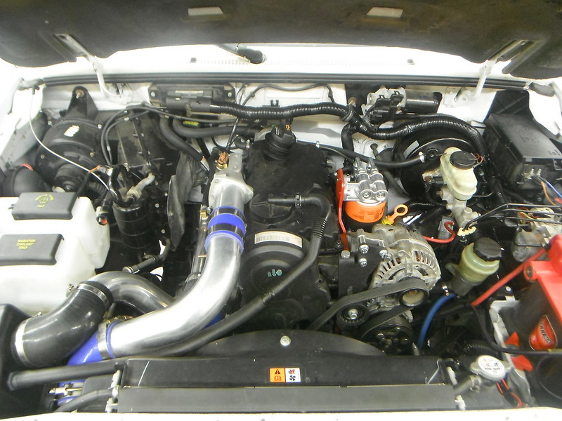

Finally confident enough to loom up the harness and tidy up the engine compartment.
Nice conversion :icon_thumby:
What you have now is truly a Ford "Fusion" :icon_welder:
