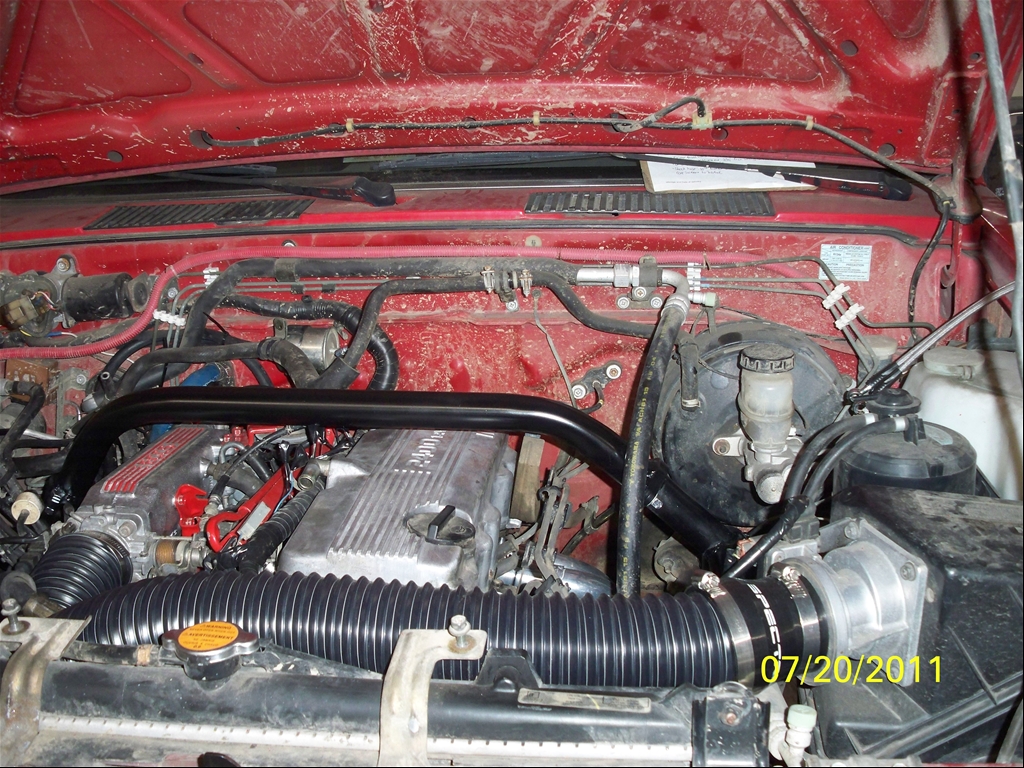

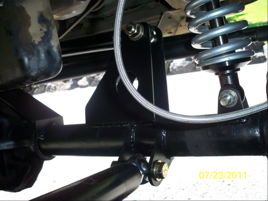

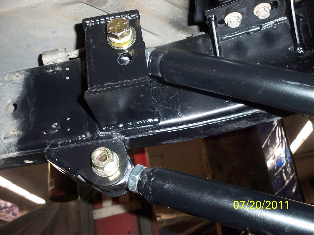

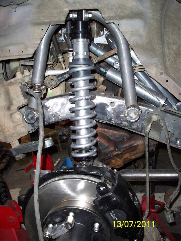

Not totally sure on what all is needed. But you need to remove the complete IFS, its actually fun just time consuming. Here are pictures of my 3-link with a D44 from an EB on my Nissan. Depending you may need to move the steering gear forward. I had to move mine as I move the axle forward an inch so the 35s would not hit the front of the cab. I would suggest a crossover hoop for the front towers as well so you don't crack the frame from flexing.

Thats looks great. Im very impressed. Ill be looking for the best parts while I get a second car going so I can park my ST. Your pics give great ideas.
