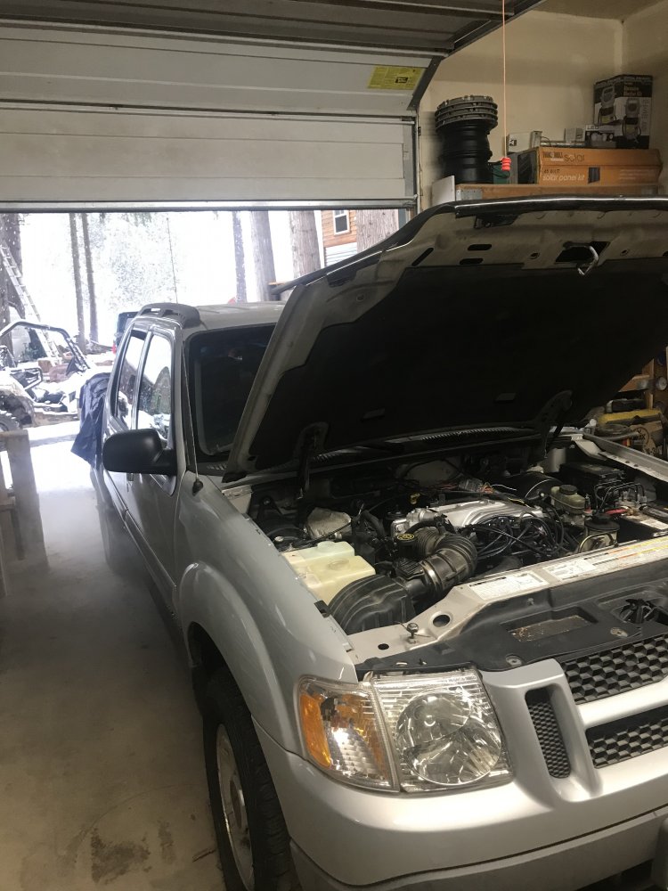

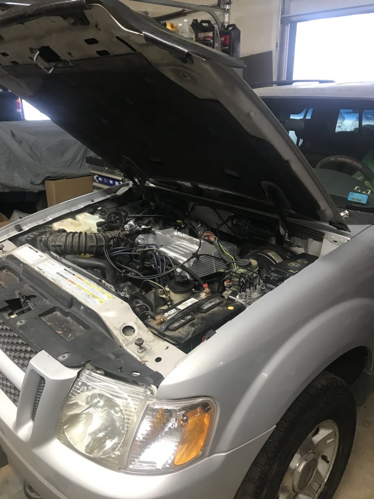

You can use a 5.0 explorer radiator, I’ve personally done it ....
The radiator is a natural fit and no modification is needed except for the removal of the cradle the ac condenser sits in. Aside from that the radiator is bigger and does keep her nice and cool!
When I swapped my 4.0 out in favor of a 5.0 in my 02 sport trac I didn’t want to chance it so I used a 5.0 radiator and it’s nice.
Now I have a v6 sport trac with a 5.0 radiator and a 5.0 sport trac with the same radiator.
I say go for it
