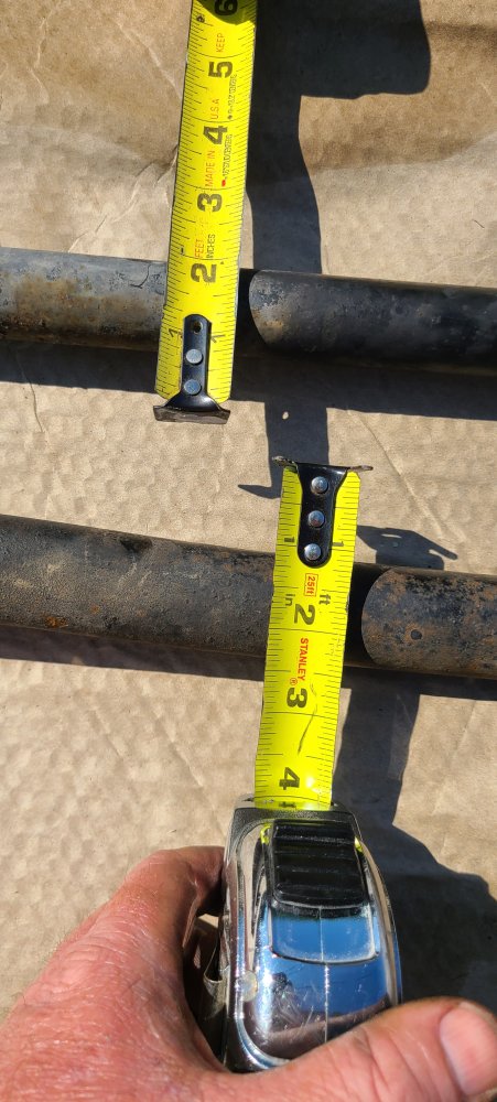

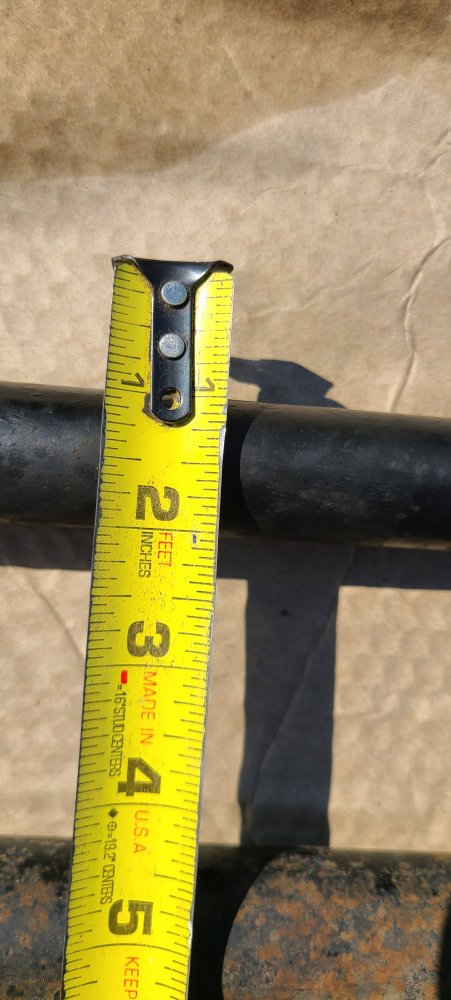

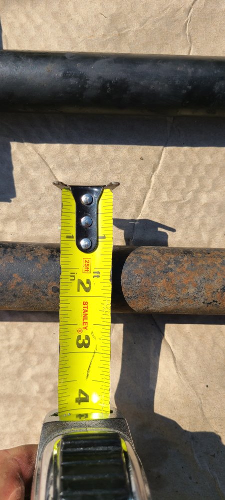

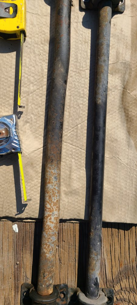

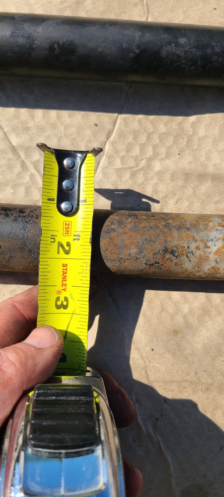

Pulled an 04 mountaineer (explorer) sway bar that was from an awd model so it had torsion bars like my 04 edge. There was only two, an 04 mountaineer and an 04 wxplorer what had torsion bars and both were 4.0 v6 models but still the bar was larger than my stock bar.
Holy cow, what a significant difference in diameter. The difference is 3/8" in size.
Anyway, here is some pics.
There was only 5 pics, i dont know why there are so many attached to the post

How similar are the shapes? Any idea if the Mountaineer bar is solid or hollow?

@JoshT and @stmitch , i grabbed the sway bar from a mountaineer that also had torsion bars so it was very similar. i read that you need to make sure the systems are the same type to use the bars, ie: torsion/torsion or coil/coil. the explorer/mountaineer bar had one extra bend in the middle, like it had to clear something, but other than that, was the same shape so it went on very easily. neither bar is hollow though. both sway bars have some weight to them and the explorer/mountaineer bar could easily be used to bludgeon zombies, if one needed something like that

the 2001 Sport Track and 2000 Ranger 4x4 are identical in shape/mounting.
judging by it's weight it is solid.
the coil bars are a couple inches wider to clear the frame bulges for the springs.
