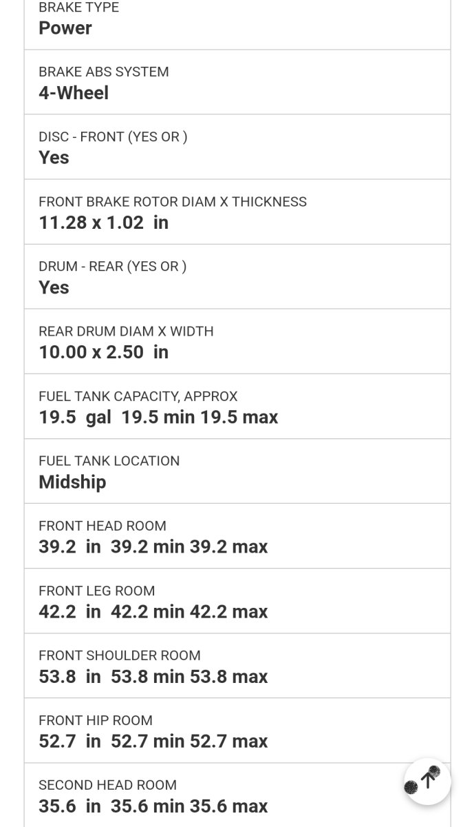

New to RWD Rangers and my brakes need some help. Im well versed with the rear 10" drums, so all good there. My question is, my truck has 101k, pretty sure the rotors are original. What all do I replace on the new rotors, such as outer bearing, inner bearing and race, etc???? Its all confusing to me. Napa told me $22 to turn each rotor, but I don't know if I have to remove all the bearings or what, so I need to call them again. If I buy new rotors, what else do I need as far as bearings, etc? Anyone sell an all in one replacement rotor ready to install? Here is my front rotor specs:

Make sure they measure them and look them up in the book. You can only take so much off of them before they are below spec.
Brakes are just energy changers. They change the energy of motion to heat. If they turn them too thin then they can't absorb as much heat and they don't work as good as they should. If they are not warped, it should work out ok.
Pretty sure there were 2 different rotor diameters for 2wd trucks starting in 01. Make sure that you measure yours before getting to far into the project.
The difference in diameter is also reflected in caliper brackets and spindle/knuckles too.
According to the VIN decoder, I have the 285mm rotors vs the 260mm.
