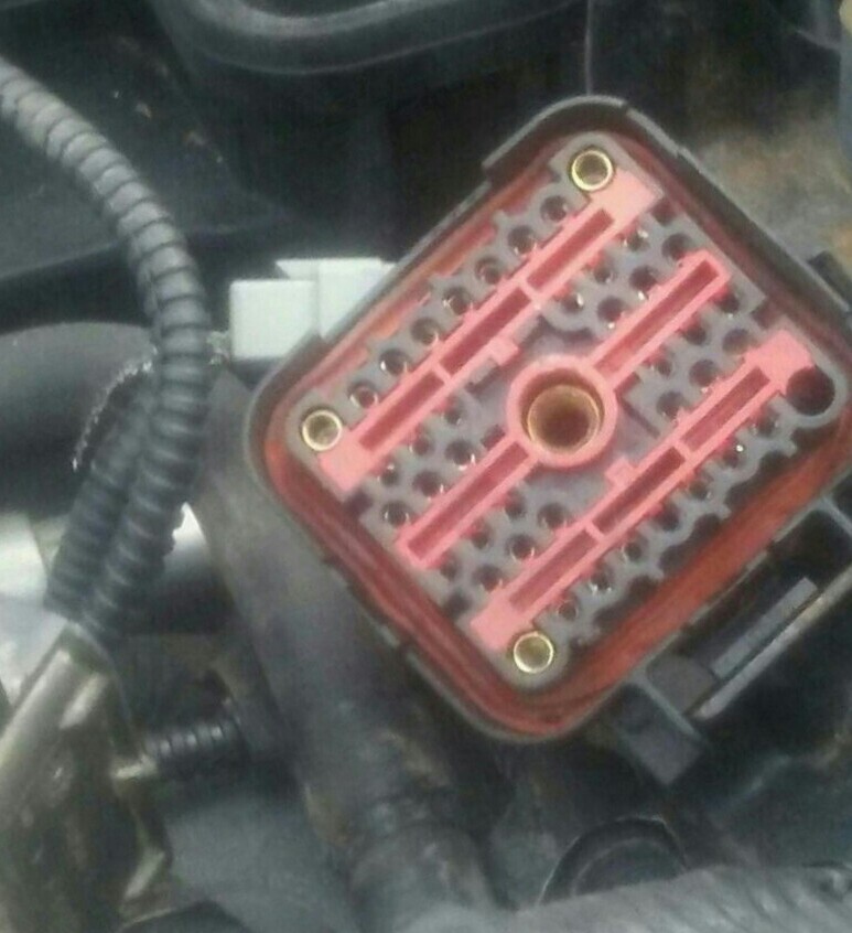

Well there are 2 plugs for the steering column change over that don't match shape and writing colour wise.. One s a 4 write plug..the other had several...but today i just dropped the 4.0 in and am. taking a break from bolting up trans and converter... Both are lined up, just have to finish installing anal the bolts...good progress seeing as its first 90 degree day of the year and I'm outside my garage..in gravel....
attachment.php
Having issues with plugs..big is for to body drivers looks like the old 3.0 factory will into n new 2001 4.0.....the inside on lefty side for i need o figure out how properly writing gether..i went and the plug the donor2001 ranger i. Got column ecm out of....HELP?!!!!there's some plugs this all i could take pics of and resize for posting this morning...thanks again...
The bottom 2 peice gray plug is a match except for 4 wires on the factory 3.0 side and 2 wires the 2001 4.0 ranger donor climb..both trucks are xlt flairside models, just different years...i looked art the old 3.0 99 column and the flasher iss hanging there..matched the wires to the 99 flasher and harness and 4 ways and turns now work properly...
Going thru the big square plug on the left rear valve. ( picture above) and only have 4 pins that aren't match..but i should hopefully have the last pages of info for getting them arranged tomorow...so maybe get lucky and try power up the motor this weekend...calling for bad weather so we'll see...
