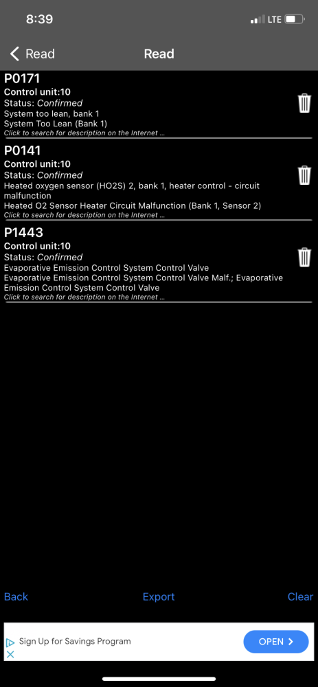

Welp turns out I have a dead oxygen sensor
